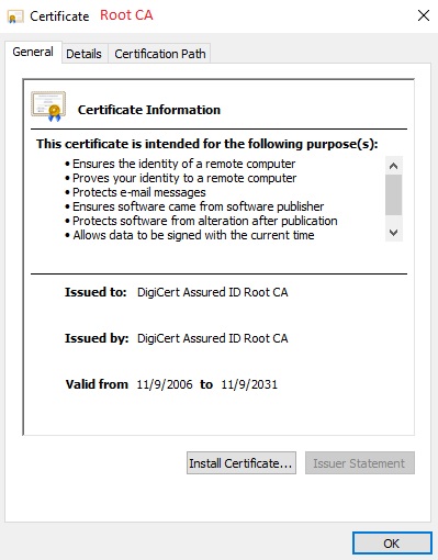

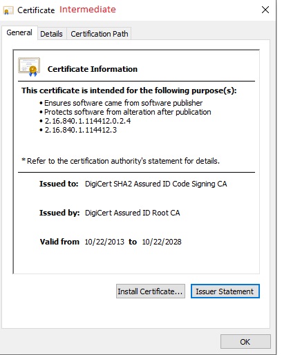

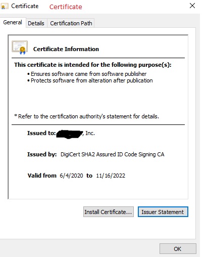

After creating the CSR and working with DigiCert I have 3 files in "C:\cc3235sf\certs_pem (certificate, intermediate certificate, and root certificate).  So now I am able to use Uniflash command line tools:

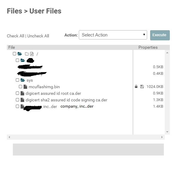

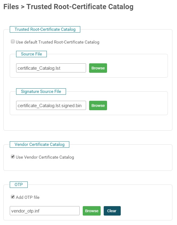

I then specify the files generated in Uniflash:

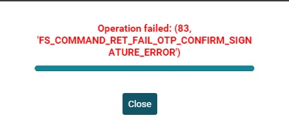

Upon programming, this error appears:
Is there anything obvious I am doing wrong?  Any suggestions?
Ben
    I can't open the photos you've added, please try to add jpg file format.
    The C:\cc3235sf\certs_der\ folder should only contain root CA certificates (which makes your certificate catalog).
    You certificate and any intermediate certificate should be added as user files as used with the TI certificate catalog.

    Error is still persisting.  Note, certificate is "Issued To" "Company, Inc."; could name the file "Company, Inc..der" be part of the issue?
  • Hi Ben,
    The OTP verification does not work with a certificate chain.
    Once you created the key pair, you should use the public key (through the CSR) to create a self signed certificate and store it on the OTP.
    If you've already signed you certificate through a known CA (such as digicert) that is supported by TI cert catalog - you may not need the use the vendor catalog at all.
    Br,
    Kobi
  • Hi Kobi,
    This resolved that issue, thank you.  Have another issue, but it does not pertain to this thread so I'll begin another one.
