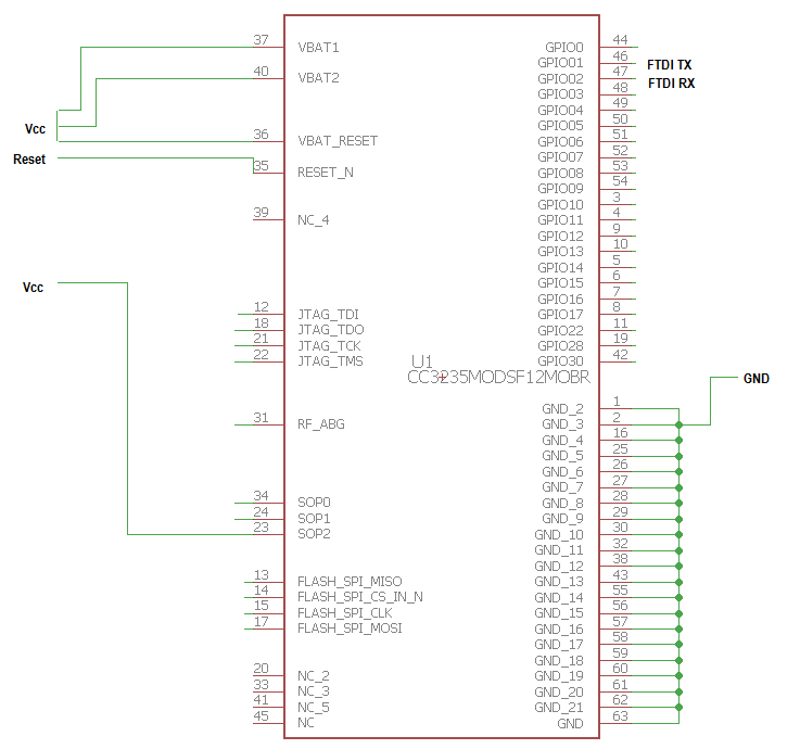

I have removed the all the jumpers from CC3235MODSF LaunchPad and then I programmed the cc3235 module by connecting the FTDI programmer.
FTDI RX -> CC3235MODSF TX
FTDI TX -> CC3235MODSF RX
SOP2 -> Pull up
I have programmed successfully using the uniflash. while programming I have selected CC3235MODSF Serial.
Then I have design the custom board. I have attached the schematic file below. I have connected the FTDI (USB to Serial converter). but this time uniflash throws the error. I am not able to program. It seems like the the module did not send any ACK signal to uniflash.
Is there anything I missed? I bought the Module from DigiKey. Does the chip loaded with serial boot loader?
Please help me to resolve this issue.

Sundaresan,
On your schematic, GPIO1 (UART_TX) is connected to FTDI_TX and GPIO2 (UART_RX) is connected to FTDI_RX. Is this correct?
BR,
Seong
Hi Seong,
Thanks for the help. It is my fault. Let me correct circuit today and update you ASAP
