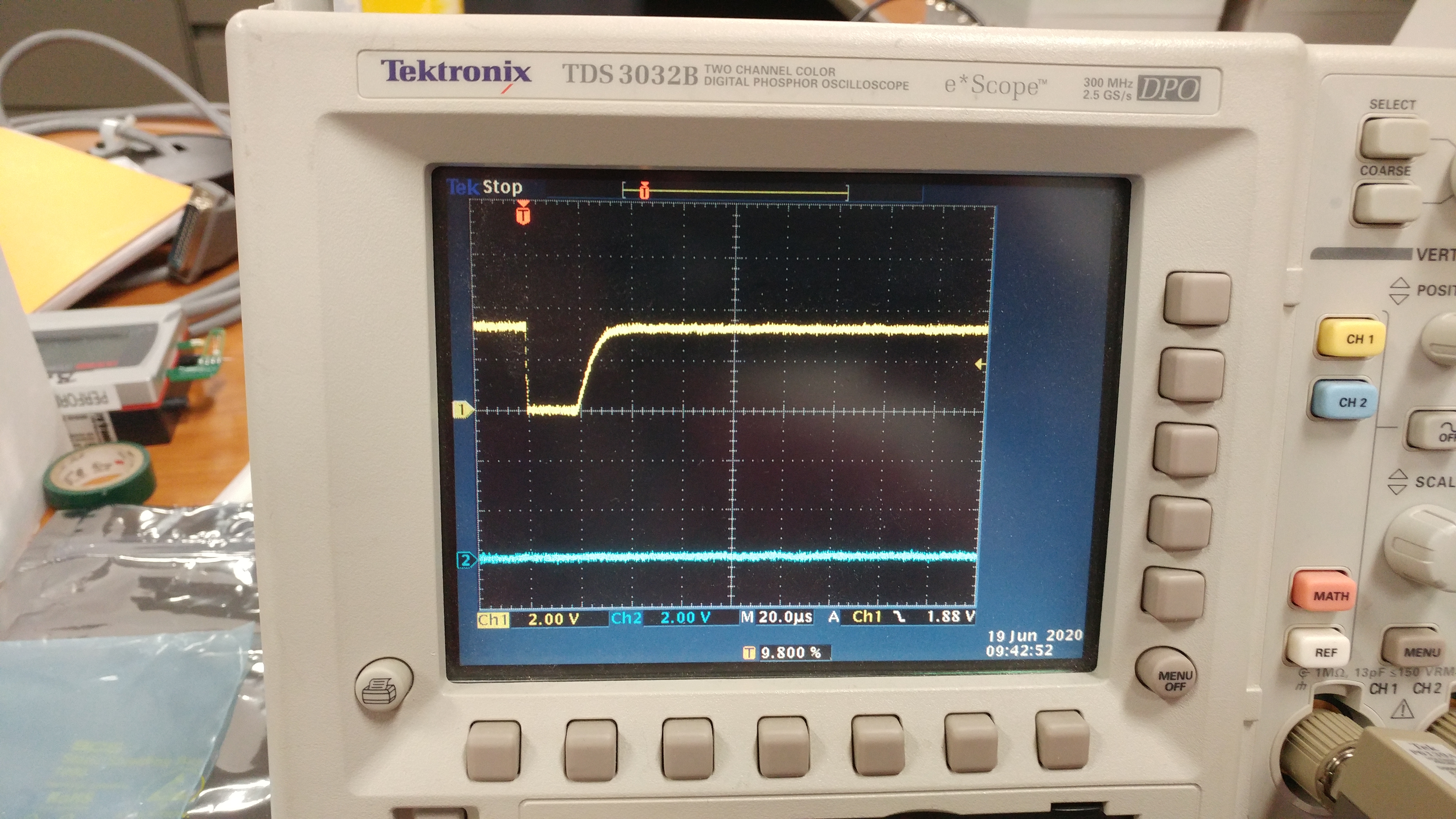

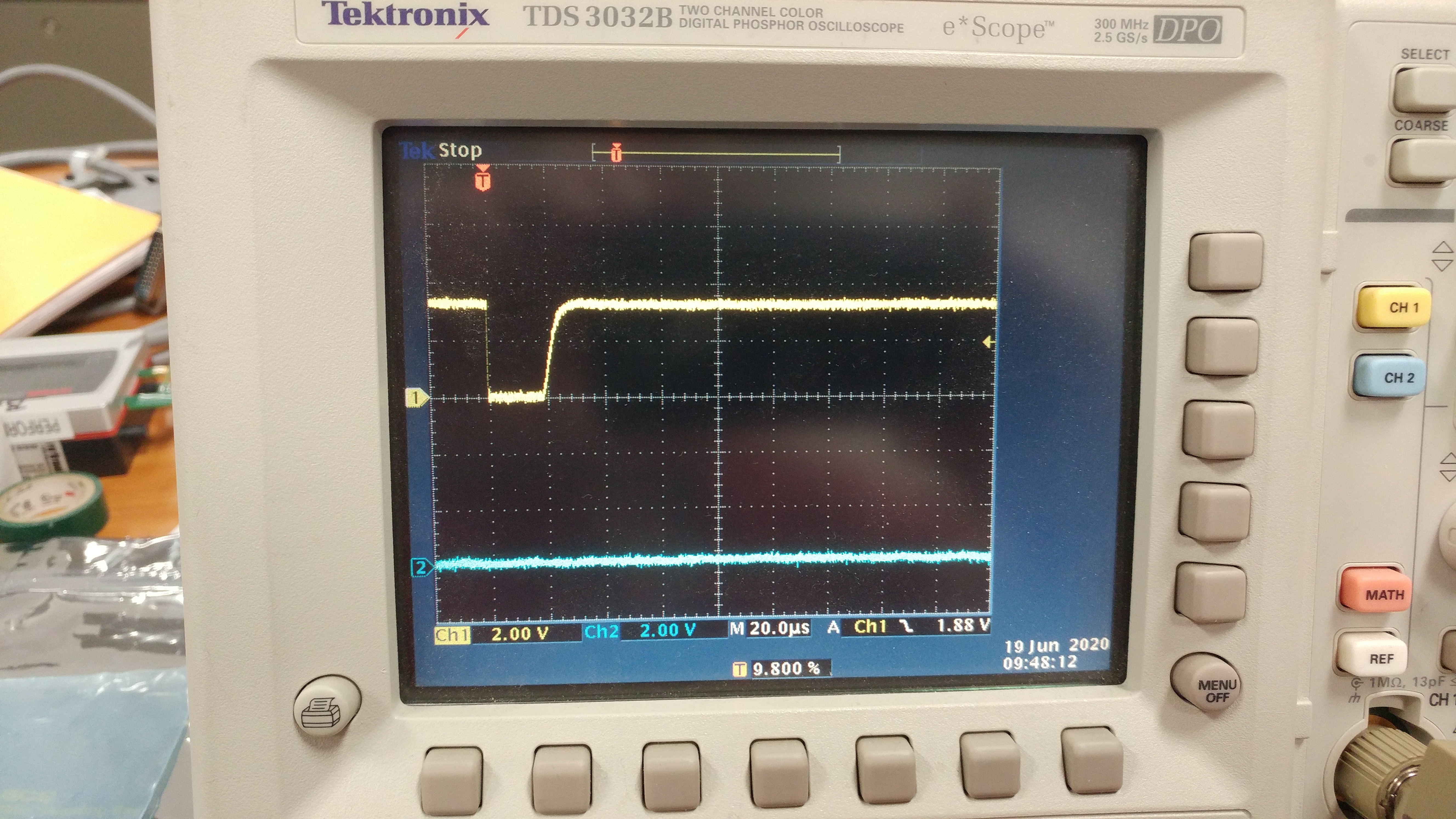

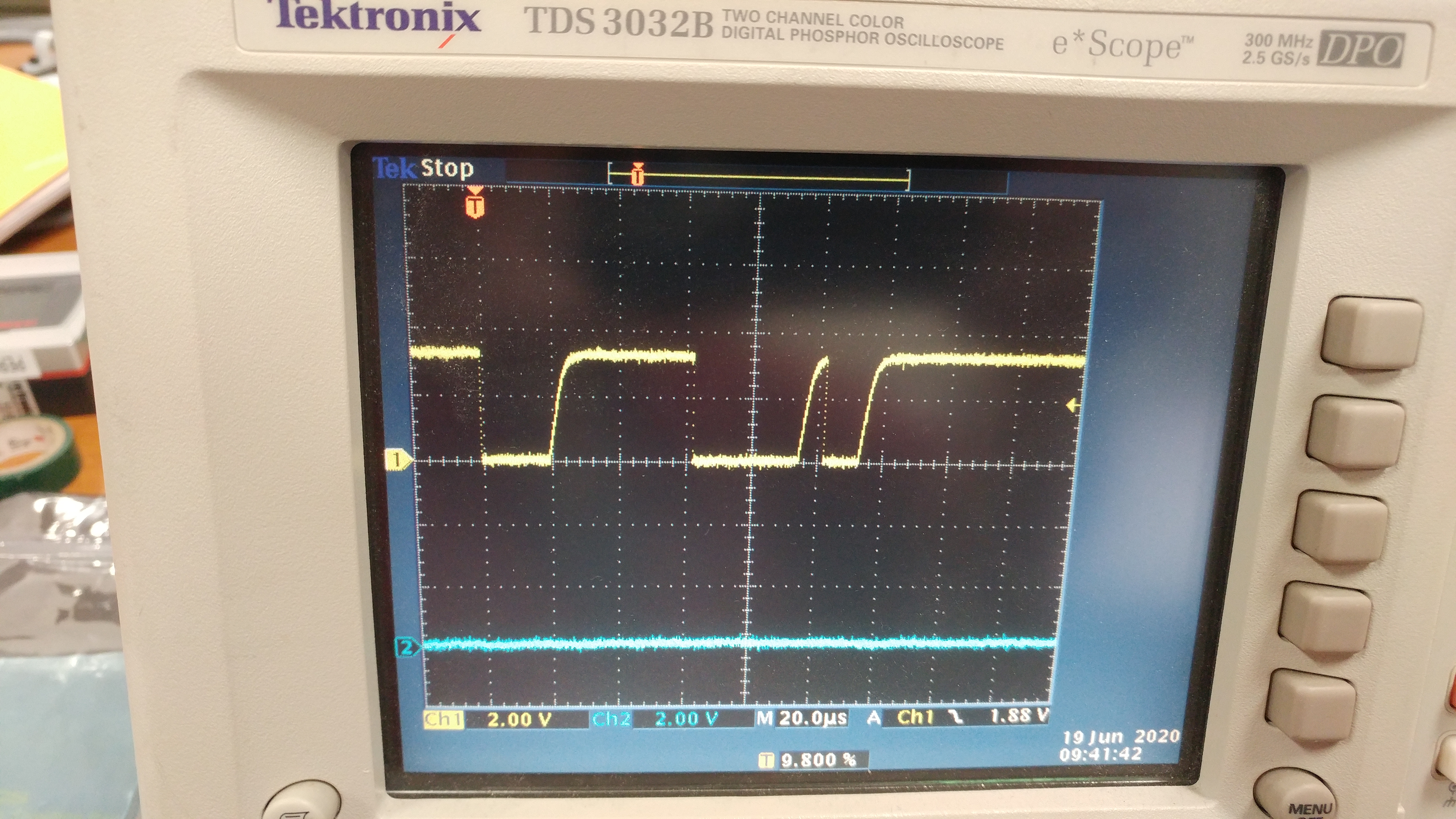

  • Update.  I compiled the i2ctmp006_CC3200_LAUNCHXL_TI_CC3200 example to send a signal command to the display on the I2C bus.  The display and the pull up resistors have been removed from GIO14 & 15 to make the conditions on all pins the same, making the return to the 3.3V state slowed.
    I tested the GPIO10 & 11 (Launchpad pair), GPIO14 & 15 (Desired pair) and the TDI, TDO pair.  I could not test the GPIO12 & 13 pair, because GPIO13 is used in the design as an input and to isolate it would require removal of half a dozen components.
    What I saw on the scope is the following.  The SCL (clock) single is present on all 3 pairs tested.
    The SDA (data) single on GPIO11 shows the start pulse and the command bit + device address pattern, but the data byte is not sent, I assume because the device did not ACK after the address byte.
    GPIO15 & the TDO pins show the start pulse ONLY, no address byte is seem.  I've attached the SDA scope traces.  pin_02 = GPIO11, pin_06 = GPIO15, pin_17 = TDO.  GPIO15 exhibited the same with the display and pulls in place.
    Pin_02
    Pin_06
    Pin_17
    Late Friday further update:  I hand modified the board to use the module's GPIO10 & 11 for the I2C port, as the Launchpad does, and was able to successfully communicate and control the display.  I can modify the design to use these pins, but I would still like to know why the the other pin pairs don't work.  For layout reasons I would like to save GPIO10 & 11 for future SDCARD expansion.
