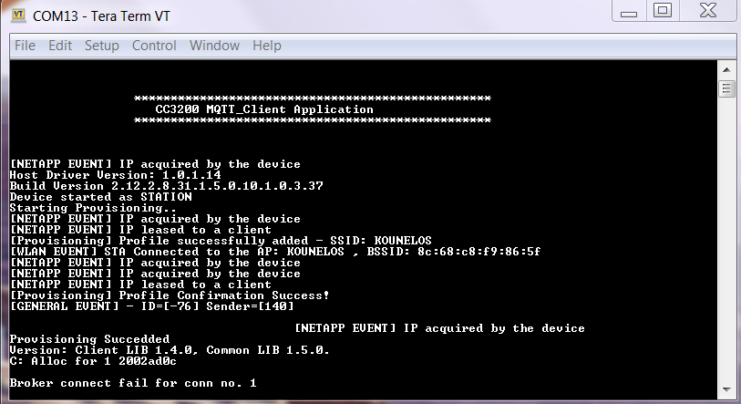

  • I have the latest SDK(1.5) and the latest service pack flashed (seen in the terraterm above). Even installed them with new CCS version.
    Yes its the MQTT client application,modified with AP provisioning inside the main task.
    Sometimes the profile indeed gets added(like seen in my pictures above) but provisioning always finishes with error. I'm deleting all profiles at startup(running the regular ConfigureSimpleLinkToDefaultState() function) . Also tried setting different connection policies in there, no effect.
    The non-OS application is working fine.

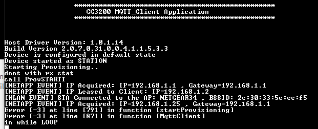

  • Hey Alex,
    I see in your UART log screenshot both the provisioning task and the mqtt task return the same error. I'm not sure if you may have a scheduling conflict. Could you try doing provisioning with everything else disabled in your application (e.g. MQTT, peripheral... etc)? Please let me know the results. Also, what function specifically returns -3 error?
    Jesu

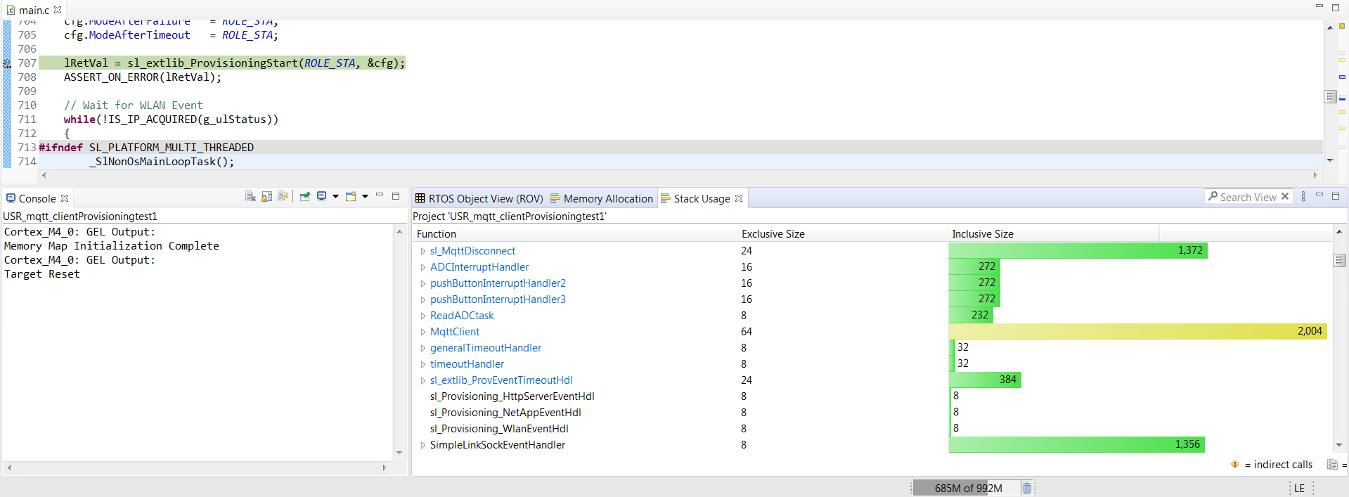

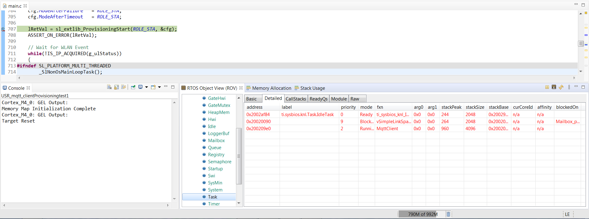

  • sl_extlib_ProvisioningStart is the first API returning -3. It's within function startProvisioning(),which runs from the main task and also returns -3.
    The main task is the MqttClient task from the example projects. But the particular project shouldn't matter, as i have also tried to add provitioning to he get_time project (Freertos) and it fails the same way.
    The startProvisioning() function has been ported from the AP provisioning project just with changing some lines MAP_UtilsDelay-->osi_Sleep. I am not running anything else there ,as this is at the start of the task.
    Here are some RTOS data before the instruction sl_extlib_ProvisioningStart is ran,if it's worth anything:
    Thanks ,Alex

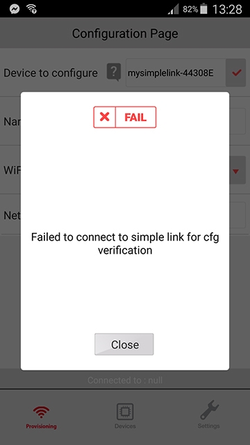

  • Hi Alex,
    I can somewhat re-create the behavior you're seeing. I'm not sure if it's exactly the same.
    I get the following error in the SimpleLink Start Pro mobile app when I try to provision: "The provisioning sequence has not started yet. Device is waiting for configuration to be sent".
    Could you confirm that you get the -3 errors when the provisioning timeout occurs? In my tests I noticed startProvisioning returns when the provisioning timeout occurs. My guess so far is that there's something causing the OS provisioning library to not progress even though the AP profile is getting added. This is why we are staying stuck until the timeout occurs and then we can connect to the AP.
    Jesu
  • Sometimes this is the error i get with this program in the SimpleLink Start Pro mobile app ,too.
    Yes that's the same errors. The -3 errors. Are they timeout? I don't know.

  • Hello again,
    I did some testing with this. You had slightly modified the contents in network_if.h. Seems i also need to remove network_common.c from the project.
    However even in the project you exactly described me, process goes as you show but throws error [-76] after provisioning succeeds. This is what my mqtt project shows after provisioning succeeds:
    I found this thread which says to not use provisioning when already connected. I made sure for this by formatting the flash before i run the code and also modifying provisioningStart:
    if(!IS_CONNECTED(g_ulStatus)){
        lRetVal = sl_extlib_ProvisioningStart(ROLE_STA, &cfg);
        ASSERT_ON_ERROR(lRetVal);
    However this didn't help,even though i now made sure to not be connected. Also tried setting different connection policies.
    Thank you for the help and i know this isn't your fault,but this is getting frustrating, I just think i will start it in AP and just use my phone to send a JSON with a key and the credentials. Seems simple to provision like that.
  • Hi Alex,
    I'm not sure what you are doing that is causing the -76 error. I searched in the SDK and this is the error code: SL_ERROR_WLAN_DRV_START_FAIL.
    You may have to make additional considerations for your custom application to make everything work smoothly. Perhaps try disabling your connection policy before starting provisioning. Also, if you start provisioning don't create or have any other task running. It is best to let that run to completion before starting up the rest of your application. It is makes it easier for debugging because you build your application incrementally.
    I'm not sure what else to suggest here but I'm glad you finally got provisioning to work.
    Jesu
  • Hey jesu. This is not only happening to my project,but also to yours. If you let it run further down you will see it throws this error. Anyway i set the connection policy in ConfigureSimpleLinkToDefaultState() to
        lRetVal = sl_WlanPolicySet(SL_POLICY_CONNECTION,
                                    SL_CONNECTION_POLICY(0, 0, 0, 0, 0), NULL, 0);
    but no effect.
  • Hey Alex,
    You are saying my example code also reproduces this error? All I'm doing is provisioning. Once that finishes I just let it sit there. Do I have to do anything else to reproduce this error?
    Jesu
