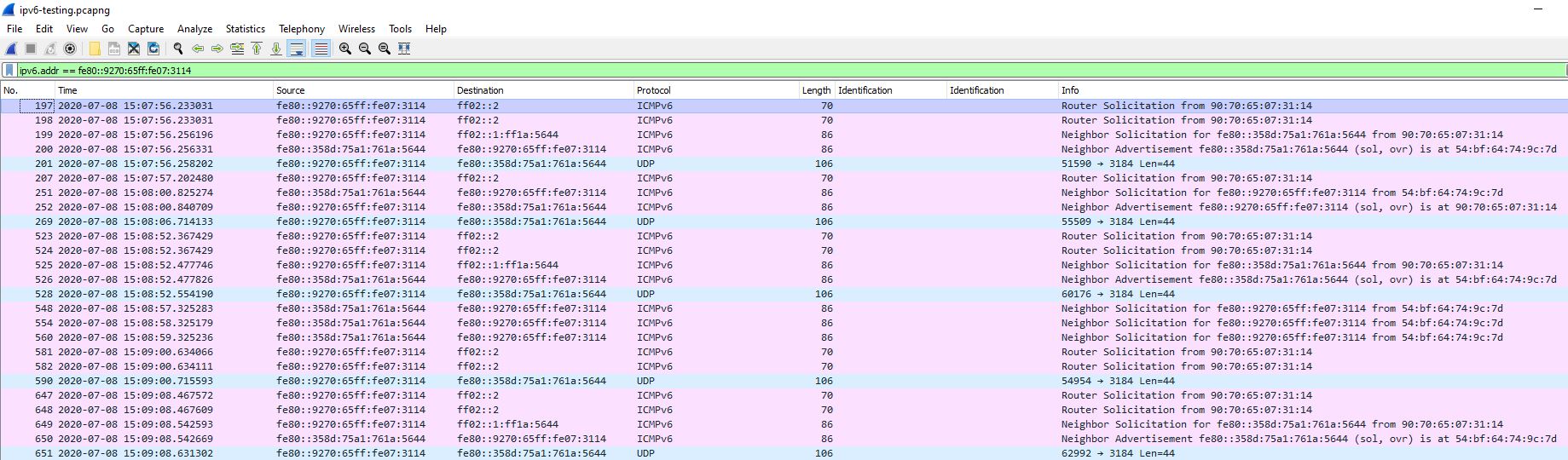

For this application, it would be acceptable to disable DAD. Is there a way to disable DAD via the SDK or otherwise? (However, the router appears to be responding quickly to the solicitation - see the Wireshark capture.)

  • As far as I can tell, ignoring the DAD validation doesn't seem to be an option. If I remove the wait for SL_IS_IPV6_ADDR_VALID to complete, a packet is not sent to the correct destination IP. In Wireshark I'm not seeing any IPV6 UDP packets being sent if I don't perform the wait. (It doesn't seem like a packet is being sent at all, not even to a different address.)
    However, I am getting a positive (>=0) response from the sl_SendTo function. See code below:
