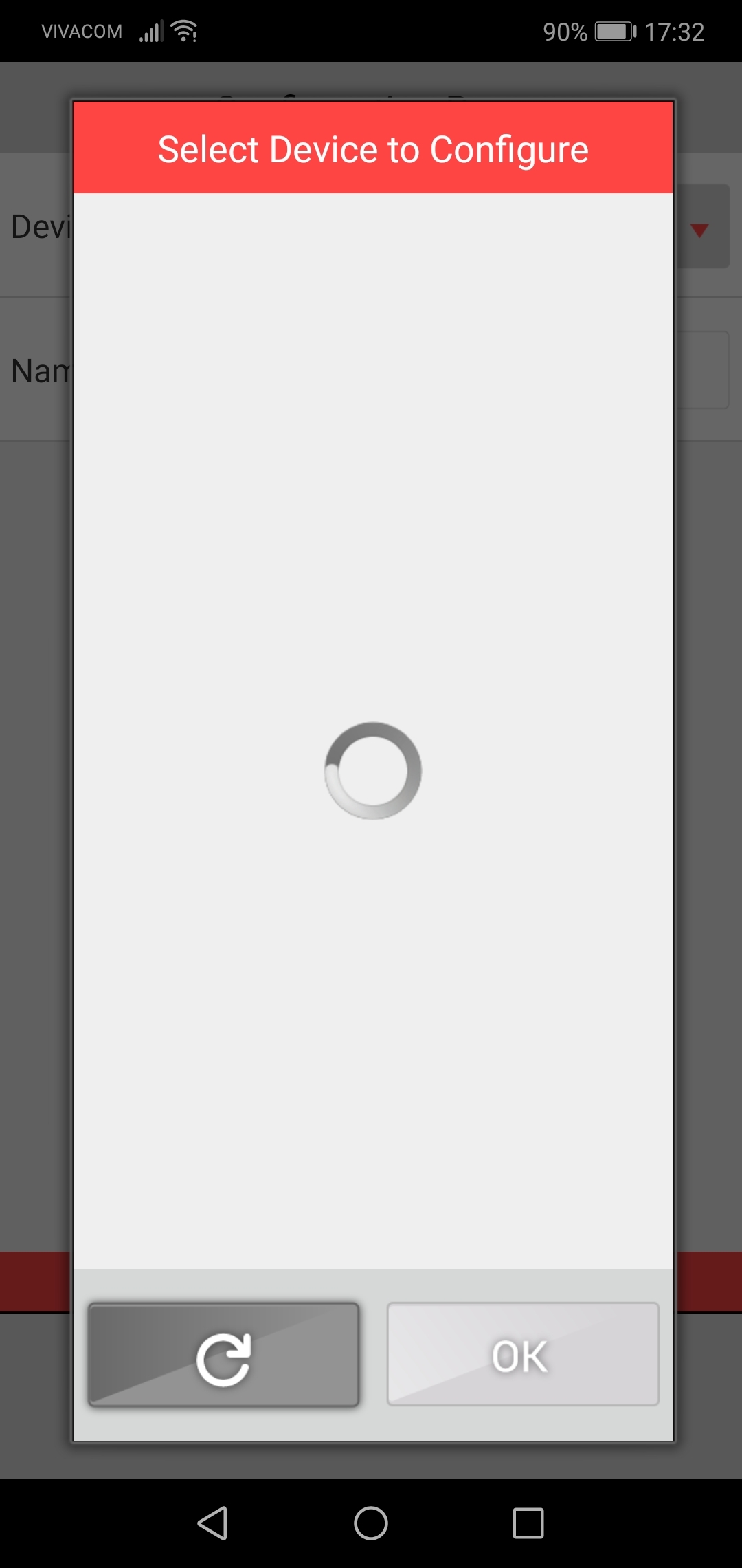

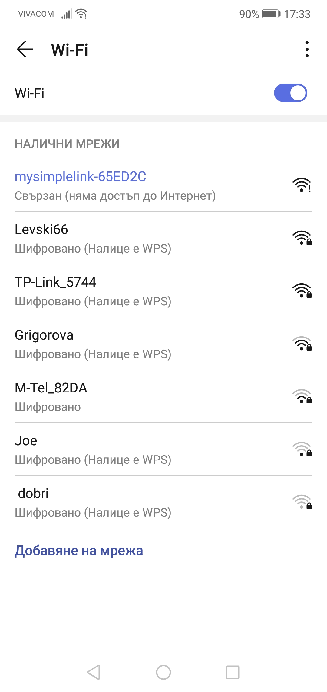

  • Hi Paul,
    yes my phone is able (and is connected normally to the Wi-Fi router) and work via Wi-Fi router, and is able to find all Wi-Fi routers around.
    From configuration page -> WiFi network drop down menu - open new window and can not find any WiFi router (the list is blank)

    1. I am trying to use Wi-Fi Starter Pro to provision the Simplelink device in AP mode.
    The CC3120MOD enter in provisioning AP+SC mode and I see it own network - mysimplelink-65ED2C.
    But from Configuration page-> Device to configure - the application can find simplelink device.

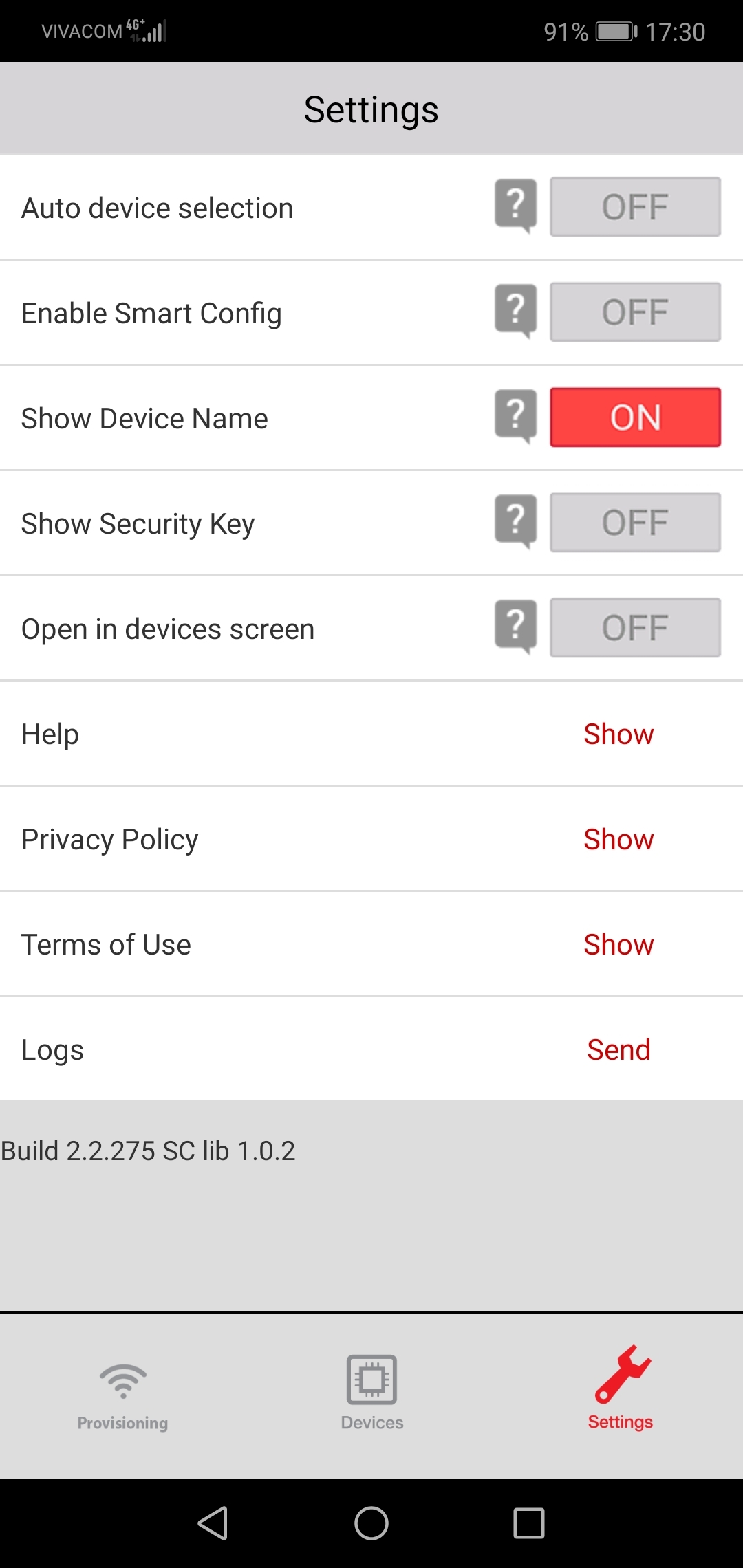

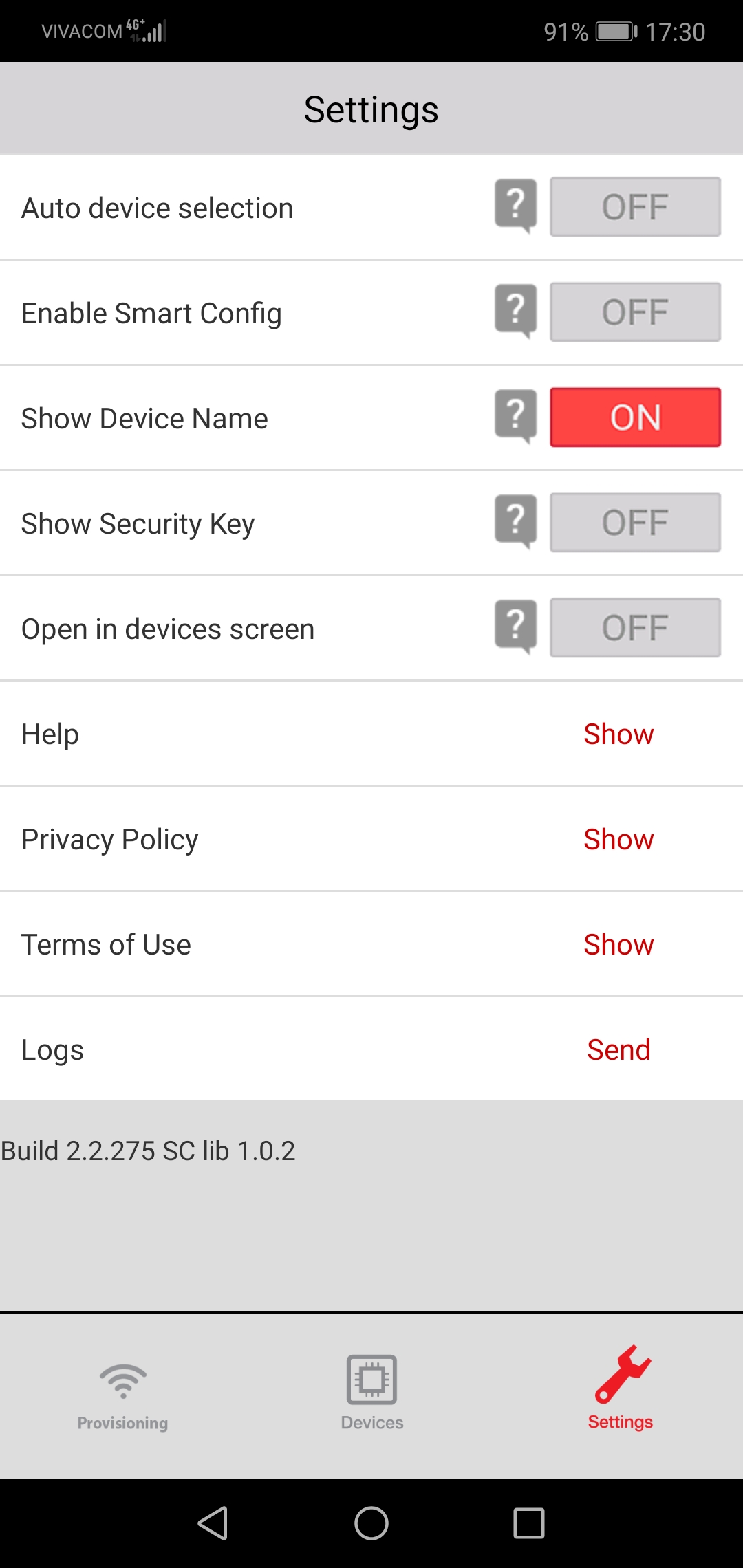

  • Hi Paul,
    1. The version is : Build 2.2.275 SC lib 1.0.2
    2.
  • Hey Ilian,
    Thank you for providing the screenshots!
    There aren't any known issues with either of the two phones you tested. Generally if the phone is able to scan and list Wi-Fi networks then the mobile app should be able to as well. One thing you could try is disabling cellular data. Some phones seem to have issues with non-connected networks.
    Paul
