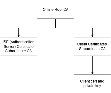

We have been integrating Enterprise Security connection using authentication method EAP-TLS with different networks successfully. However, we are experiencing issues with the latest integration. We are using the SDK version 3.40.00.05 and Service Pack version sp_4.4.1.3_3.1.0.5_3.1.0.19.
According to User's Guide Section 4.6.2 Enterprise Security, the device needs 3 files for EAP-TLS connection:
  1. Server Root CA file saved under "sys/cert/ca.der" in DER (Binary) or PEM (ASCII) format.
  2. Client certificate saved under "sys/cert/client.der" in DER (Binary) or PEM (ASCII) format.
  3. Private key saved under "sys/cert/private.key" in DER (Binary) or PEM (ASCII) format.
In order to prepare the device for authentication, we are given a .pfx file with all necessary certificates which is password protected. Using this given password we also use openssl commands to convert them into supported format of TI. The openssl command that we have been using is "openssl.exe pkcs12 -in certificates.pfx -out certificates.cer -nodes". This command asks for the password and puts all certificates in PEM (ASCII) format in one file. Later, each part with the corresponding "-----BEGIN *** -----END ***" texts have been copied to separate files with certain names given above.
This has been working for many different integrations but the latest Enterprise Security integration has a different topology of CA than the others. Until now, we were given one Root CA and one client certificate with one private key where the client certificate was issued by the Root CA. The latest integration has one offline Root CA which has issued two different subordinate CAs. The first subordinate CA is the ISE (Authentication Server) Certificate and the second subordinate CA is the issuer of all client certificates (I'm calling this Client Subordinate CA from now on). So the topology for each CA and client certificate is like this:
  • Offline Root CA
    • ISE (Authentication Server) Certificate Subordinate CA
  • Offline Root CA
    • Client Subordinate CA
      • Client Certificate and Private Key
I would like to understand which of these CAs will help me connect successfully to the network. We first tried connecting to the network with Offline Root CA as the file number 1 ("sys/cert/ca.der"). Later, we tried ISE (Authentication Server) Certificate Subordinate CA and Client Subordinate CA as the file number 1 ("sys/cert/ca.der") but no success.

  • Ogulcan,
    Firstly let's make sure your root of trust is correct. You indicated two root CAs above. If we look at this example -
    Offline Root CA
    We need the Root CA, and the client cert and private key must have been derived by the same root CA. Can you confirm that?
    BR,
    Vince
  • Hi Vince,
    No, actually I indicated that there is only one Root CA which has two subordinate CAs.
    But I can confirm that the client cert and private key have been derived by the Client Subordinate CA which is derived from the Root CA.
    Here is a diagram of the 1 Root CA, 2 Subordinate CAs, 1 client certificate and 1 private key.
    Ogulcan

  • Hi Ogulcan,
    Assuming that the client key/cert are signed by the subordinate CA, which is itself signed by the root CA, this should be the same topology as what we've encountered in the past.
    At this point, looking at the NWP logs to see what is occurring at the CC3235 side during the EAP connect would be useful. If you could collect those logs during those connection failures that would be appreciated. Please see the instructions in section 20.1 of the NWP programmer's guide for details: http://www.ti.com/lit/swru455
    The logs will be in a binary format if you have captured them correctly. This is normal, as the logs are only able to be decoded by TI. There is however a sanity check you can perform on your collected logs before you provide them to me. If the NWP logs are captured successfully from cold boot, you should see some ASCII plaintext in the raw logs, most notably the /sys/servicepack.ucf NWP SP file. Furthermore, the 3 bytes of binary data preceding that string will be 0x27 0xCA 0x2F. If you check for the string + those 3 bytes and see it in your logs then it should be captured correctly and decodable by my tools.
    Michael
  • Dear Michael,
    Thank you for your answer. Yes, both subordinate CAs are signed by the same Root CA. I am not sure if this is relevant information but other devices with Windows OS uses the following configuration for successful connection. The Root CA must be installed under "Trusted Root Certification Authorities/Certificates". Both subordinate CAs must be installed under "Intermediate Certification Authorities/Certificates". Lastly, the client certificate must be installed under "Personal/Certificates". All 4 certificates are needed for successful connection with Windows OS. For the CC3235SF, I'm only able to provide "ca.der" and "client.der" for EAP-TLS connection. It is still not exactly clear to me which CA I need for the "sys/cert/ca.der". Is it the Root CA or one of the subordinate CAs? I assume you mean the Root CA is needed as "ca.der". What about the other subordinate CA? How does the CC3235SF client authenticate with the ISE (Authentication Server) Certificate Subordinate CA? According to Radius logs that seems to be the problem.

  • I have tried creating the client cert/key with different sub CAs but the result is the same. As I have mentioned previously, the client certificates are created on Windows OS in p12 or pfx format. Later, I am using openssl command "openssl.exe pkcs12 -in certificates.pfx -out certificates.cer -nodes" to convert it to PEM (ASCII) format. This "certificates.cer" contains Root CA, sub CA, client cert and client private key. I copy each part in a text editor starting with "-----BEGIN ***" and ending with " -----END ***" to a new file and save them with the corresponding naming; "ca.der", "client.der", "private.key".
    You can find a set of example certificates and key attached.
    1018.certs.zip
    The User Guide says that the private.key can be in PEM(ASCII) or DER(binary) format. I always used the PEM format but I will try binary format as well.
  • During debugging, I found out that if I disable TLS_RSA_WITH_3DES_EDE_CBC_SHA, TLS_DHE_DSS_WITH_3DES_EDE_CBC_SHA and TLS_DHE_RSA_WITH_3DES_EDE_CBC_SHA (basically the ones with 3DES) from accepted cipher suites device reacts different than before. I receive SimpleLinkWlanEventHandler, event SL_WLAN_EVENT_DISCONNECT with code SL_WLAN_DISCONNECT_UNSPECIFIED.
    Disabling the above cipher suites on the Radius Server TLS settings, causes the Radius server to send an Access reject. Here is a snapshot of the comparison.
    Also looking at the Radius logs I am comparing the Access request from a Windows OS laptop and TI CC3235SF. It looks like while the laptop ClientHello message is TLS v1.2, the one from the CC3235SF is TLS v1.0. I though CC3235SF supported TLS v1.2 for enterprise connection. Here is a comparison of that as well:
    I hope these are helpful for debugging the issue. Please let me know as soon as possible if you find the root cause of the issue, as this is a very urgent matter with our client. Hope to hear back from you soon.
  • Hi again,
    It seems like TI support is not responsive or helpful at all when it comes to WiFi forum. After many days of debugging the issue, finally I was able to find the exact combination of how the files should be under "sys/cert" folder. Here are the things that I have found out:
    1. "ca.der" file has to be the Root CA. If you add any chain certificate to this file (the sub CAs in our case), the Radius Server throws an unknown CA error and the access request is rejected.
    2. "client.der" file has to be the full chain until the Root CA. If you put only the client certificate here, the Radius Server rejects the request. If anyone from TI support had mentioned me any suggestions about this, I wouldn't have had to try every single possibility of chain and or singular certificates.
    3. This is the most important matter about the issue which solved the NWP assert. "private.key" MUST be in binary format! Even though, the documentation and forum posts say that any of these 3 files can be in binary or ASCII format, it is not true for the user key. I suggest TI engineers to investigate the reason behind this.
    4. Any of these files MUST have Unix (LF) ending. I haven't seen this anywhere on the several CC3x20,CC3x35 documentations or Programmer's Guide but luckily it is mentioned in the Uniflash User's Guide.
    Finally, I am able to connect to an Enterprise Network with EAP-TLS using these configurations. However, there is an issue which could still be a problem. Can you please tell me why do I see TLS v1.0 exchange with CC3235SF, while it is TLS v1.2 with Windows OS connection request? I have provided the comparisons and screenshots on my previous post. I hope to get an answer from you soon.
