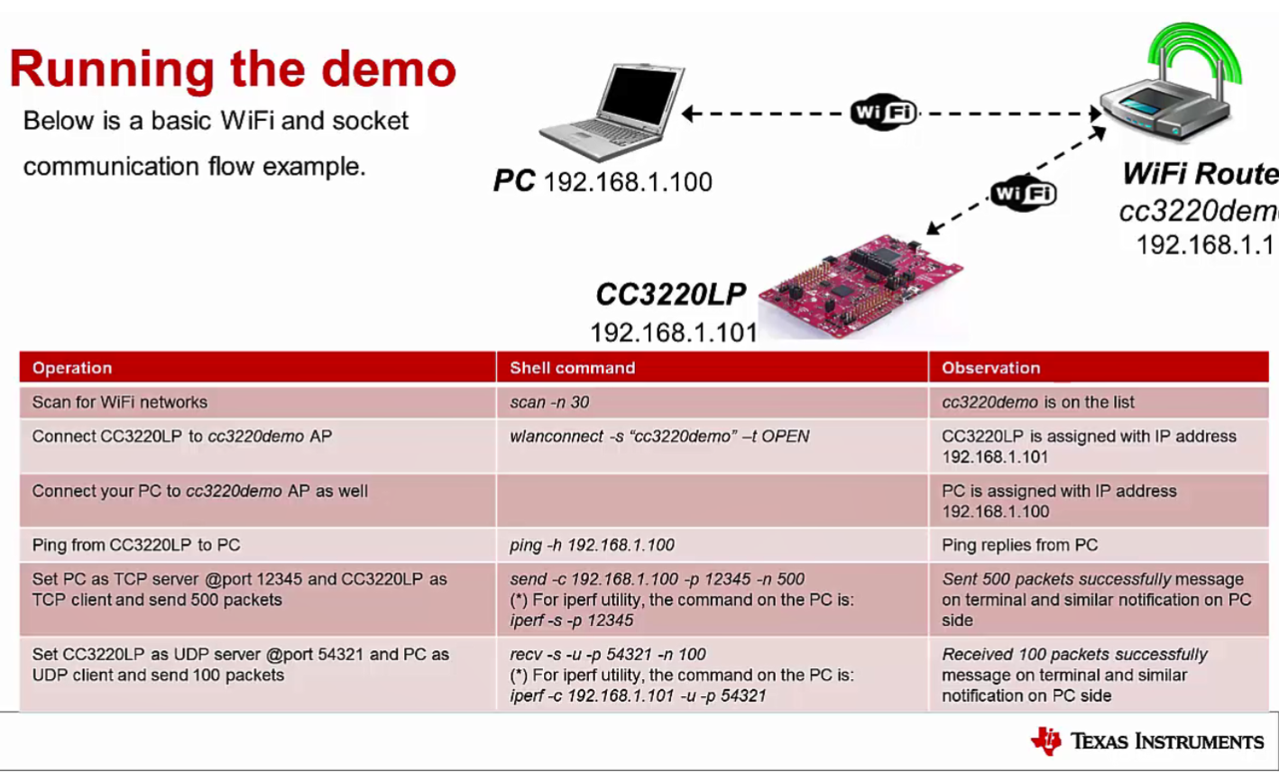

We follow the instructions below, everything is fine till we try to send TCP data from CC3220S to PC on step 5.

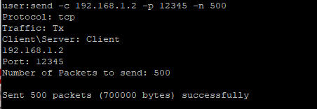

On putty we can see CC3220S could send 500 packets successfully:

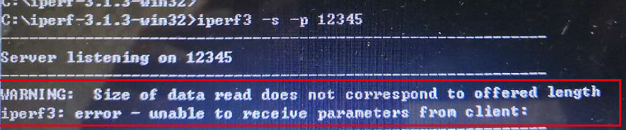

But on PC side, always fail, also tried different packet numbers, the the same:
Any ideas why?
