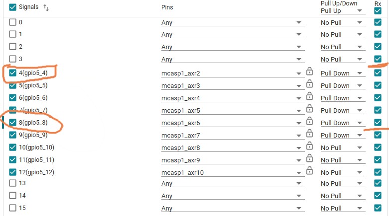

I am facing problem in bringing wlan0 up second time on Linux PSDK 5.03. I have checked the GPIO pin wlan_en using oscilloscope, it doesn't go low when the wireless interface is brought down. I was suggested by TI experts to add pinmux entries in device tree file.
I was going through the am5728_gp_evm.pinmux using TI SYSTEM CONFIG software and I have some doubts. I have attached an image of a section from TI sysconfig software. The GPIO pins I am concerned about is GPIO5_8 (WL_EN) & GPIO5_4 (BT_EN)
What does the Rx column signify? It is checked in case of both the pins.
