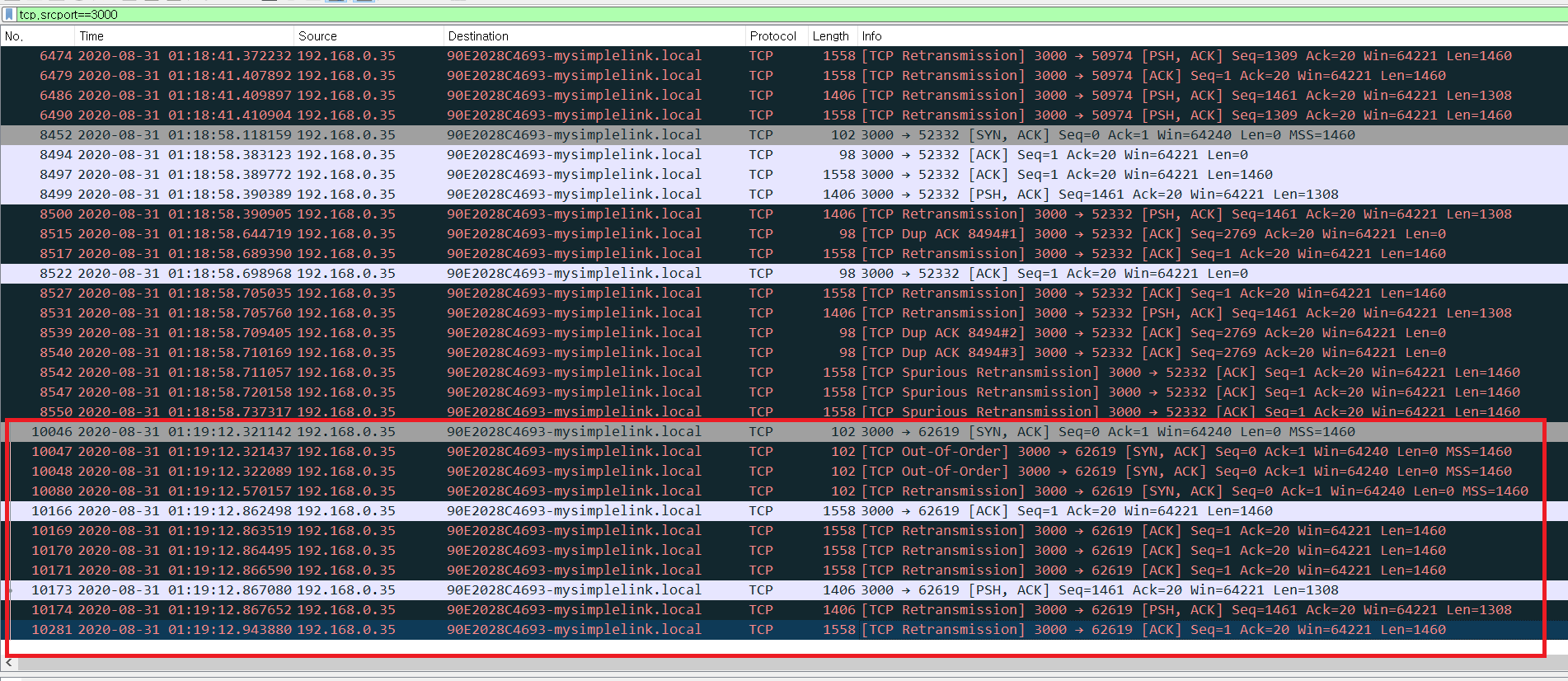

    Could you check the attached pcap log? I tried 4 times test and only succeed on the last try as the red box in below picture with #1 log.
    Other prior 3 times were same result with #2 log. Server tried to send 2768 bytes to the CC3235 but I'm not sure CC3235 received it all.
    2768bytes.zip
