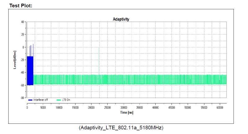

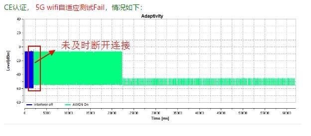

Hi, we are undergoing CE certification test, but the result shows that we had failed the 5G Adaptivity test. The below picture said that the green signal should direct cut off after the blue signal off.
The Lab suggests us to change the detect sensitive. May I know how we can change the RF param or any setting in the wifi in order to pass this 5G Adaptive test?

The required result should be as below

    You should not be adjusting anything in the Radio. When we see an issue with adaptivity we need to first confirm a few things:
    1) What region are you set to. Ensure that you have set on of the CE regions
    2) The test is done at the application level. and connected to an AP
    3) The calibration is important here. Ensure that this test is all done conducted and not radiated. You need to ensure that the signal level to the DUT is calibrated for the test.
    To check to see if adaptivity is working, you can try to increase the interferer signal by 10dB to see if adaptivity kicks in.

    [RM] you need to use iw reg get to see what region you are set too. If it is not one of the EU regions, then you can use iw reg set XX where XX is the ascii country code.
    Yes, we are connecting the device to a router using nmcli command from the linux
    [RM] OK but for this test you can also use iperf.
    May I know how can I ensure that the signal level to the DUT is calibrated? Is there any document that I can refer to?
    [RM] here it is important that the cable loss from the generator that is playing the interfere signal is appropriately calibrated to the signal reaching the DUT. Remember that for adaptivity the signal elves are quite low, so it is important the you have calibrated to the DUT input. I would suggest that the generator you are using for the interfere signal be set at ~0 dBm, then you use external attenuation to get to in interfere signal level you need. The signal generator is more accurate at 0dBm then it would be at -60dBm.
