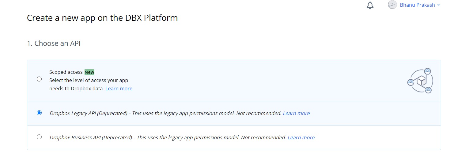

     Can you send the link for updated dropbox app creation?
    Also in the first folder (TI_CC3200_WTHR01) I'm adding the .bin file and what are the files to be added in the 2nd folder (TI_CC3200_WTHR02 )?
    I tried using both legacy api and scope access..
     May I know what should I select among the above options

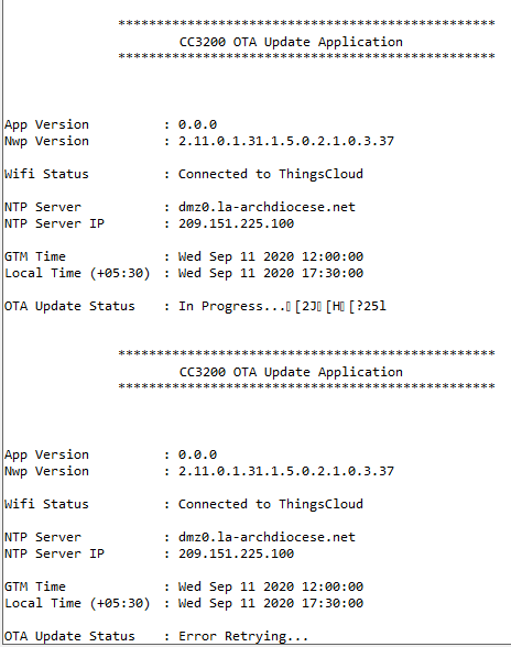

     Just to avoid confusion .. OTA_VENDOR_STRING is same as what is given in the ota_update_nonos application "Vid00_Pid00_Ver00". Please forget the other Vendor string mentioned above... The SDK version is 1.3.0.
    we ran ota_update_nonos by adding the acces token generated from dropbox with the legacy api option as shown in the figure below.
    We have observed that the execution is toggling between  two states OTA_ERROR_RETRY and IN PROGRESS continuously..     Since we are observing  Scope acces (NEW)  in the options we have a suspicion that is there an update in the dropbox api?

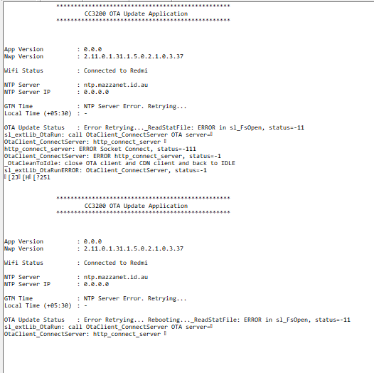

  • I build the OTA file and then it started printing the above message when I'm checking for the OTA update. Still OTA update is not happening...
    Can you suggest me what to do further?
  • Now at least I can see some additional debug printouts.
    It seems as you are failing to connect to the server (-111).
    I can see that you defined the connection as secured which is OK.
    can you step into and see why you are failing to connect (just go all the way down to http_connect_server() which calls sl_NetAppDnsGetHostByName() and then sl_Connect())?
    Are you behind a proxy/firewall? can you try connect through your mobile's hot spot?

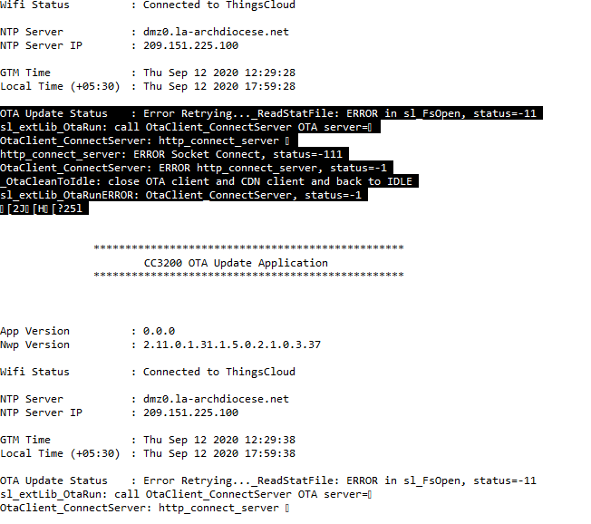

  • I tried with mobile Hotspot still same error is coming
    This time you don't even get the time over the NTP server but you did before.
    what happened? what is different?
    Hard to tell why you are not able to connect.
    In these cases, it is best if I can see an air sniffer (do you have this capability to capture the air over Wi-Fi)?
    In addition, you can also fetch logs from the NWP in the device. Then i can see what is going on internally. The procedure to do so is as below.
