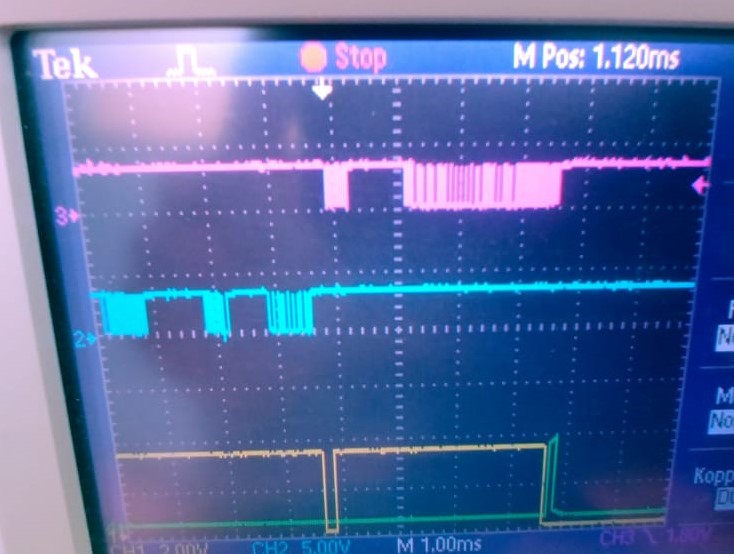

    The following picture shows the first command (reading the mac address)
    the pink signal is the transmission from the module. the blue one is the host data, the yellow one is the IRQ line and the green one is the RTS Signal from the module. The host rts is always kept low as we ware working with dma.
    When the host send the next command i can see the transmission on the blue line. The IRQ and module RTS line stay low

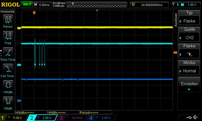

    The first shows the initial sequence from the module and the Read command from the host (mac address)
    CH1 (yellow): IRQ Line
    Ch2 (sky blue): Module RX
    Ch3 (dark blue): Module TX

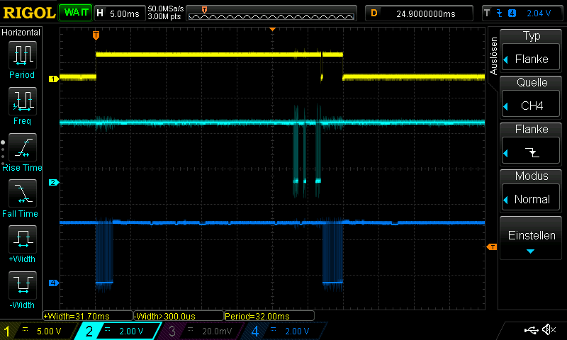

    This picture shows the second request from the host (again asking fpr the mac address)
    CH1 (yellow): module RTS
    CH2 ( sky blue) Module RX
    CH4 (dark blue) module CTS

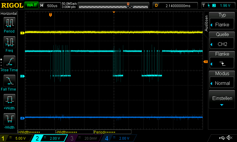

    The following picture shows the second command again with IRQ and TX captured
    CH1 (yellow):  IRQ
    CH2 (sky blue): Module RX
    CH3 (dark blue): Module TX
    The IRQ line stays low until the function reaches the timeout and returns errorcode -2005.

  • Hi Vince,
    A comparision with the module connected to the launchpad showed that the Modules RTS line was not connected properly.
    Therefor the host sent data to the module even if the modules RTS line was high.
    Thank you for your support
