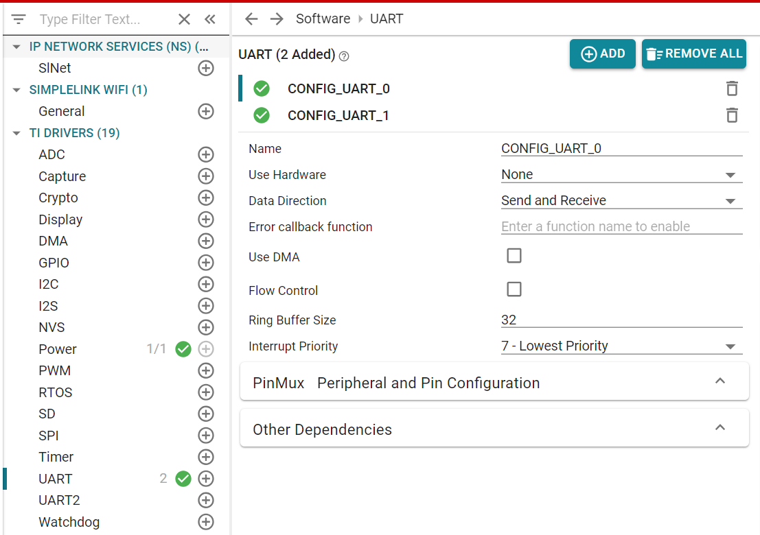

Hello Champs,
Customer needs to use another UART in CC3220MODA, would you please kindly help provide the guidance how to add UART2 function in below AT_Command demo codes?
C:\ti\simplelink_cc32xx_sdk_4_20_00_07\examples\rtos\CC3220SF_LAUNCHXL\demos\at_commands\tirtos\ccs
Thanks!
Linda
  • Hi Linda,
    Please note that UART2 is the name of a driver that is a "UART 2.0" set of APIs. For example, instead of UART_read, the API would be UART2_read. UART2 is not a peripheral name.
    If the customer would like to add a second UART instance, they should add a second instance to the UART driver.
    The AT_commands example demonstrates UART functionality in uart_term.c. They also should see the TI Drivers API guide for documentation and code snippets.
