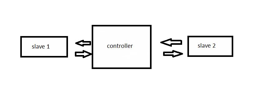

I am trying to establish connection between my launch pad cc3235s as master and power supply (uses rs232) for that i have usb to ttl converter.
and here i am using both uart port of cc3235s, one for debugger and another for ttl. see following picture to get idea what i am trying to do.
firstly i want to establish connection with single slave once it is done than i will send same data with some modification(as per requirement) to the another slave.

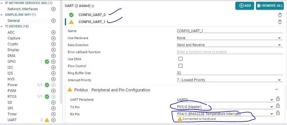

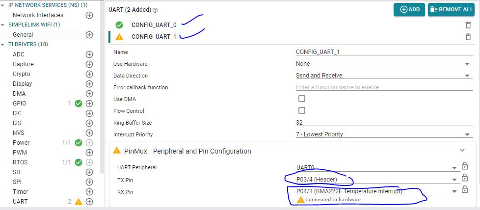

hardware xds110 is connected with uart 0 so debugger is working well. and second uart is connected with my ttl pin p03 and p04 , and my slave is not connected only ttl is connected with controller. i am getting echo character over p03 and p04 (or on serial port).
but when i am connecting slave and sending command data instead of single char, no response is coming back.

    Thanks for reply, at this stage i am able to send command to slave and it's changing it's state accordingly. and it should send back response packet of 28 byte.
    but, i am not able to get that packet.
    in short my callback function is not getting call ever. i did the changes as you said. have a look..

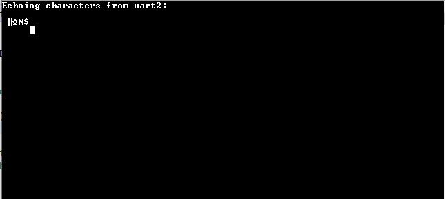

    every time whenever i am running my program , this is what i am getting on the terminal windows.
    and slave is changing it's stage immediately, which is good as expected. it means i am able to send data(command), but not able to receive.
    please help me to get rid from this problem.

    but, not able to get data.
    please do let me know what else should i try?

  • this time i am able to send data to UART0 using pin03 and p04 ,
    but as i mentioned above i want to talk to two uart slaves at the same time, in short i want to take data from one uart that is uart0 and same data i want to show to another slave(display) through uart1 .
    but i am unable to show the data on slave(display) through uart1.
    how can i use another UART1 on pin55(tx/gp01) and pin57(rx/gp02), please do let me know?

  • Hi Sarju,
    I made a simple test program based on the uartecho SDK example to test uart0 + uart1 echo functionality much like what you're trying to do by reading data from slave 0 and passing it to slave 1 and everything works as expected.
    I have this code using p55/57 as UART0 through the XDS110 launchpad debugger, as well as p3/4 for UART1 through an FTDI UART to USB adaptor, and I have verified that the functionality works correctly on my CC3235 launchpad.
    The example code is attached here, simply import the uartecho project and overwrite the existing uartecho.c with this code: /cfs-file/__key/communityserver-discussions-components-files/968/uartecho2.c
    Please use that code as an example of how to have two UART peripherals passing data to each other, and I advise you either to base your UART communication code off of my example or to carefully compare your UART code with the working code provided and debug the changes needed.
    Michael
