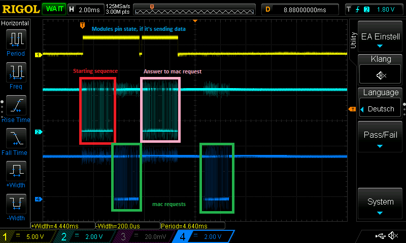

Our Problem: After starting the SimpleLink-Lib with "sl_Start()" we only receive a single answer to one of the requests we are sending (for example we send "sl_NetCfgGet(…)" or "sl_DeviceGet(…)"). However the second request won't be answered anyway - independend of the request we send.
With an oscilloscope we recognized, that the packet was sent to CC3135MOD, but there's no answer at all. It's like the module is hanging or waiting for something.
According to rts/cts the module seems to be Ready - we would wait if it's not. The state of the hibernate pin doesn't Change according to the first request. Also a reset doesn't appear.

    3. Are you getting valid responses from sl_Start() and your first query? Does your second query ever return?

    3. The sl_Start()-Command returns successfully. Also the first query (for example mac address or device infos) returns and supplies valid data. The second query ends in FatalErrorHandler after a while.
    I also checked some simplelink examples, but that's exactly what we are doing.
    On oscilloscope we can see the data we send. However there's no reaction on the modules tx line or the Interrupt pin, which says that the module is sending data. It's like the module is hanging or waiting for something. Please take into accout that we are using UART communication. Is there any difference to SPI communication?
    Is there anything we have to do after a request? Toggle our RTS line, sending an acknowlegde after receiving the modules data or anything else?

    Do you have a logic analyzer available? It would be helpful to capture the pin states so we can see the full picture before and after the fatal command is sent. I'm assuming you are using a 5-wire topology?

    Hi Sarah,
    find the log and a screenshot of the communication attached.
    I hope that it's all you need to get a closer look - if not let me know.

  • Hi Sarah,
    In the meanwhile we solved this Problem on our own:
    Unfortunately the pin configuration of our µC for the rts/cts pins wasn't correct - although the behaviour seemed to be ok. Maybe this was the reason why the module had to struggle with our requests. Unfortunately it was very irritating that the first request worked fine.
    Anyway thank you for your support and your Patience.
