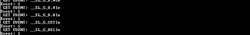

I am trying to upgrade old SDK to latest SDK 1.5 but facing problem in  ( void SimpleLinkHttpServerCallback(SlHttpServerEvent_t *pSlHttpServerEvent, SlHttpServerResponse_t *pSlHttpServerResponse) )  callback.
pSlHttpServerEvent data getting modified from 10 character to 12 character. I have tested html file in browser it working fine and gets token correctly.
Same html code works fine with older SDK and data coming in gets event are perfect. So what could be the possible reason for data getting modified when callback invoked? Is there any dependency file for SimpleLinkHttpServerCallback where i can look?

  • hello,
    i have tested oob example and when i prints http server get event data, it prints more character than 10, so far now i am not concentrating on get event data because comparison happening only for 10 character as length is 10. Correct me if i am wrong.

    Event data are not a null terminated string. You need to terminate data by 0x00 if you want to use printf().
