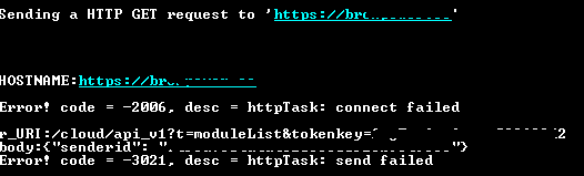

hi,
i am using cc3220modasf SDK "simplelink_cc32xx_sdk_2_10_00_04"
I'm trying to use httpget example and provisioning example together.
My purpose,
Sending wifi SSID_NAME and SECURITY_KEY to the device with mobile application.
There are 2 tasks for this in my code.

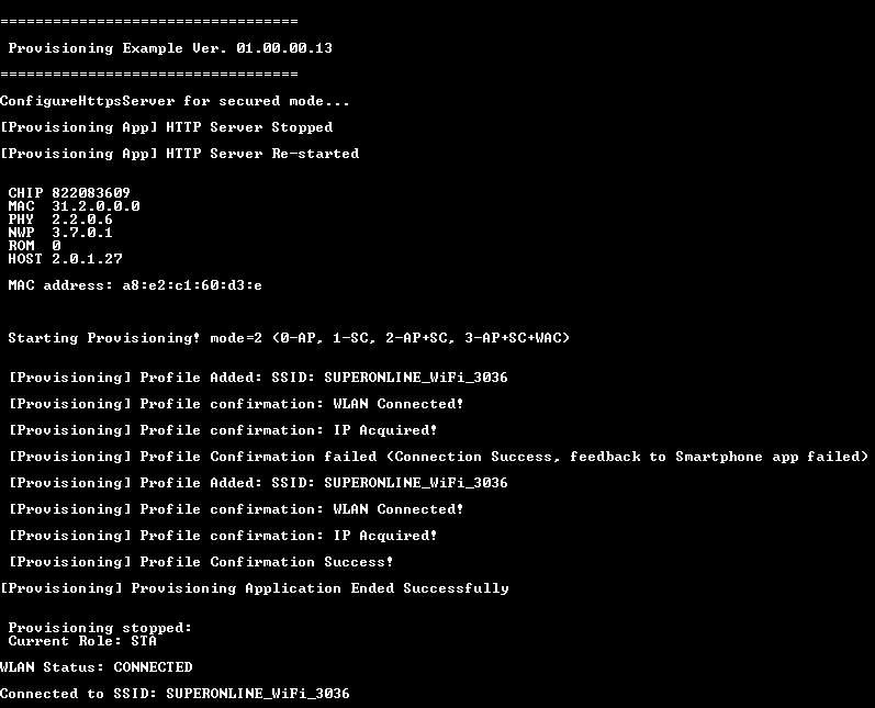

1- provisioningTask
2-httpTask
Successfully executes 1st task operation and when wifi connection is established I'm sending semaphore to task 2.
When my 2nd task starts running I get the following errors
"Error! code = -2006, desc = httpTask: connect failed"
"Error! code = -3021, desc = httpTask: send failed"
my screenshot:
Note: If I don't implementation provisioning then my http code will work.
Note 2: I could not find an answer in this title
Can you help me ?
    You need to understand what is the difference between the working case (no provisioning task) and the non-working case.
    Seems that you fail on error -3021 which is no request header found.
    Maybe it is got corrupted with the provisioning implementation.
    Anyway, what i suggest is to place a break point where this error is triggered (look for HTTPClient_ENOTABSOLUTEURI and capture what URI you are using in both cases. I believe it should be different.

  • This problem is solved as follows.
    If I add these lines of code , my problem is solved
    sl_WlanProvisioning(SL_WLAN_PROVISIONING_CMD_STOP,0 , 0, NULL, (uint32_t)NULL);
    SlNetIf_init(0);
    SlNetIf_add(SLNETIF_ID_1, SLNET_IF_WIFI_NAME, (const SlNetIf_Config_t *)&SlNetIfConfigWifi, SLNET_IF_WIFI_PRIO);
    SlNetSock_init(0);
    SlNetUtil_init(0);
