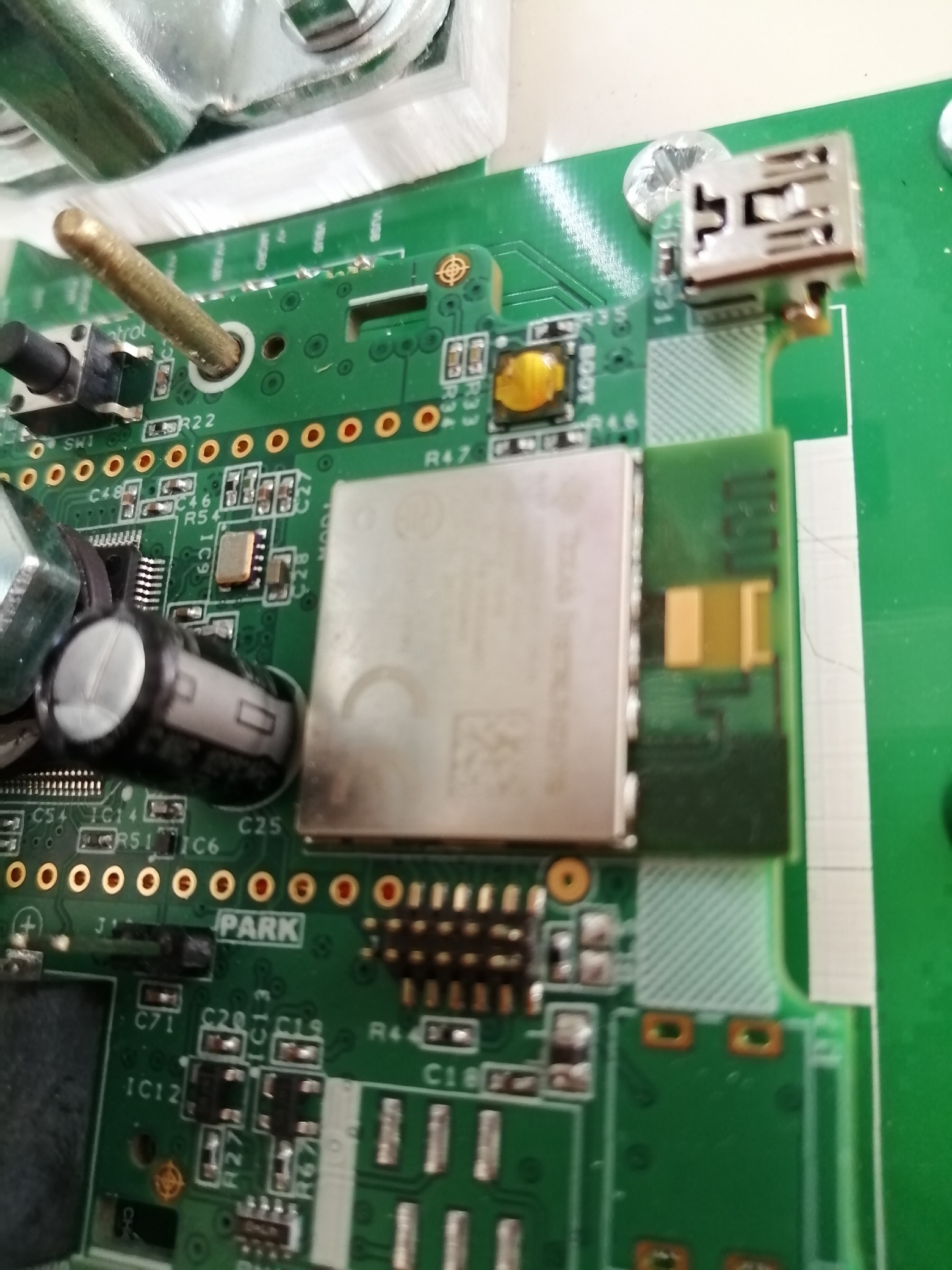

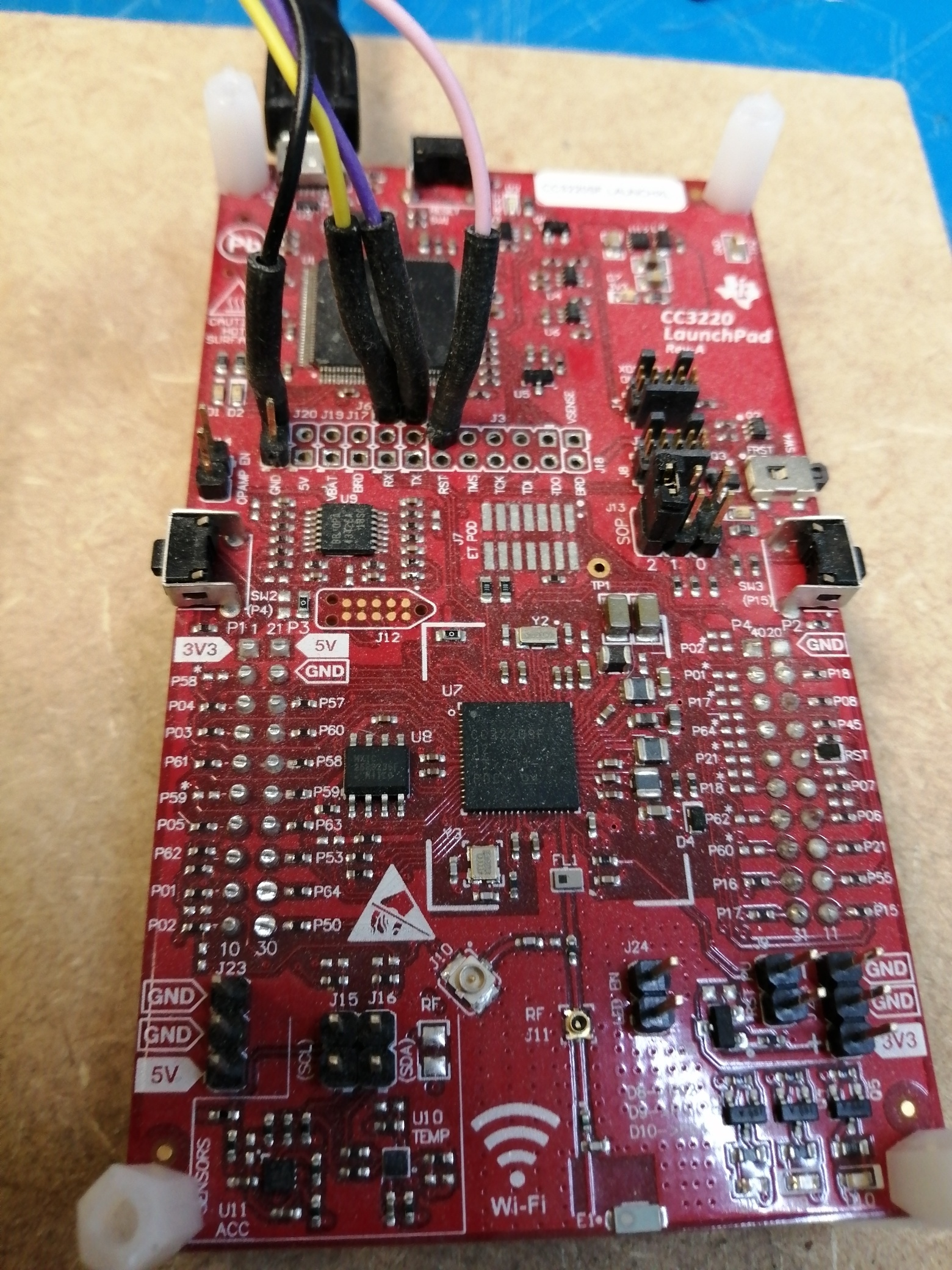

  • Hi Jesu
    The images don't help much. But attached some, just shows what I'm working with.
    The first image is the CC3220MODA fitted to my production board. the micro-match connector at the bottom of the connect is the connection for the UART to the CC3220SF LAUCHXL.

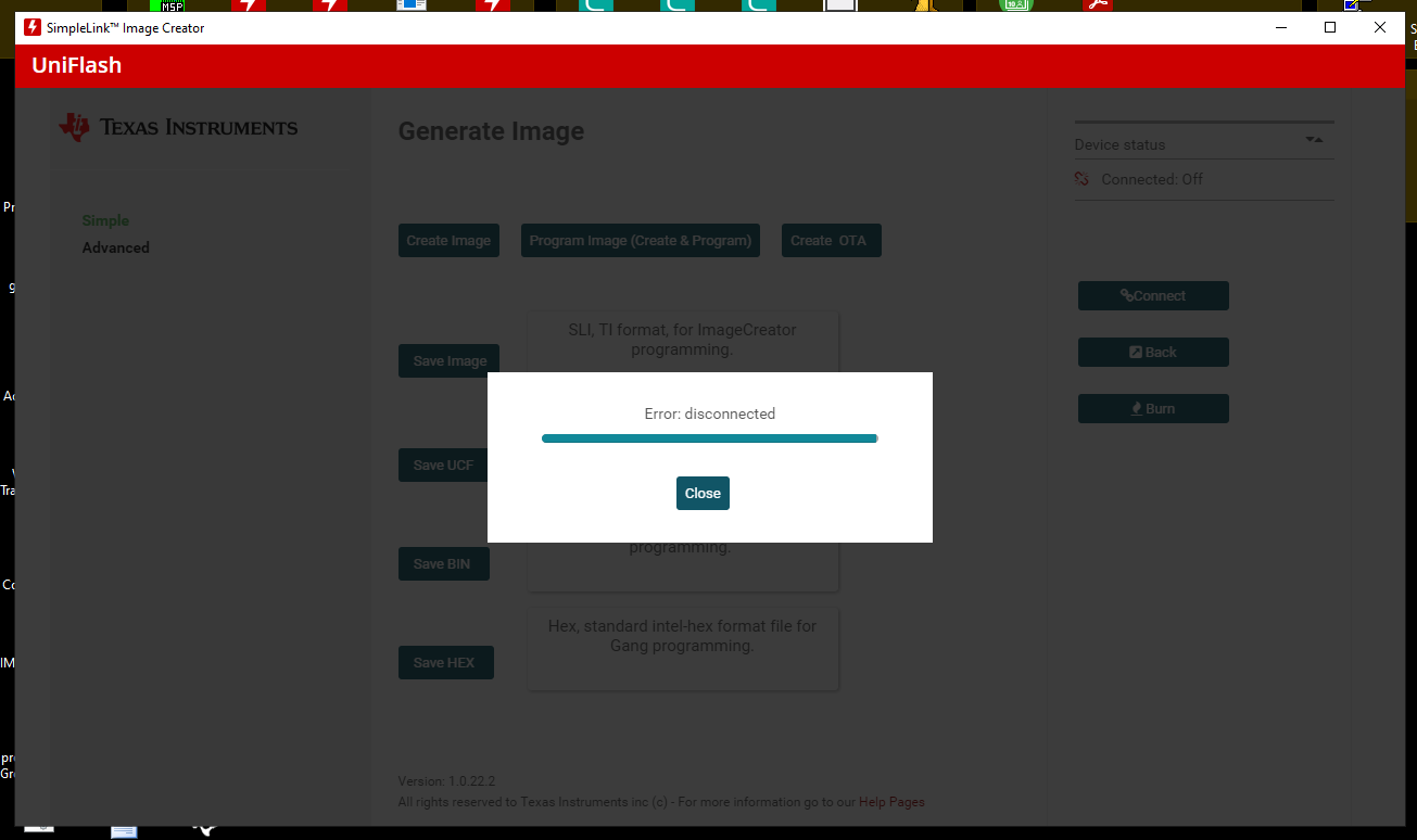

  • Nick,
    I've never seen a "disconnect error" on Uniflash. Please provide a screenshot of Uniflash when the problem occurs. You should also make sure you have good connections from the programmer board to your custom board.
    Also, could you provide your certificate in a private message so that I can see the characteristics?
    Jesu
  • Very little information , as you can see. This happens after 99% upload.
    In this case , I'm using the standard CC3220SF LAUCHXL, programing the onboard CC3220SF (I am not connecting my external board). It still crashes.
    I will set my certificate in a private message.
