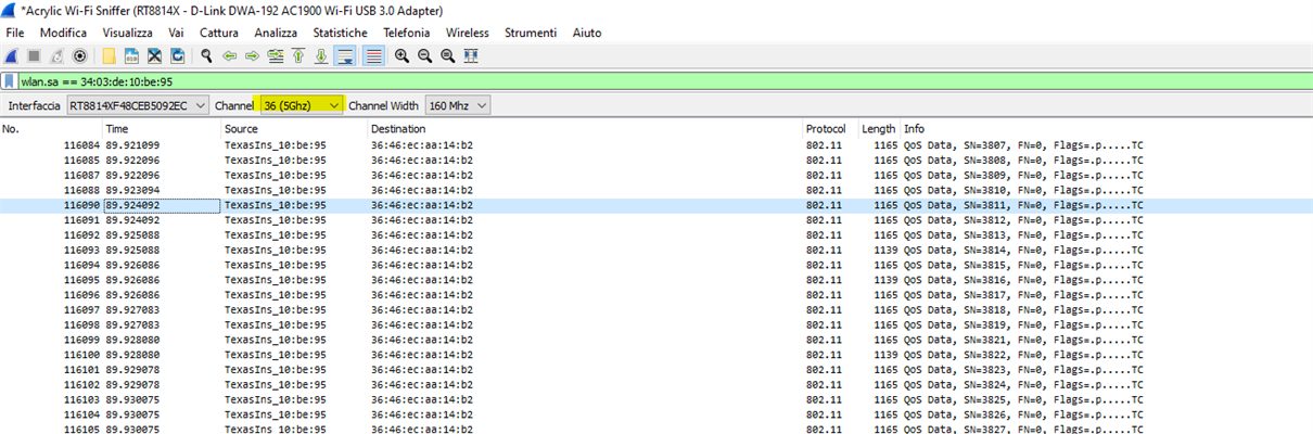

Hello.
I've configured SimpleLink as WiFi P2P Client mode (not GO).
I use an Android tablet to connect with my SimpleLink by Android WiFi settings menu.
After P2P connection SimpleLink act as TCP server.
With a simple Android App I open TCP connection and then SimpleLink thread start to send 1Kbyte packets.
I use AcrilicWiFi sniffer to sniff communication.
Accoridng to datasheet "Wi-Fi Direct® (only supported on 2.4 GHz)", when I scan 2.5GHz I don't find TCP packets between my Tablet and my SimpleLink.
If I scan 5GHz I found some Data packets at channel 36 ... I don't understand why ... is it Android that connect on 5GHz ?
