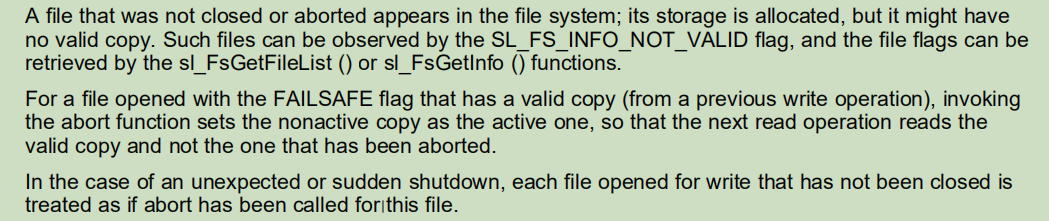

1. I know sl_Fsclose(fileHdl, 'A', 1) means abort function, and it will set the nonactive copy as the active one if the file is opened with FAILSAFE flag. However, it is strange when I write the test code to verify the file system, the abort function acts as the normal close(sl_Fsclose(fileHdl, certificate, signature, signature_len)). Although I can ignore this strange problem, I'm not sure wheather it will bring some other problems for me in the future.

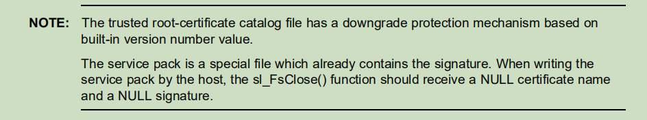

2.I have referred the documentationintroducing file system, which shows servicepack is a special file and when the host writing the service pack, the sl_FsClose() function should receive a NULL certificate name and a NULL signature. The sl_FsClose() function returns -10363(SL_ERROR_FS_ILLEGAL_SIGNATURE) when I follow the guide, but another strange problem happens,  sl_FsClose() succeeds if i give an arbitrary string to signature, for example, sl_FsClose(fileHdl, NULL, "123", 3), sl_FsClose(fileHdl, NULL, "ab", 2), and so on.
In short, my main problem is why the documentation is different from what I tested, which is really confusing.

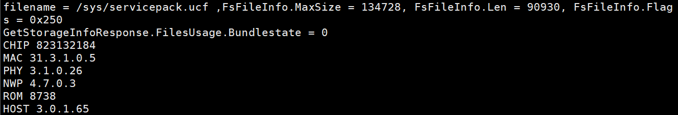

    My SDK version is 4.20.00.07(02 Jul 2020), so I think maybe the servicepack(sp_4.7.0.3_3.1.0.5_3.1.0.26.bin) is the lastest. In order to make sure the servicepack is flashed onto the device, I use sl_DeviceGet() and sl_FsGetInfo() to get the ouput as follow.
    In fact, if I don't flash the servicepack onto the device, everything seems as same as flashing it, except the result of sl_DeviceGet() and sl_FsGetInfo(), the fs_Close() function is still strange.

    Look at this, page 133,
    However, I just find another document showing like this:
    page 21,
    Thanks for pointing out the exact location where you found the note that sl_FsClose() with a null signature works for the servicepack. I will file that as a literature bug and ensure it gets corrected. Please provide the file signature of the servicepack when performing an sl_FsClose on it.
