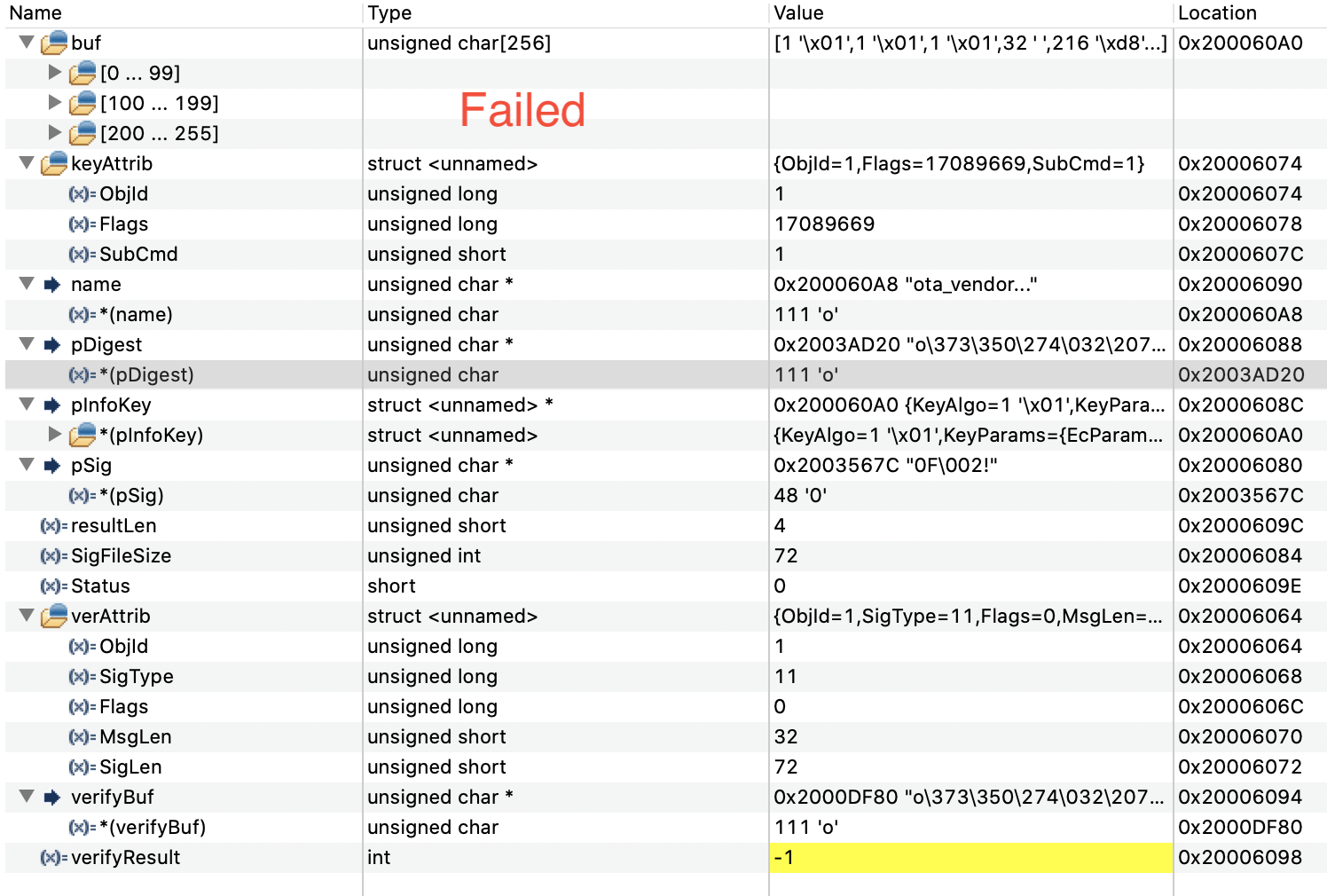

  • Thanks for your response. We cannot use HTTPGet, we are downloading the binaries for the coordinator and other zigbee sensors. In my mind OTA simply has a be able to download, process and check other OTA binaries. So I’ve made some changes to the OTA library to be able to use it for for that purpose. In OTA_set I’ve added a case:
    case EXTLIB_OTA_SET_OPT_RESET:
           pOtaLib->ConsecutiveOtaErrors = 0;
           _OtaCleanToIdle(pOtaLib);
           CdnClient_Init(&pOtaLib->CdnClient, pOtaLib->NetBuf);
           OtaArchive_init(&pOtaLib->OtaArchive);
           break;

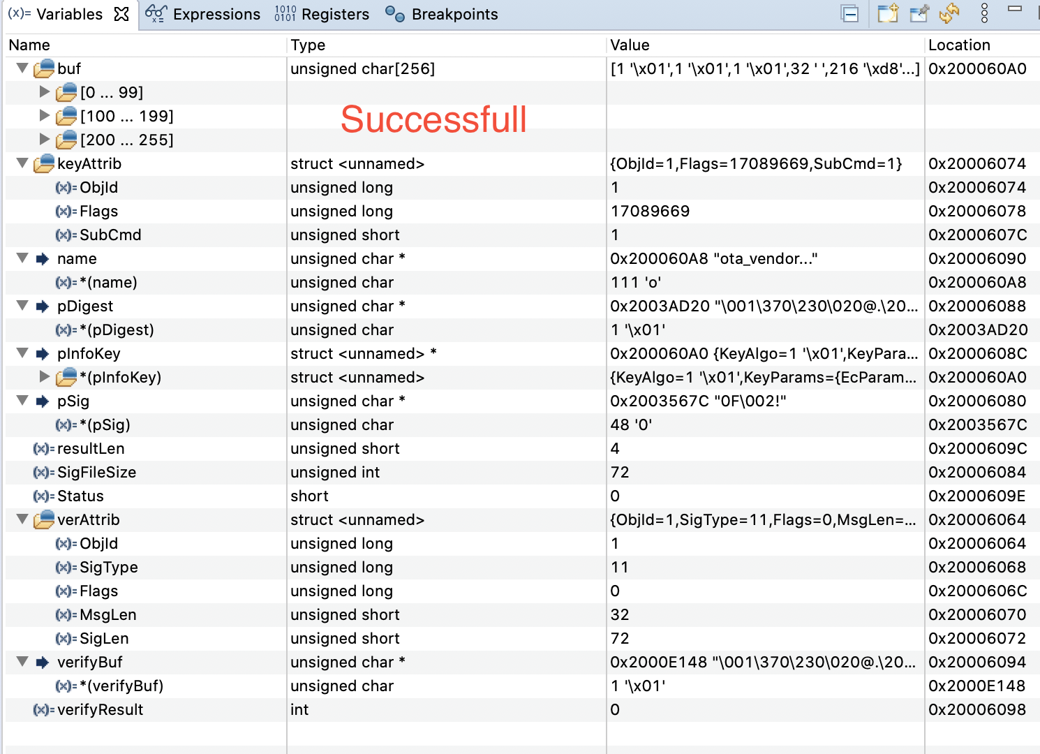

    Which I call upon case OTA_RUN_STATUS_DOWNLOAD_DONE only after having downloaded a .tar without a .bin. This seemed to work at first. I can repeatedly download files, however when I push a cc3220 .tar with a .bin this fails :
    int16_t verifySignature(char *pSig, uint32_t SigFileSize, uint8_t *pDigest)
    If I push a .tar with a .bin FIRST all is OK, but as soon as I perform a file download, subsequent cc3220 binary fail the signature. So there must be something that isn’t reset properly. Here are two screenshots, one with a fail and one with success. I can see pDigest is different and verifyBuf is different. It’s exactly the same .tar that is downloaded. I’m very close to getting it working, so any input very welcome.

    1) I download a sys/mcuflashimg.bin for the 3220. That logic starts and ends exactly how the OTA is intended to. It downloads, checks, mcu reboot, happy days.
    2) I download a tar that does NOT contain a sys/mcuflashimg.bin. for the sake of simplifying things lets forget about the 2538. Let's say the TAR contains an image with name blablabla.png.
    The changes I made in the OTA only apply to case 2. When the download is done the changes in the OTA code are meant to reset the OTA process because when the download is done I'm happy, I have my blablabla.png. Resetting enables the OTA library to perform another case 1 or 2 after the download is done of a case 2 without being stuck in an unfinished state.
    I can perform case 2 multiple times.
    I cannot perform case 1 after case 2 has been performed. The screen shots I've included in the previous post is the error when I perform case 1 after having performed case 2.
    In a nutshell, the changes I've made to the OTA library are to enable the download and check of a .tar WITHOUT a sys/mcuflashimg.bin.

    The OtaArchive_init() should reset all the relevant parameters.
    The only exception i can think of is the internalBufLen (in  _BundleCmdFile_Parse). Make sure it is being zeroed.
    It is supposed to get reset but if it is not you can make it global and reset it within OtaArchive.
