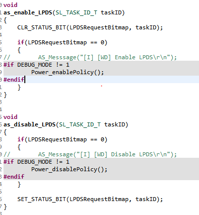

  • Hi Sarah,
    Let me check the return code and share it with you.
    below is the power configuration.
    I am calling the below functions to Enable and disable LPDS. But i am making sure that after calling PWM_start() the controller does not go into LPDS before i call PWM_stop().
    Other than this, can you comment on the correct order of calling the functions. What is the difference between PWM_stop() and PWM_close()? and when to call them?
