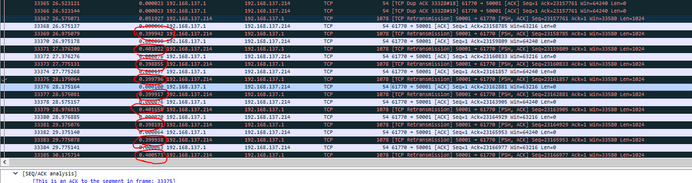

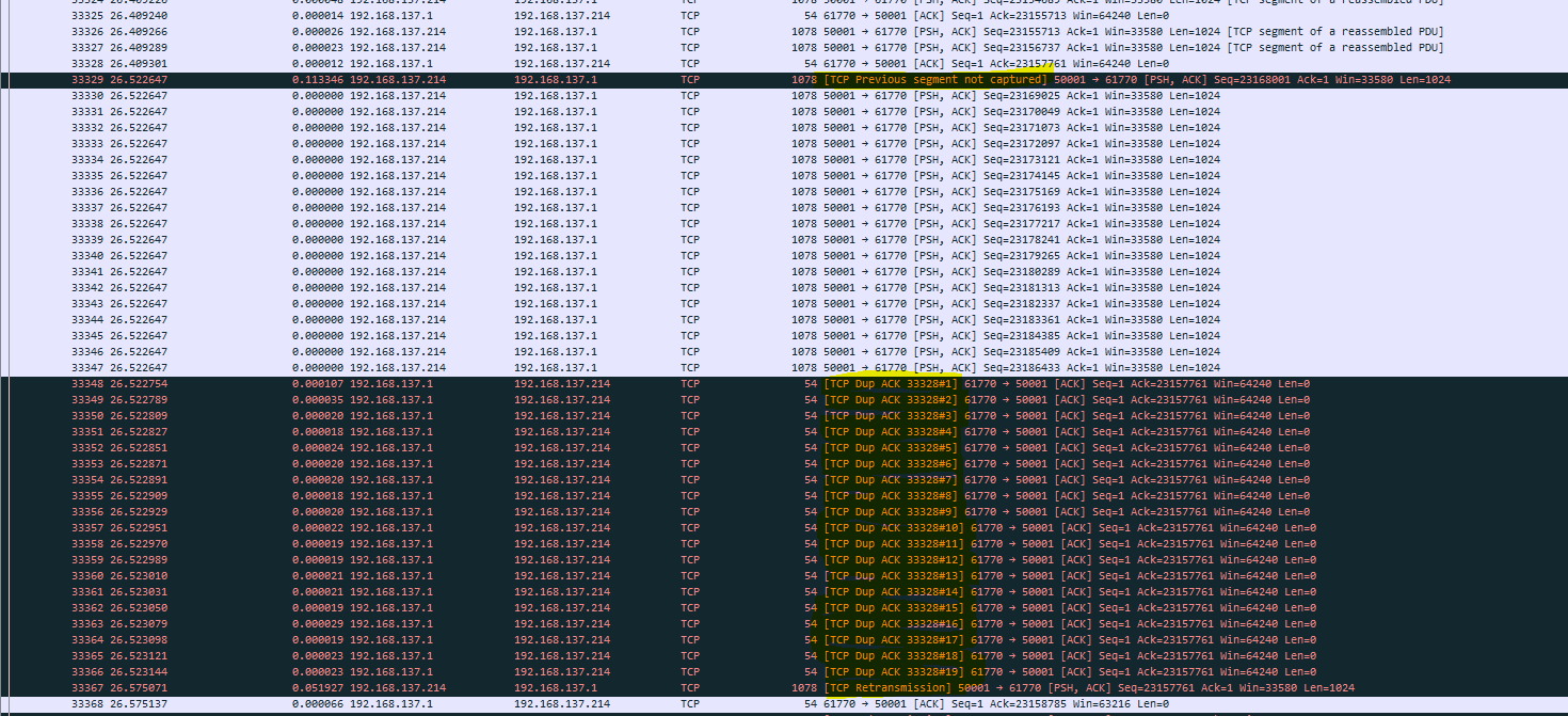

The problem is that sometimes (due to noise in my environment: I'm in a factory with inverters)
some packets are lost and Windows 10 send Dup ACK (duplcated ACK) to inform SimpleLink about his loss.
See image.
SimpleLink retransmits this lost packets ---> OK !!
But I observe that SimpleLink retransmits lost packet 400ms after ACK : this is a problem for my aplication !! See image below.
192.168.137.214 is SimpleLink.
192.168.137.1 is my PC.
This 400ms delay is configurable ? I wish it was under 10ms...
