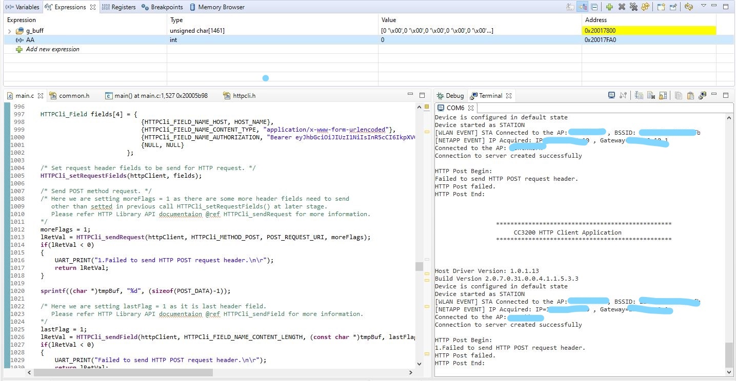

CCS/CC3200-LAUNCHXL: jwt Authorization.how much field header limit?
Part Number: CC3200-LAUNCHXL
Now I can get , post to local server so now I need to use jwt authen method but when server generate token I put in  HTTPCli_FIELD_NAME_AUTHORIZATION but got error at HTTPCli_sendRequest :Failed to send HTTP POST request header.But If I reduce token length it can post but invalid token. any one have a idea? if I want to use jwt.
