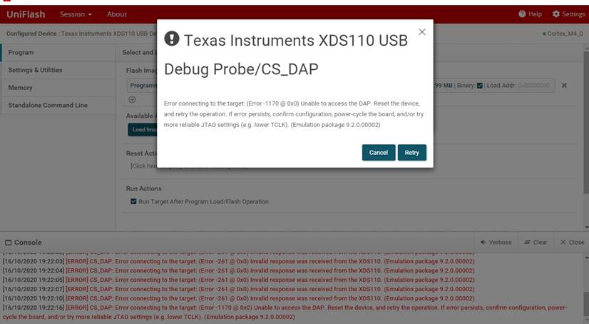

I intend to use the radio tool to perform the device certification, but I cannot download the image / firmware, the tool has the following error:

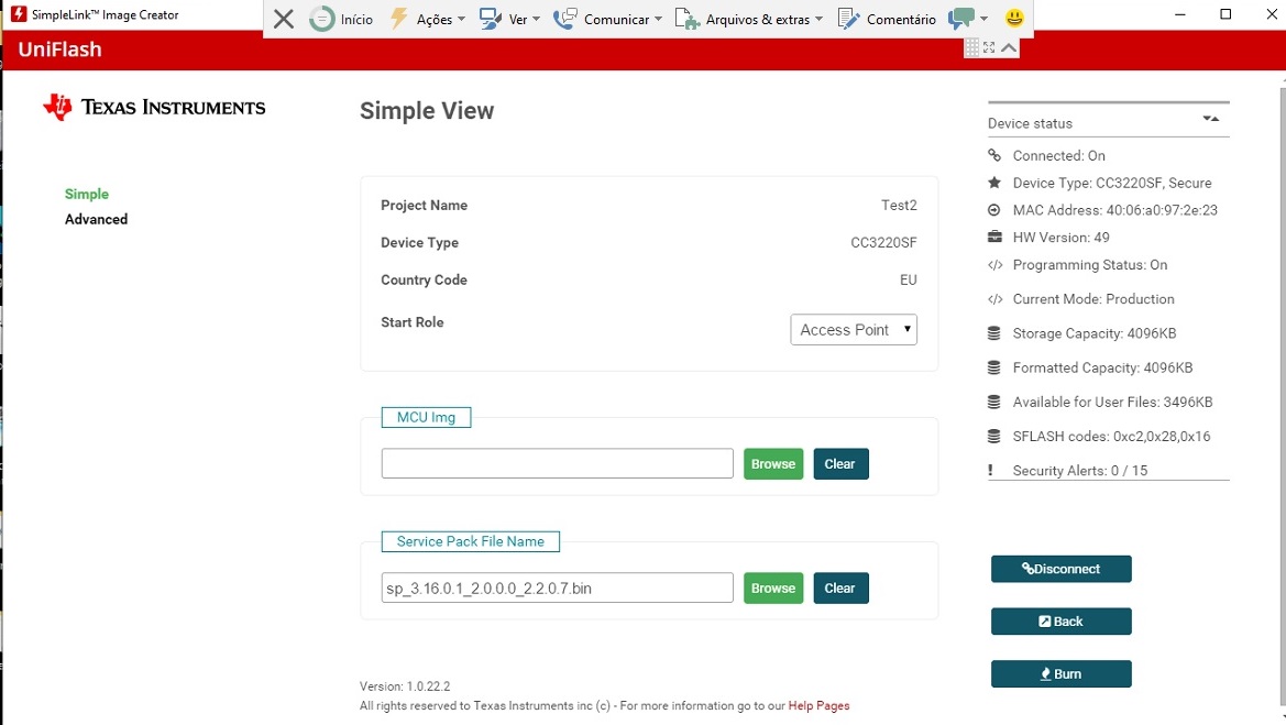

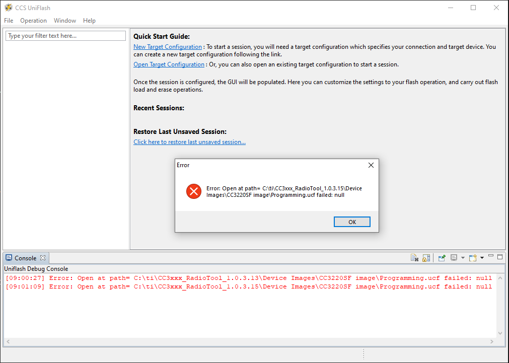

Hi Allan,
Jan is correct. You need to use a recent version of UniFlash ImageCreator for CC3220 devices. This lab will show you how to start a project and flash an MCU image (Programming.bin): https://dev.ti.com/tirex/explore/node?node=AH9w8QwBrpt-RLlf.VRAvg__fc2e6sr__LATEST
Sarah

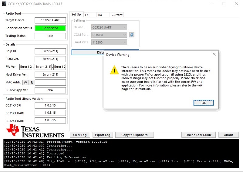

Hi Allan,
You also need to flash the application binary for the radio tool in addition to the servicepack. Please add Source Files/Precompiled Binaries/radiotool_CC32xxSF_LAUNCHXL_freertos_ccs.bin to the MCU Img box and program as you did before.
