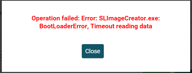

  • Hi Kobi,
    I got timeout error when I click "CONNECT" button. I believe it can't connect to the device.

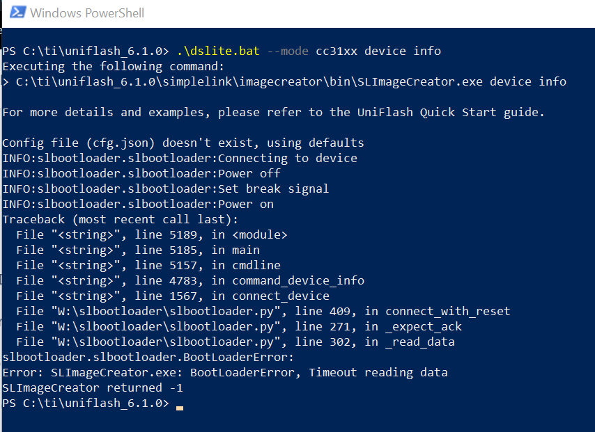

  • Hi Kobi,
    It is weird. I removed CTS/RTS/RESET connection. and I also scoped the nHIB line. It does go down when I click "Connect" in UniFlash GUI. But again, It failed to connect to CC3120 on those programmed boards. but, it connected to the blank board every time!
    here is error message:
    And I also tried command line with UniFlash. here is the message when I try to connect it and get device info:
