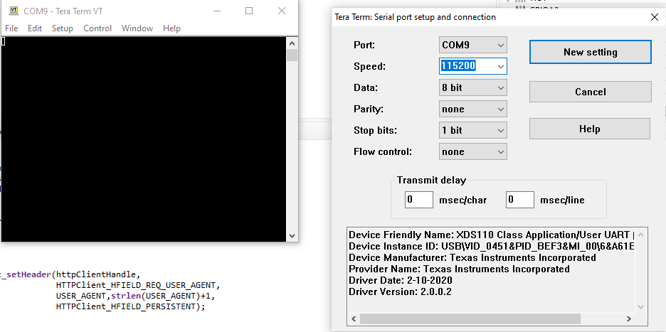

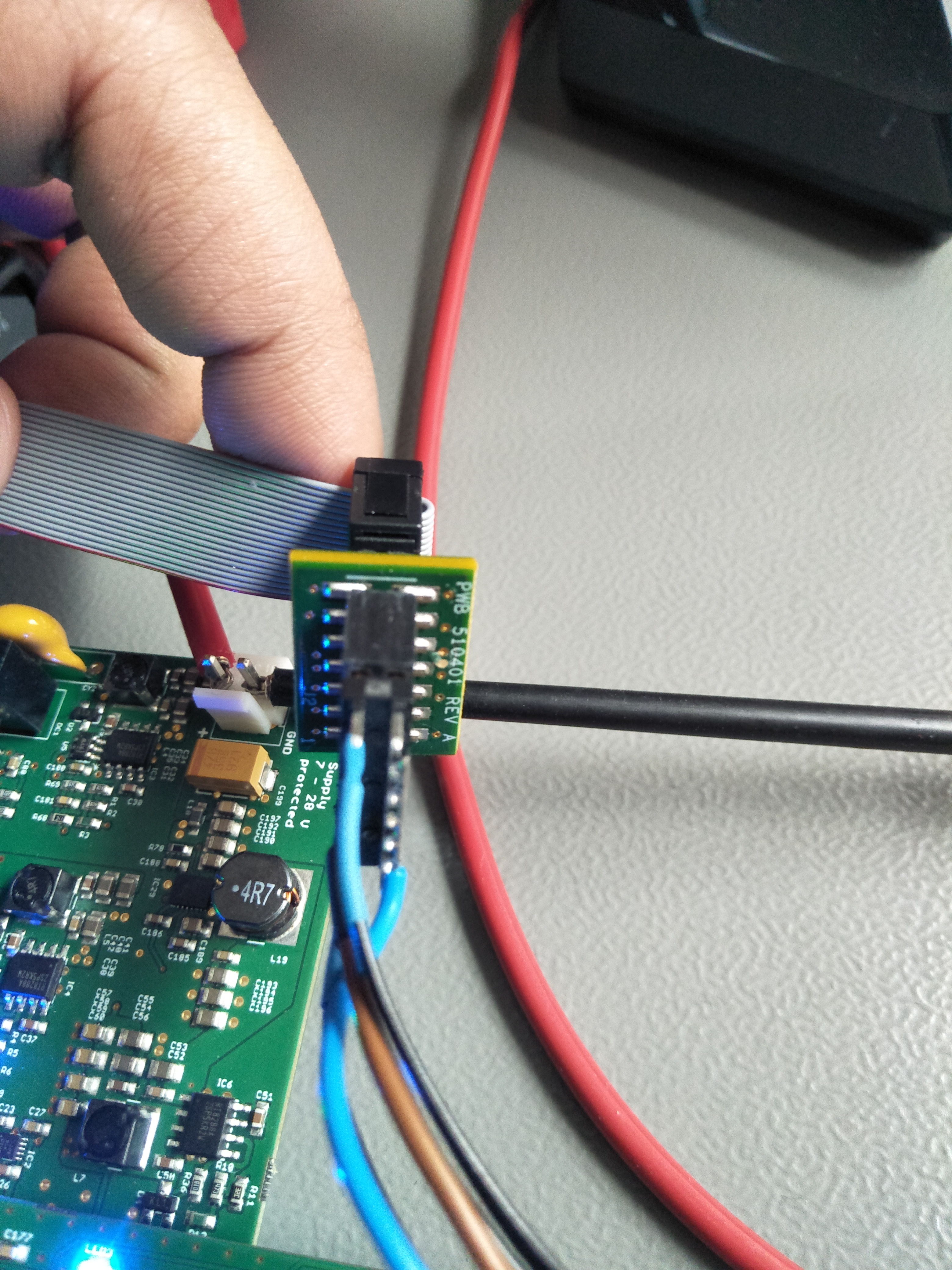

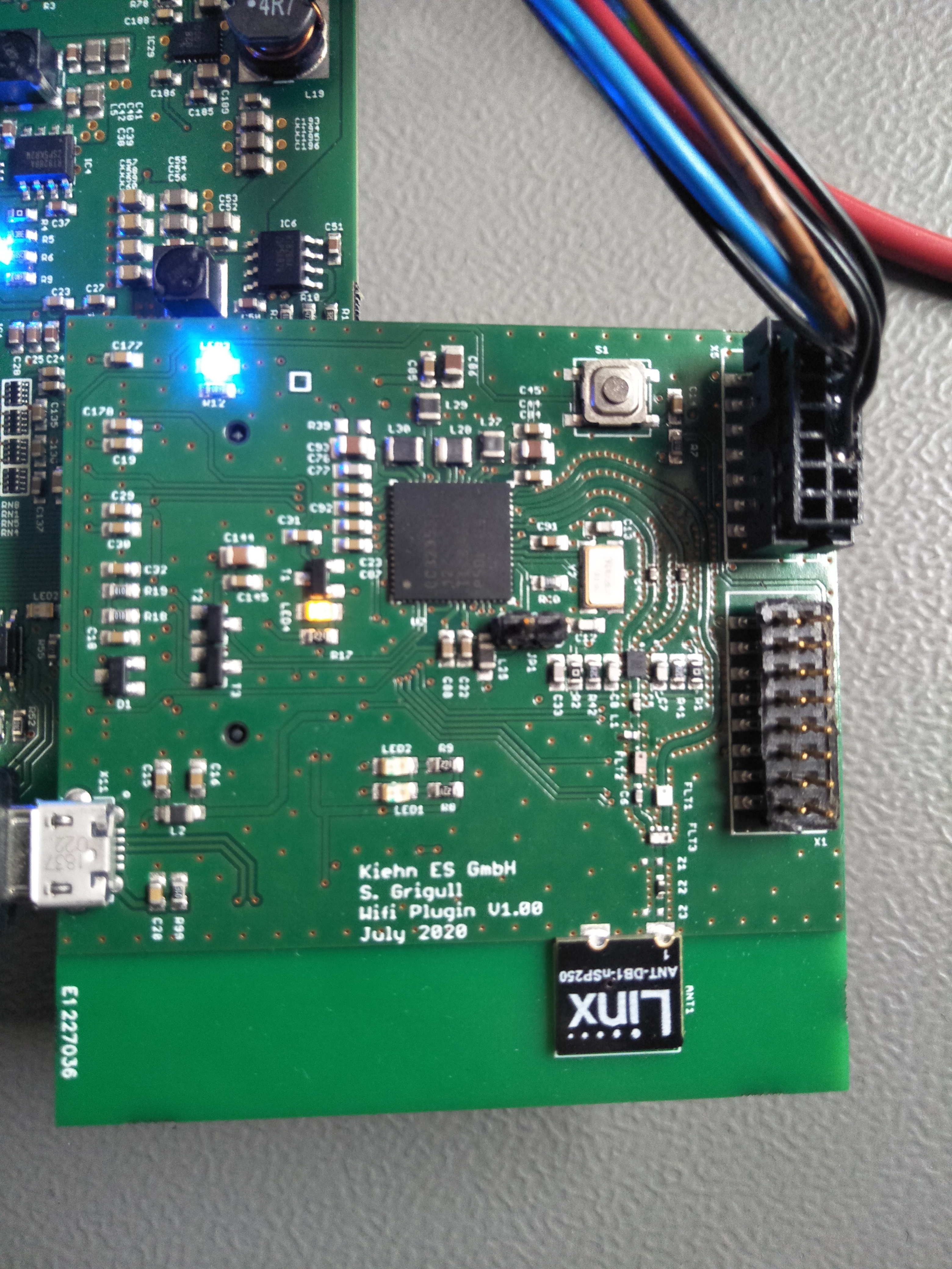

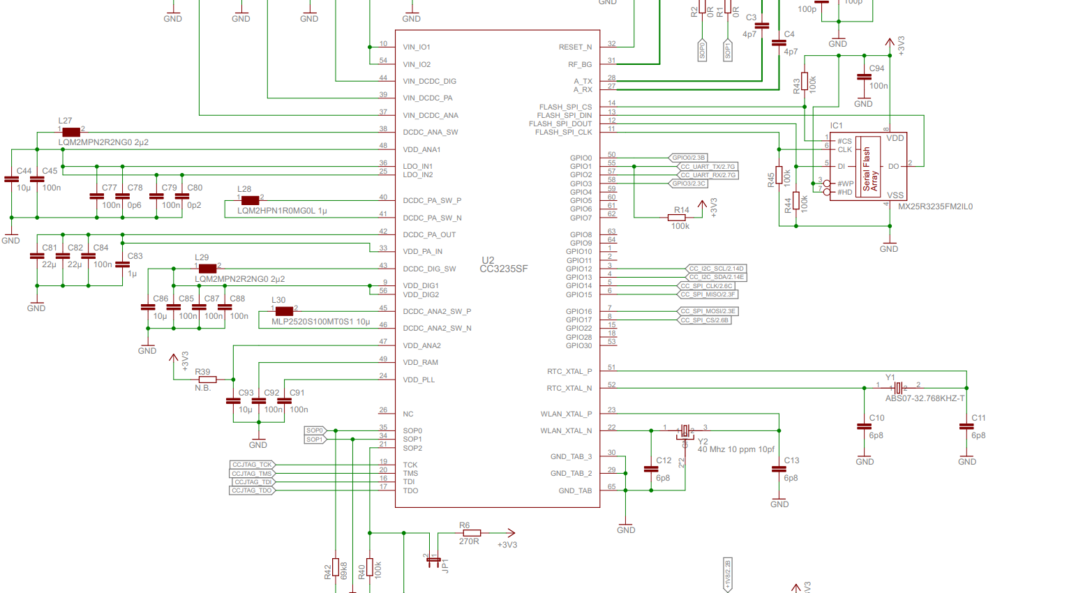

I have a CC3235SF custom board and was trying to import and run httpget SDK example but all is see is nothing either on Serial port of Tera Term or CCS Terminal.

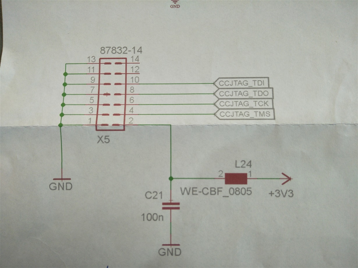

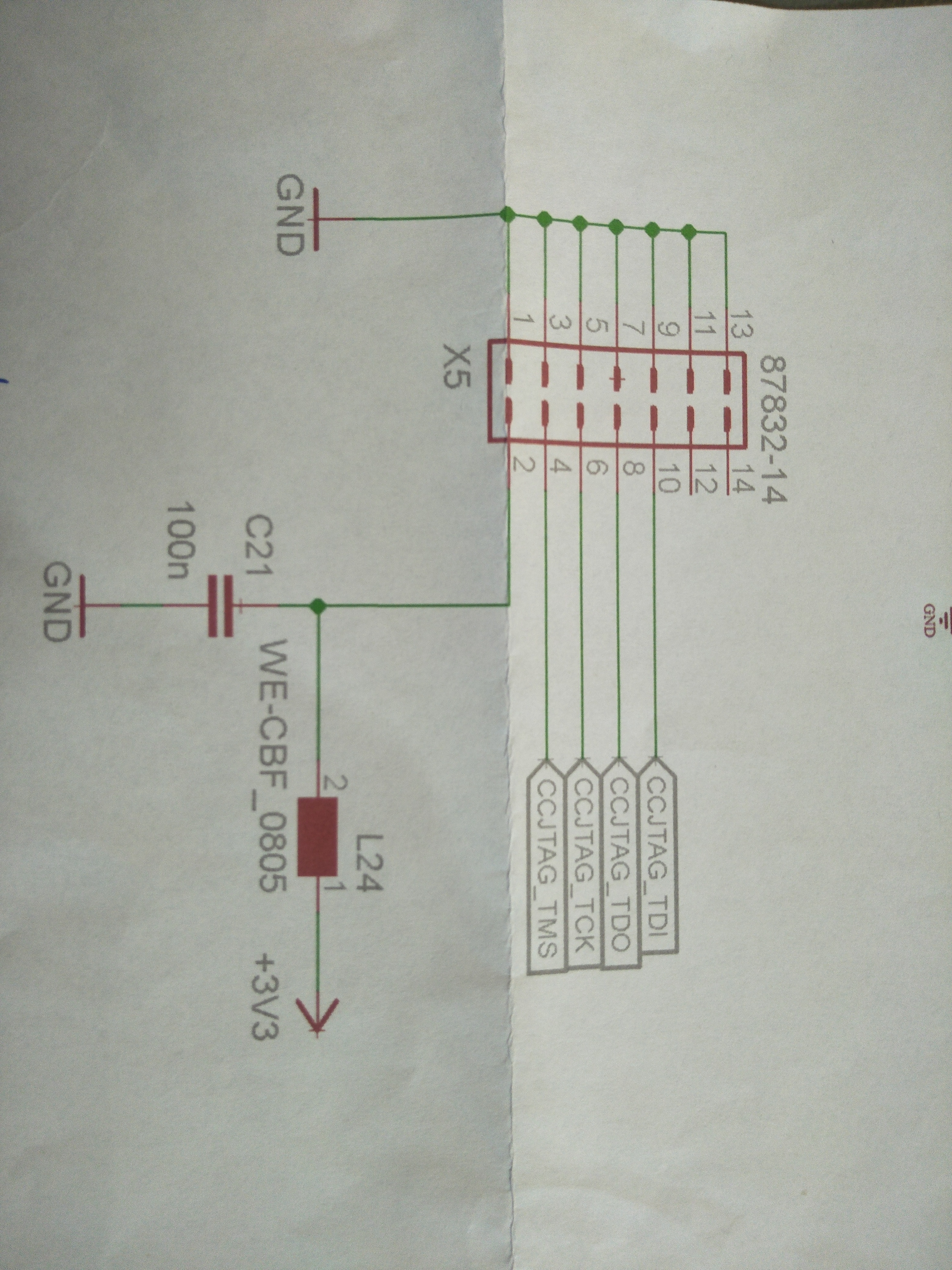

I have XDS110 debug probe. As the board is custom board, I did verify the schematics with TI Evaluation board and everything seems to be alright.

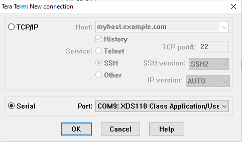

I did try other SDK examples and I see no output on the Serial port. Attached are pics related to setting up of connection with Tera Term.
Flashing has been successfully done using documentation from Uniflash.
Any help would be much apprieciated.
