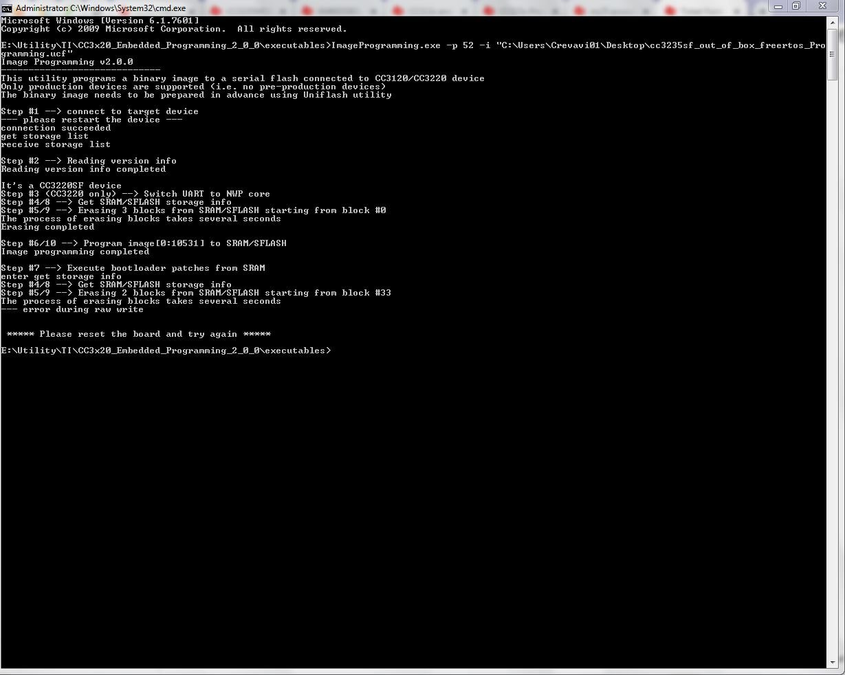

There is a particular tool available for CC3220 for UART programming "www.ti.com/.../EMBEDDED-PROGRAMMING".
Is there any same kind of tool for CC3235MODSF and not through Uniflash.
I tried programming the CC3235SF module using same tool but I'm getting error and the tool is reading the module as CC3220SF.

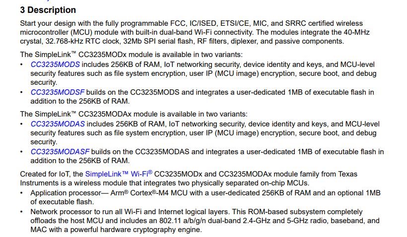

and also in the datasheet it is mentioned that there is 32Mb SPI Serial Flash in description.
Does the module comes with 32Mb of serial flash in addition to 256KB RAM + 1MB User Flash..?
