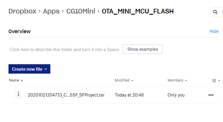

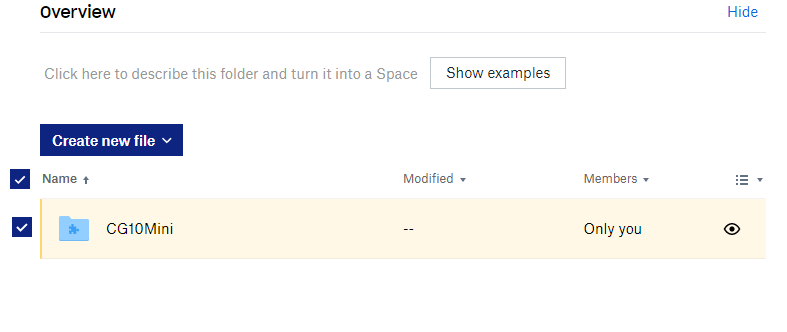

Here i am getting very anonymous issue, previously i was able to get OTA update using cloud_ota sample code, what i am trying to do now, i created new App over the Dropbox,

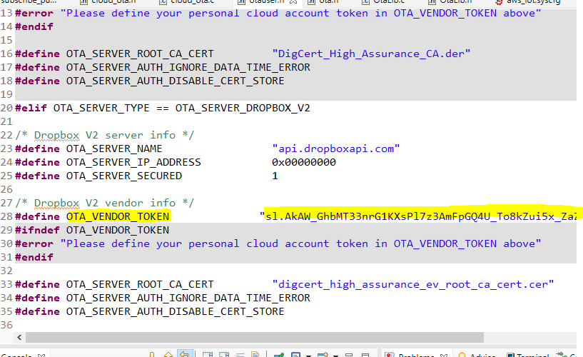

CG10 is the old App and CG10Mini is new one, old one is working well, and i have matched permissions of both of them as well. i download new generated token and updated in otauser.h file.
and my app is also ready..
now i created a new folder and kept .tar file inside it.
and i also changed directory name inside otauser.h file
#define OTA_VENDOR_DIR  "OTA_MINI_MCU_FLASH"
i build the code , first ota project and then my cloud_ota code no error at all. then i burned the code.

  • Hi Sarju,
    Thank you for your description. Very easy to understand what you are doing and the problem.
    Could you verify your project is referring to the correctly newly generated OTA library when you rebuild the OTA project? Also verify the library file is actually updating in the directory. It should have a time stamp that matches the time you built the project.

  • Hi Jesu,
    Thanks for reply, i did the same as you suggested. directory name issue has been resolved, now the issue is, i am not able to connect to the server.
