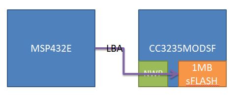

  • Dear Jan,
    Sorry for too simple and confused description.
    See below block, we want to use host MCU (like MSP432E) to direct access the sFLASH on CC3235MODSF by LAB addressing.
    As your previous reply, it seems our idea is wrong. CC3235x have no LBA access "without" filesystem.
    If we hope to let host MCU access directly to sFLASH, is anything to do this?
    If you have any suggestions, please feel free to let me know.
    Thanks a lot.
  • Hi Janet,
    Now your question is crystal clear.
    CC32xx devices does not have any interface which will allow to access internal XIP flash from external device. Access into XIP flas can be done externally via JTAG/SWD. These interfaces are intended for development purpose only - debug from IDE.
    If you want to do access into XIP flash from application MCU, you can use:
    • reading from XIP flash is possible directly because flash is mapped into address space of MCU
    • writing into XIP flash is possible via Driverlib API (\source\ti\devices\cc32xx\driverlib\flash.h) - see this.
    • additional information about XIP flash you find at TRM
    But ... writing own code directly into XIP flash is not practical. XIP flash at CC32xxSF devices is intended as execution flash. Content of XIP flash is loaded by ROM bootlaoder from sFlash (external SPI flash). There are some conditions when content of XIP flash is mass erased by ROM bootloder and you can lost your data written into flash.
    If your intention is about firmware update, you should to use way similar like is at OTA update code in SDK. If your intention is about production programming, you should care about writing into sFlash not a XIP flash (see production line guide). If your intention is writing into XIP flash via debug probe as some part of production you can check this.
