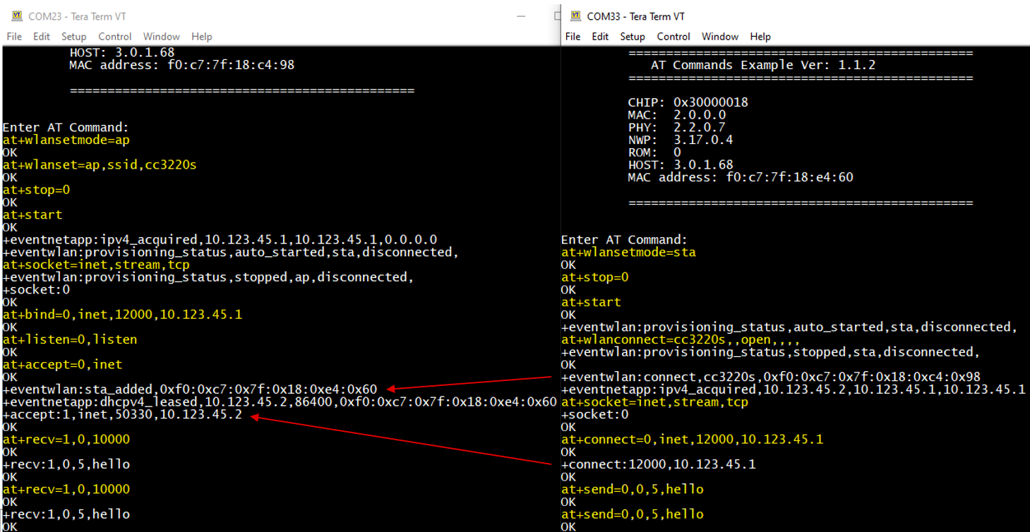

    2. I think the garbage data is the asynchronous event message. In my test on EVM I can get correct message. So this issue maybe relate to host side. Can we just disable the async event message? Is there a MACRO to disable it?
    Below is customer's test result, they type in AT+T and then a mobile phone connects to it, the garbage data shows up, after that they input est as a whole command "at+test", the device returns "OK".
    But in my test, as shown below, I didn't see the same thing. Compared to each other, we can speculate that garbage data should be async event msg.

    3. When station connect and disconnect AP,  at+recv will receive garbage data which is already under discussing. After comparing with Jo's test log, I think the garbage data is Asynchronous Events report.

  • Hi Jesu, Leanshaw,
    Just for record, I am not able to replicate those phenomenon from my side.
    In my test I didn't see the garbage data, so I think Leanshaw can provide captured waveform for further analysis. As for baud rate other than 115200 bps, I am able to work at 1Mbps rate without problem. However 3Mbps seems too aggressive and need further optimization for handling data traffic, I would recommend Leanshaw using 1Mbps and keep the ball rolling.
