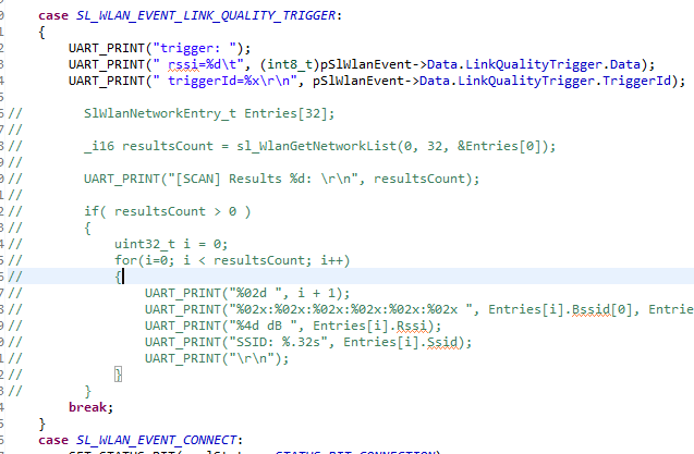

  • Part Number: CC3235MODSF
    I have a printout of san results  (sl_WlanGetNetworkList) in SimpleLinkWlanEventHandler when the LINK_QUALITY_TRIGGER event.
    Scan interval is at default value.
    Trigger interval is 5000ms.
    Normally [SCAN] Reulsts shows 10+ SSIDs with RSSI values but sometimes after a while I get the following result and it stays that way:
    [wifi] SimpleLinkWlanEventHandler SL_WLAN_EVENT_LINK_QUALITY_TRIGGER rssi=-66 TriggerId=1
    [SCAN] Results -2073:
    [wifi] SimpleLinkWlanEventHandler SL_WLAN_EVENT_LINK_QUALITY_TRIGGER rssi=-65 TriggerId=1
    [wifi] SimpleLinkWlanEventHandler SL_WLAN_EVENT_LINK_QUALITY_TRIGGER rssi=-64 TriggerId=1
    -2073 is an undocumented error code behind this define: SL_ERROR_WLAN_GET_NETWORK_LIST_EAGAIN
    Could someone explain me what is happening and why?

  • Are you working off of a modified SDK example? Could you provide me code to reproduce this issue?
    Jesu
  • Yes the basis was an example project that I modified over weeks.
    Setup/init code:
        SlWlanRegisterLinkQualityEvents_t RegisterLinkQuality;
        RegisterLinkQuality.Enable = 1;
        RegisterLinkQuality.TriggerId = 1;
        RegisterLinkQuality.Metric = SL_WLAN_METRIC_EVENT_RSSI_BEACON;
        RegisterLinkQuality.Direction = SL_WLAN_RSSI_EVENT_DIR_LOW;
        RegisterLinkQuality.Threshold = -65;
        RegisterLinkQuality.Hysteresis = 1;
        RegisterLinkQuality.Type = SL_WLAN_RX_QUALITY_EVENT_LEVEL;
        RegisterLinkQuality.Pacing = 5000;
        status = sl_WlanSet(SL_WLAN_CFG_GENERAL_PARAM_ID,
                            SL_WLAN_GENERAL_PARAM_REGISTER_LINK_QUALITY_EVENT,
                            sizeof(SlWlanRegisterLinkQualityEvents_t),
                            (_u8*)&RegisterLinkQuality);
    Eventhandler:
    void SimpleLinkWlanEventHandler(SlWlanEvent_t *pWlanEvent)
        // pWlanEvent->Id, look for "SlWlanEventId_e"
        switch(pWlanEvent->Id)
        case SL_WLAN_EVENT_LINK_QUALITY_TRIGGER:
            int8_t rssi = pWlanEvent->Data.LinkQualityTrigger.Data;
            UART_PRINT("[wifi] SimpleLinkWlanEventHandler SL_WLAN_EVENT_LINK_QUALITY_TRIGGER");

    Thank you for providing this code. You should not be calling sl_WlanGetNetworkList inside your event handler. It is safer for you to signal a task from the event handler that will call sl_WlanGetNetworkList. I'm surprised it's even working for you at all. Out of curiosity I tested your code and kept on getting HW fault for calling sl_WlanGetNetworkList inside the event handler. I made some slight optimizations but it's basically your code. If I uncomment the sl_WlanGetNetworkList call I will get a hard fault error in my code. I'm still trying to figure out the cause because I get the hard fault before the code even calls sl_WlanSet to enable link quality events. But I know it has to do with sl_WlanGetNetworkList because if I comment it out the code runs fine. I will get back to you on this after I get feedback from another engineer. Anyway, you should try handling this outside of the event handler. Create a task, a semaphore and signal the task from the link quality event.
    With this code the trigger is working fine for me. I had to drop the threshold to -40 since my AP is closer to me but the results is the same. This is my terminal output when I comment out the sl_WlanGetNetworkList call:
     It just goes on....
    trigger:  rssi=-58       triggerId=1
    trigger:  rssi=-57       triggerId=1
    Let me know how it goes.
    Jesu
