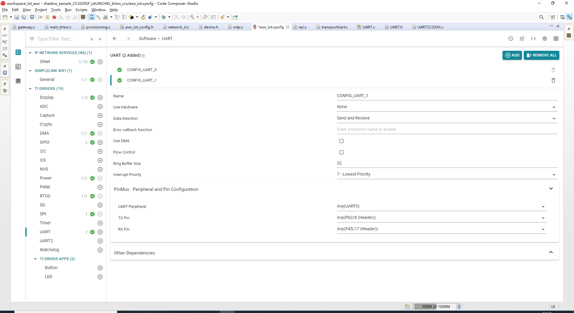

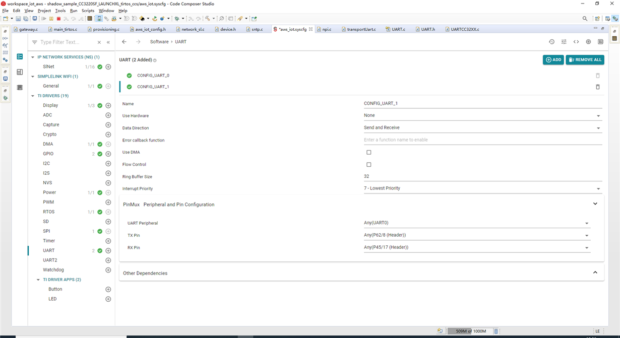

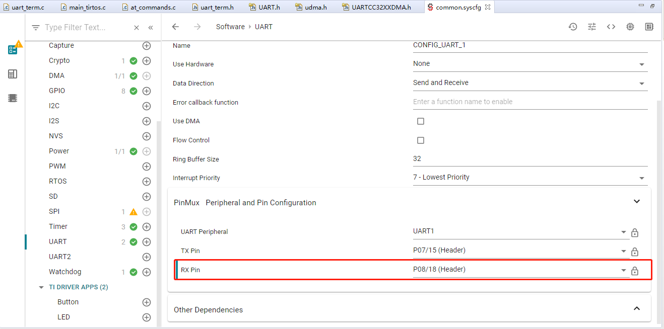

CCS/CC3220SF-LAUNCHXL: when I use the CONFIG_UART_1,I can only send data,but can't receive any data in my readcallback.
Part Number: CC3220SF-LAUNCHXL
Other Parts Discussed in Thread: SYSCONFIG, CC3220SF,
SDK:simplelink_cc32xx_sdk_4_10_00_07 CCS:Version: 10.0.0.00010 ;
CONFIG_UART1 _0,pin is p45 and -62,configerd by sysconfig; only can send ,but can't receive any data!
    No this is not possible. Please see schematic for your LaunchPad. Pin P45 is not connected at CC3220SF LaunchPad and cannot be used.

  • Hi Jan,
    At present, in CCS, UART can only be added through sysconfig. When UART is added, only P45 can be selected in sysconfig pinmux, and other options will conflict. What should I do if I want to add UART?

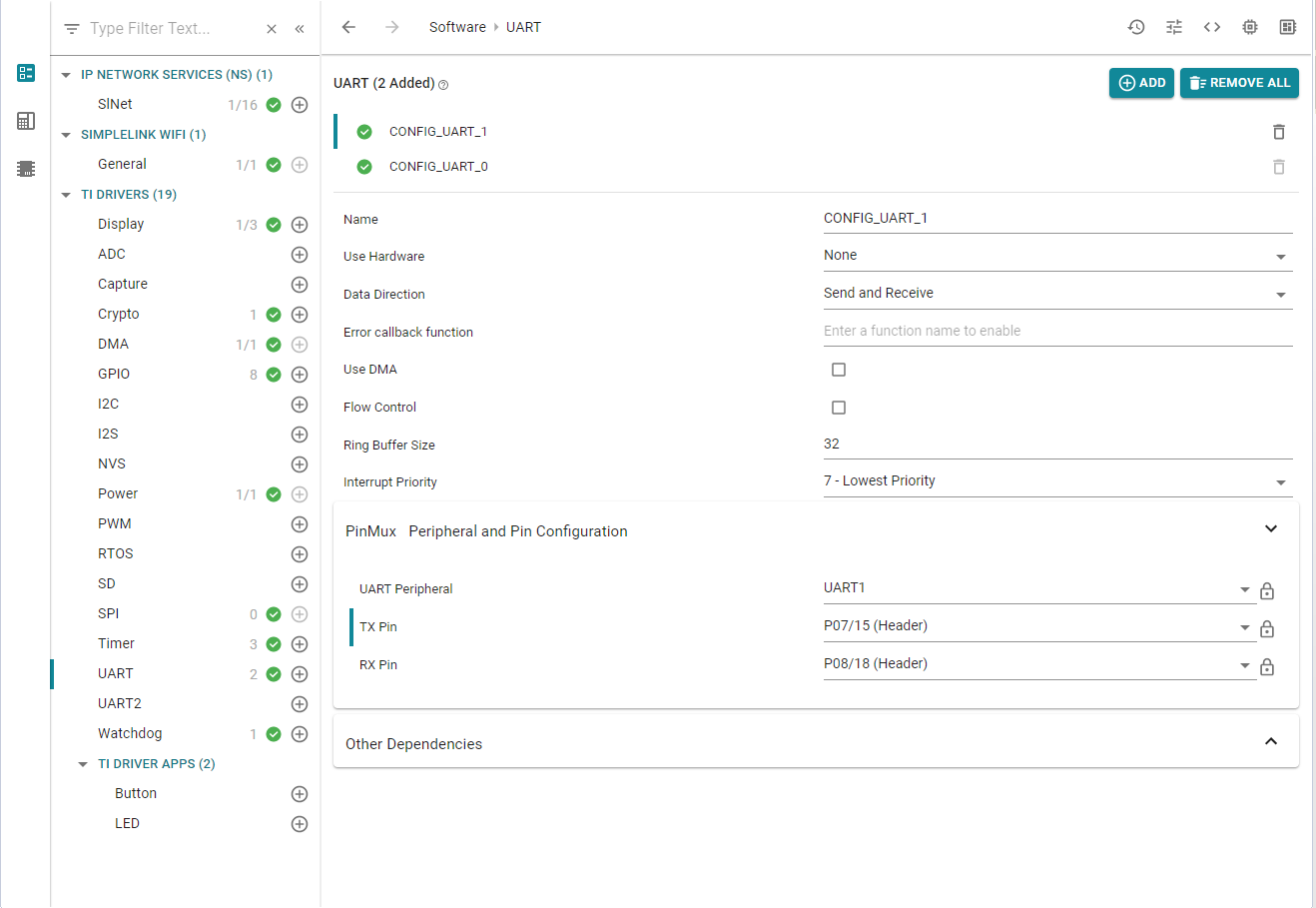

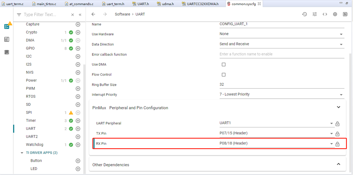

  • Hi Jan,
    Now,I use UART1,RX with P8;
    but I can't receive any data still!

    UART1 Config:

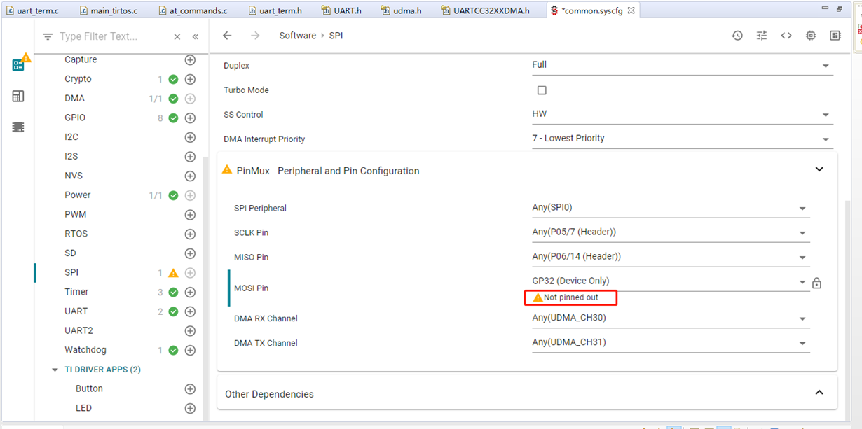

    Sorry, I am not able test your setup but according image above this cannot work because you have conflict at your SPI (likely P8 GSPI_CS).
    Jan

  • Hi Zhao,
    Sorry no. I don't have installed version of CCS which supports Sysconfig (I use version 8.3). But if SPI is not used at your code, you can remove this peripheral and after that test your UART code.
    Jan

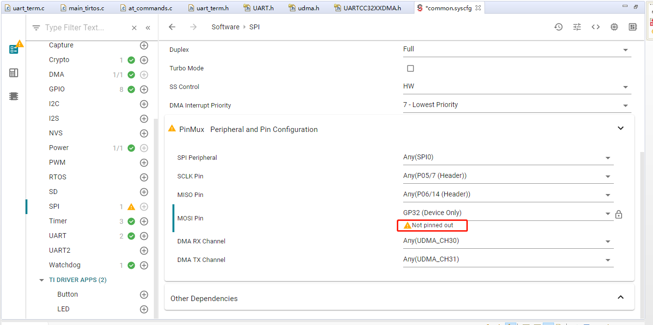

  • Hi Jan,
    If I remove SPI,some errors will be appear!

  • Hi Jan,
     The following configuration of SPI should not affect the function of Rx(P8)?
    No. You cannot remove both SPI peripherals, just remove GSPI (SPI for application processor). Connection between application processor and NWP (network processor) is done via SPI. In case of removing this interface you will not be able use sl_ API calls via host driver.
    update: I don't think so that such setup of SPI can affect P8 RX UART pin.

  • Hi  Jan,
    Now ,I have remove GSPI,and the uart pinmux config is ok; but I still can't data! Can you help me?
    Unfortunately without deeper debugging of your code I am not able help you with this. Can you try to check SDK demo uartecho reconfigured to UART1?
    btw ... you are using old SDK. Can you update to latest version (4_30_00_06). Just for a case...
    Jan
  • Hi Zhao,
    It looks like you have UART readmode configured in callback mode, but you do not provide a callback function. In callback mode, UART_read() is non-blocking, so you should see zero bytes returned from the API. The number of bytes will be returned to the callback function once the specified buffer is filled.
    For your code snippet, it looks like you should keep the default readMode = UART_MODE_BLOCKING.
    See the UART TI Drivers documentation in the SDK docs folder or the uartecho demo in the SDK examples/drivers folders.
    Sarah
  • Hi Sarah,
     Thank you for your help,Now it's ok~
    Zhao
