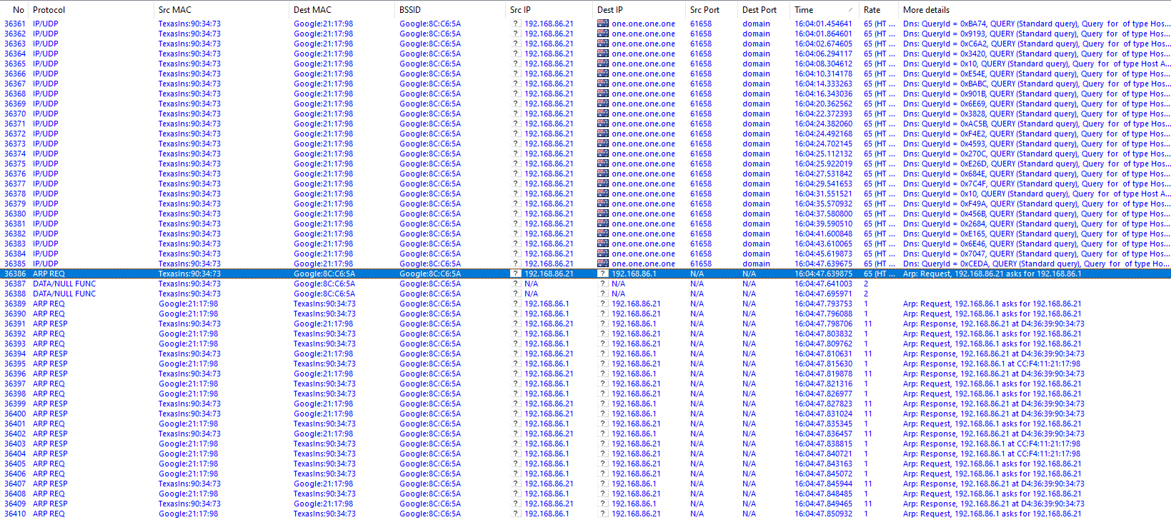

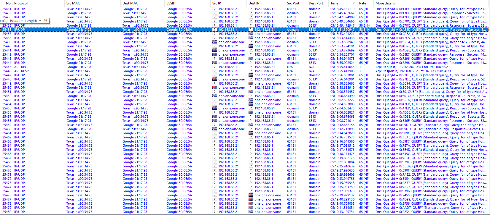

  • Hi Michael
    Thanks for the insight.  I did reproduce the problem with a WiFi sniffer, and the DNS queries go off the NWP to the router but we do not receive any packets back with the DNS response at the NWP level.
    However, further upstream, at the router to the DNS server layer, I can see this:
    The DNS Response does come back from the server to the Nest Mesh Router, but then the Router reports to the DNS server an ICMP error (even though it should be expecting this packet).  So it seems like the router is eating the packet and not passing it along to the device...

  • Hi Michael.  Thanks for the idea.  I will implement and test the ARP request from CC3220 to router this morning.
    Interestingly enough, with the WiFi Packet sniffer, at the beginning of the failure case I do see a flurry of DNS requests with a DNS response from the AP, however this does not seem to stop the DNS queries from continuing from the CC3220.  Then after a bit an ARP request and response goes out, and then the DNS responses stop coming.  Not sure that provides us any info but in theory the router should have it's MAC address due to that.  Also, it seems like the CC3200 should just accept the first DNS response and stop sending further requests?
