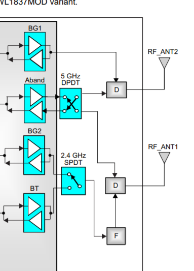

    The antennas are backwards when comparing to the RF path - Please review our datasheet, and I've also attached the block diagram for reference.
    It looks like you were able to get RF output on ANT2. Please let us know if you have any other questions.

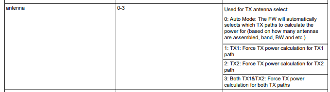

    I mean, when customer sets parameter of “set_tx_power Command” to “1”, customer confirmed RF-output on ANT2. when customer sets parameter of “set_tx_power Command” to “2”, customer confirmed RF-output on ANT1. I attached customer’s verification prompt-log(1321.logs.zip).
    According to “Calibrator Tool User's Guide 3.4 Set TX Power (https://www.ti.com/lit/ug/swru562/swru562.pdf)”, antenna parameter is defined as follows.
    I’m not sure if TX1/TX2 is related to ANT1/ANT2. However, when customer set antenna=1 (TX1), customer is able to see RF-output on ANT2. when customer set antenna=2 (TX2), customer is able to see RF-output on ANT1.
    Would you expect this behavior?

  • Hi Vince,
    First of all, regarding the antenna parameter of “set_tx_power”, Can we have your Expert’s comments on this, please?
    when customer set antenna=1 (TX1), customer is able to see RF-output on ANT2. when customer set antenna=2 (TX2), customer is able to see RF-output on ANT1. Therefore, I believe that TX1 means BG1(ANT2) and TX2 means BG2(ANT1). If so, that makes sense. Would you clarify it, please? sorry for rushing you..

  • Hi Miyazaki, sorry for the delay.
    Yes the antenna and RF paths are swapped - please review the block diagram i attached previously. RF (BG and A) Path 1 corrosponds to Ant 2 and RF path 2 is Ant 1.

    I shared your comments with customer. For 2.4GHz, customer said, they were able to understand antenna configuration. the remained inquiry is 5GHz output.
    For 5GHz RF-out, however, when customer set antenna=1 (TX1) on calibrator command, RF signal is outputting on BG2(ANT1). Also, when customer set antenna=2 (TX2) on calibrator command, customer said, they are not able to see RF-signal on both ANT1 and ANT2. I’m asking customer what calibrator command customer tried to do. For 5GHz, would you think that this calibrator command is not able to support RF-output on ANT2 ?
    According to the block diagram which you mentioned, I believe it supports this. can I have your Expert’s advice/comments on this, please?
    If you will be able to share example 5HGz RF-output script. It will be really appreciated.
    Best regards, Miyazaki
