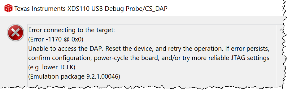

CC3220SF-LAUNCHXL: TI-RTOS version of Hello...from TI-Resource Explorer will not connect to target: error is "Error connecting to the target: (Error -1170 @ 0x0) Unable to access the DAP"
Part Number: CC3220SF-LAUNCHXL
Other Parts Discussed in Thread: CC3220SF, UNIFLASH, SYSCONFIG
CCSv10.1.1 SDK 4.30, LP version RevA, Silicon version: CC3220SF, 12, TI 71J, PDCY G4
This worked with previous versions of CCS and SDK just fine. When I connected my board just after updating to CCSv10.1.1, CCS asked me to update the firmware on the CC3220SF launchpad. I did - as I do with all Simplelink launchpads when requested to do so. No worries. I mention it here only because it was a variable in the equation.
I have power-cycled the board, reset the board, re-invoked CCS, power cycled my laptop, used two different USB cables, hard reset of board, all of the above. Still the same error:

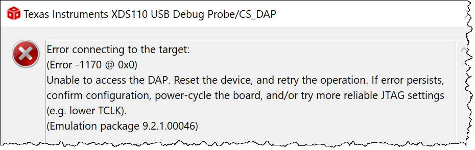

Here is the error:
One other person (co-worker Scott Specker) has the same board and SDK and is getting the same error also.
Do you have any suggestions for us to try to get connected to load a program? The reason I used the hello program from Resource Explorer was to remove any possible variables with my project and ccxml file.

    -1170 is typically the error CCS runs into when the JTAG on the CC32xx is locked. That happens when the device is in "Production Mode" rather than "Development Mode". You can put the device in Development Mode by reprogramming it with our UniFlash ImageCreator tool.
    Please see instructions for this in our SimpleLink Academy training here: https://dev.ti.com/tirex/explore/node?node=ABEoqU9o3snoxDcmIpW0EA__fc2e6sr__LATEST
    Give that a go and let us know if you're still having issues.

  • Thanks, Ben, that solved the problem. It would have been nice if the Error message provided a bit more information... or a link to this solution. Searching for "Unable to access DAP" wasn't very useful but in hindsight, searching for CC3220 with Error 1170 came up with a couple of E2E posts that led in the right direction.
    Going through the suggested solution, SimpleLink Academy suggests using Uniflash Cloud but that gives the error:
    "Error: CC3220 Image Creator is not support on the Cloud. Please download the Desktop version."
    Besides the obvious grammar error, it looks like the Cloud won't help us solve the problem. After installing the desktop version, things went smoothly at first. Towards the end of the process, though, where the tool asks for an "MCU Img", I was confused as to what was needed. At first, I tried one of the CC3220 bin files I had created - but then ran into the next error about "wrong device type". In the end, I found that we can just leave the "MCU Img" blank. It would be helpful to state that in the SA instructions.
    When I clicked "Burn", though, it showed a dialog that said:
    "Wrong Device Type" with buttons for "Program" and "Abort".
    I couldn't figure out how to fix this error. I backed up a few times trying different things but with no luck. In the end, I just clicked "Program" to give it a try... and that seemed to work. After this process, my device was left in Development mode and I was able to go back to CCS and continue debugging as expected.
