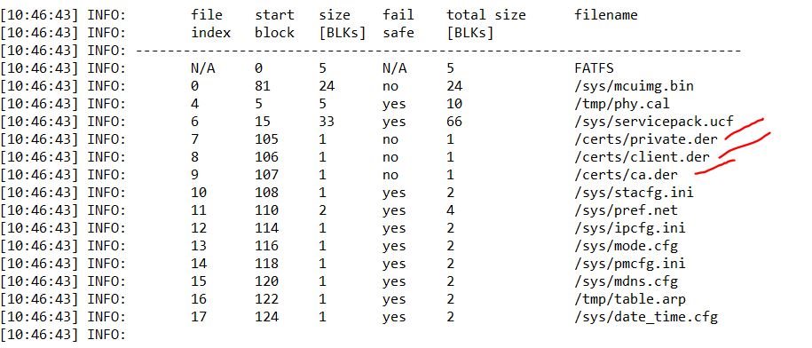

  • Got it. After correcting the path to the certificate. I get the following error.
    Connect to AWS Broker
    ERROR: Could not establish connection to server.
    ERROR(#-155): Closing the socket.
    Broker connect fail for conn no. 1
    Exiting the Application.
    I have also attached below image to indicate that all certificates are in .der format.
  • looks like the rootCA you provided (in the reference mqtt client example check the definition of SL_SSL_CA_CERT in the mqtt app's main.c) is not the right root CA for verifying the server.
    Please make sure you use the right root CA for the AW server.
    https://docs.aws.amazon.com/iot/latest/developerguide/server-authentication.html
    Br,
    Kobi
