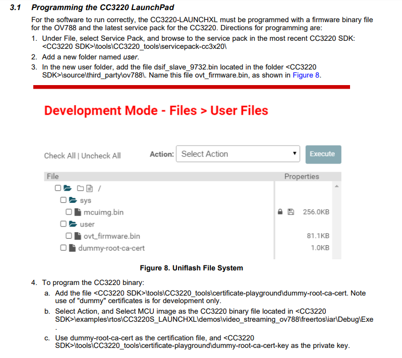

    Thanks for your attention, I will use my camera with SCCB interface. In the other hand I want to use video streaming demo with the LAUNCHXL-CC3235SF board. But video streaming demo was done with LAUNCHXL-CC3220 board.
    I'm following these below steps with CC3235SF LaunchPad and I'm programing the board with no error, but it doesn't work. Is there a possibility to work appropriately or what should I do?
    Talha
  • Hi Talha,
    Do you have the OV788 hardware? Have you added a servicepack? Note you will need to use the CC3235 servicepack from the servicepack-cc3x3x folder.
    Sarah
  • Hi Sarah,
    I don't have the OV788 hardware. I added appropriate servicepack from the servicepack-cc3235x folder. Before getting OV788 hardware, I just want to see the communication between the LAUNCHXL-CC3235SF with the network. If I connect my board with the network I'll try my camera module with SCCB interface.
    Also I copied OV788_Video_Streaming source and example folders to the mentioned folders to execute the demo. The result is always same, not working.
    Is this demo featured with only CC3220-LaunchPad? How can I run it with LAUNCHXL-CC3235SF?
    Talha
  • Hi Talha,
    That demo waits for the OV788 hardware to initialize before it connects to a network or sends data. It will not run on your LaunchPad alone unless you change the application.
    If you want a demo to see how the CC3235 connects to a network and sends data, I suggest starting with one of the SDK examples. There are many basic Wi-Fi demos in SimpleLink Academy, like the network_terminal demo.
