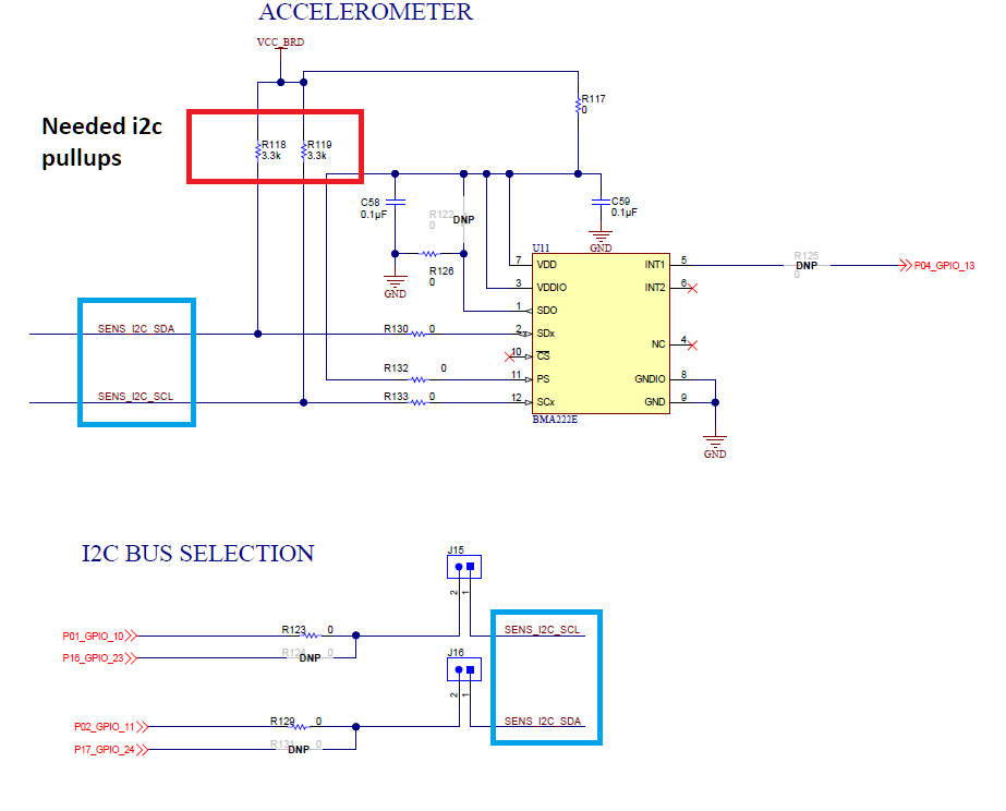

    Also, do you have pullups on the I2C lines when you are connected to your I2C slave? The jumpers that you are using, J15 and J16, are you connecting your I2C slave directly to pin2 of those jumper (the side connecting to the CC3220)? If so you will need to provide the pullups.

    I connected the I2C slave directly to the pins J15 and J16. Can I get the schematics for connecting the pullups?

    The CC3220 launchpad schematics can be found here; https://www.ti.com/lit/zip/sprcag0
    On page 5, there is a diagram of the I2C signal routing on the CC3220 launchpad. I've copied the relevant parts here:
    The pullups are after the J15,J16 jumpers, so you will need to keep those connected. If you keep the jumpers in place while having your I2C slave connected, are you still seeing the same issue?

    But actually when I keep the jumpers in place and run the I2C sample "i2ctmp_CC3220SF_LAUNCHXL_tirtos_ccs" I got the same problem.

  • Hi Ariel,
    Please probe the I2C lines with an oscilloscope and provide captures of the signal when you run the i2c example code.
    If the I2C clock is low, it may be stuck. The I2C slave device work as state machines and may be blocked if the CC3220 was reset before sending a stop condition.
    If this is the case, an easy solution you can implement is to toggle the clock multiple times before doing any I2C operations after the CC3220 powers up.
