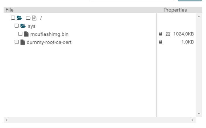

i have some questions related to the cloning protection and the encryption of gang_images and unpacked images.
* Is Cloning protection always active ?
* If an production image created with uniflash and flashed via spi programmer to s-flash is save in terms of the information inside the image ?
** This means if i have flashed the gang image and then bootloader has unpacked the image and if i then read it back could i extract sensible information about the software ?
*** Like some private keys which are placed in it? I think information in there is only save if i use my private certification chain with everything what's needed.
*** Whats about certificate updates if a certifcate is invalid or unsecure and i want to update that and things in field are only having OTP information as they left our production ?

  • Private information (such as private keys) can be stored as secure files.
    The MCU image is always stored as secure file.
    Once the bootloader extracts the gang image, it will create the FS where all the secure files are encrypted using unique device key.
    This will prevent the cloning threat (the content can only be decrypted by the the same device that encrypted it).

    in addition setting the dummy-root-ca-cert as secure won't be successfull because it has to be unsecured. So this file could be read back even after unpacking loaded gangimage thorugh nwp and securing file system right ?
  • Hi i think there is a bug in my thoughts.
    dummy-rootca-cert is the public key so it could be used for verifiyng not for signing right ? So it could be left there unsecure. mcuflashimg.bin will be encrypted by UDID of NWP so it is safe.

  • The cloning protection is always enabled.
    The OTA process assumes that both the server is secure (so you private file can't be accessed by others) and the data transfer is secure (i.e. using SSL/TLS).
    Those are basic requirements from an OTA server.
    Once the image is loaded to the device, the ota library parses it and stores the secure file encrypted.
    Public keys can be stored without security.
    Note that the dummy Playground certificate are just for development and should not be used in production (as everyone has access to the private keys).
    The communication between the HOST and the NWP is not encrypted, but this is not a problem in CC32xx devices as this SPI is not exposed.
