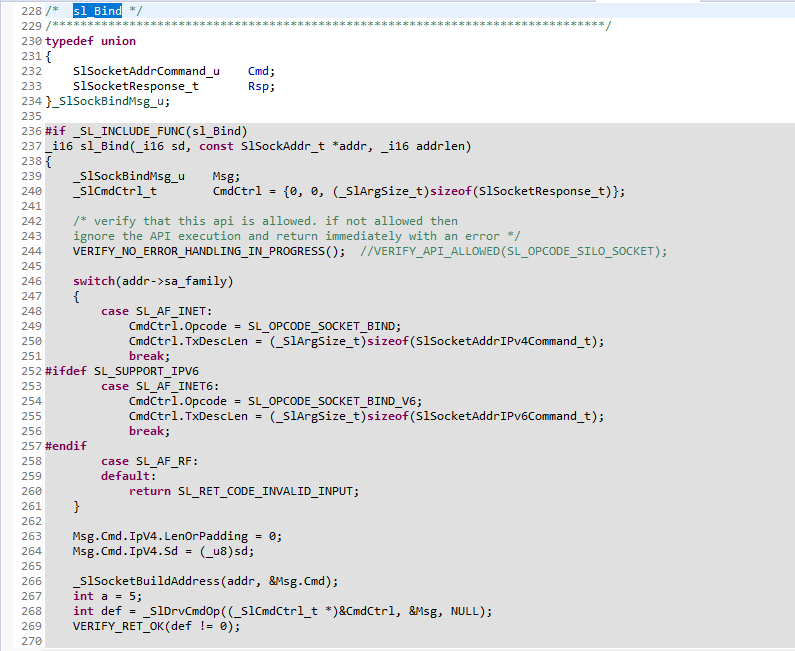

They can currently transfer video images via websocket with the CC3200. But they also want to use the 5 GHz band and have therefore decided to upgrade to CC3235SF. Unfortunately they have been trying to establish a websocket connection with this component for several months now without success. They use the SL_Socket.c library for this, but the sl_bind function does not seem to work properly with it. If they set up the HTTP_Server connection via port 80, the sl_bind function no longer allows this port for websocket. However, this is required for the Websocket protocol.

    If the binding for port 80 fails, they should check whether the internal HTTP server is enabled and disable it:
    sl_NetAppStop(SL_NETAPP_HTTP_SERVER_ID);

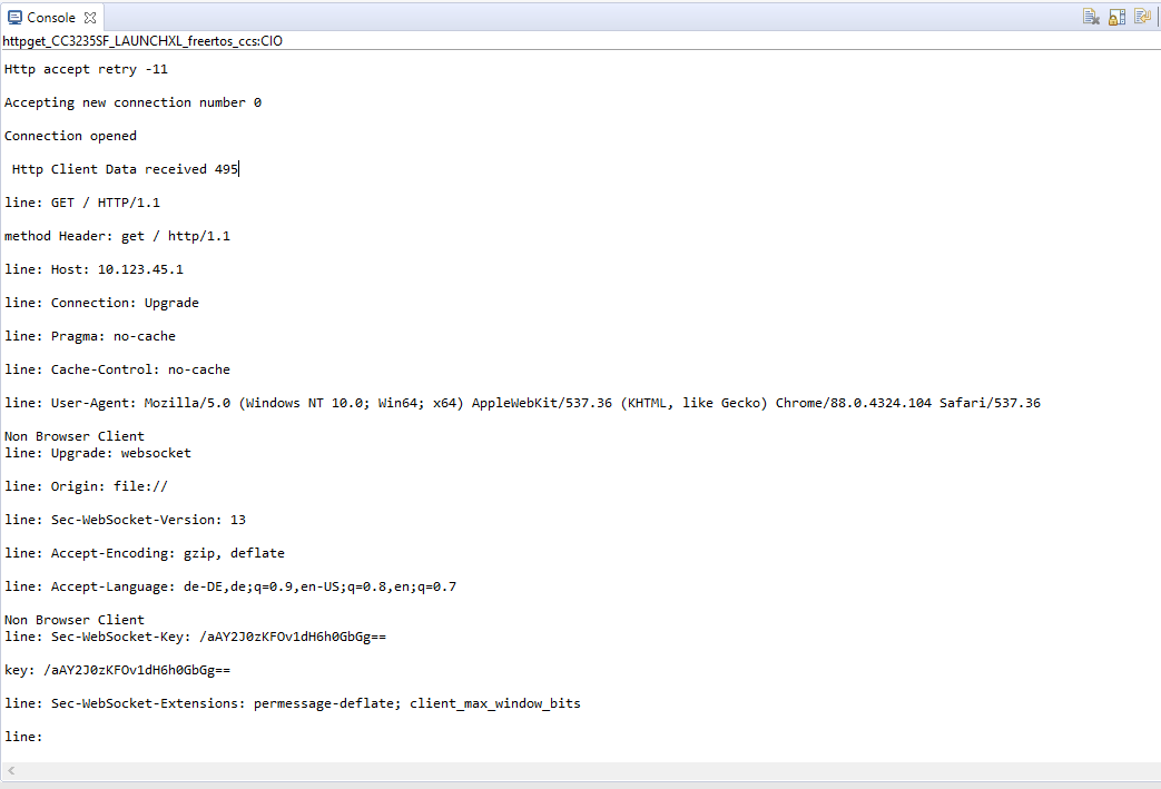

    After disabling internal HTTP server, sl_bind function is working and stuck at sl_accept which is returning an error value of -11 (which says HTTP accept retry)
    Below attached the console log of CCS when I try to connect with my HTML application.

  • -11 is SL_ERROR_BSD_EAGAIN (see simplelink/errors.h).
    It is a typical return code for non-blocking sockets. Instead of waiting (blocking) for the "sl_Accept" to return (when a clients connect) you'll need to reinvoke the sl_Accept until you get a valid socket id (>=0) or other error code.
    From the log it seems that eventually (i.e. in the 2nd attempt) the accept returned correctly.
    I'm not sure what do you mean by "I couldn't modify these library files" - it is just a source code and i assumed you've already updated it to enable it with the CC3235 SDK. You will need to update the code so it can compile and link to the CC3235 host driver.

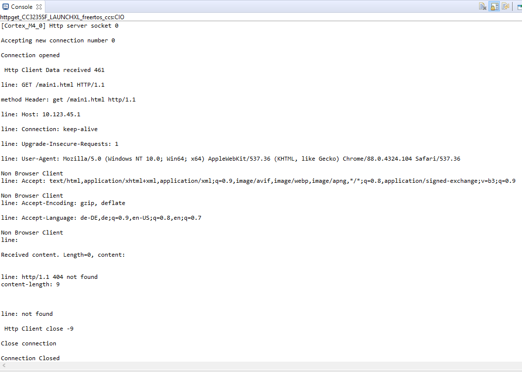

    Concerning the log, until I see my HTML app on browser it says 'HTTP accept retry -11'. Once I invoke HTML using IP address I see the following log.

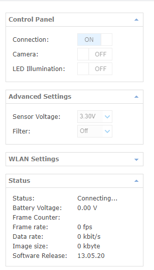

    And I try to have connection with my HTML which doesn't happen (below picture) - says connecting all the time.
  • The WebServer code (see RunHttpServer()) already calls sl_Accept (the sl_Accept is called within CreateTCPClientSocket() ) in a loop when it receives -11 (see SL_EAGAIN handling).
    I'm not sure what exactly is the current issue (it doesn't appear in the log) but it is accepting the client socket.
    You need to further debug the state of the webserver.

  • Hi Kobi,
    Current situation:
    This happens when Internal HTTP server is disabled hence couldn't load HTML application on browser. (I have also tried loading HTML file from PC to check the status which also ended up happening nothing)
    When enabled internal HTTP server, HTML is accessed on browser using IP address but there is no websocket connection.
    This problem wasn't an issue whilst using CC3200. As even though, internal HTTP server was disabled, I was successfully able to have websocket connection with my HTML page when loaded on browser.

  • -98 is SL_ERROR_BSD_EADDRINUSE (see simplelnk/errors.h).
    The internal HTTP server doesn't support WebSocket. You need to disable it in order to use port 80 by the host's WebServer.
    The WebServer lib does works with the FS and should be able to read file if it exist.
    I see that you are trying to access "/main1.html" - at least when using CC3220/35 you should avoid the leading "/" when accessing files in the root folder.
    You can set a breakpoint in the sl_FsOpen (called from HttpStatic_InitRequest)  and check what is the filename used and compare it to the path of the file in your file system.

  • Hi Kobi,
    Thank you for the information.
    As you suggested, it's not hitting the breakpoint in HttpStatic_InitRequest function where sl_FsOpen is called.
    On the console I see,
    Http server socket 0
    Accepting new connection number 0
    Connection opened
    Http Client close 0
    Close connection
    Also, Filename is '/main.html' with FsDir 'www'. It's the exact path provided in Uniflash as well. - changed with main1.html as well (same prob)

  • It seems that the connection was closed by the peer (Http Client Close 0), i.e. the sl_Recv returned with len == 0 which means that connection was closed (gracefully) by the peer. I'm not sure what was the reason. You may need to check with a sniffer log.
