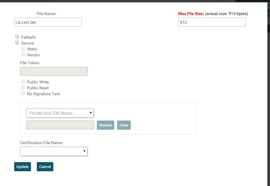

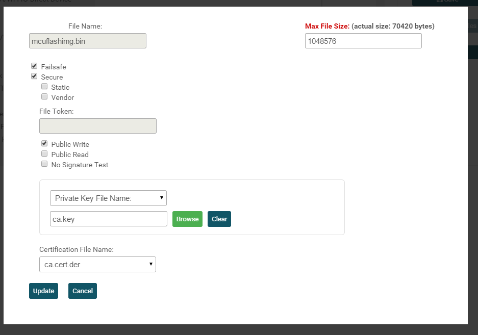

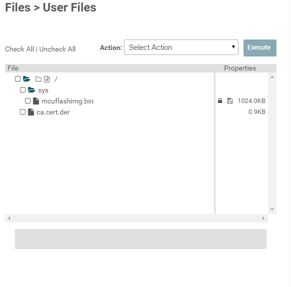

    that worked for me. In addtiion i had to change my key length from  openssl genrsa -des3 -out ca.key 4096 to openssl genrsa -des3 -out ca.key 2048 and for openssl genrsa -des3 -out vendor.key 4096 to for openssl genrsa -des3 -out vendor.key 2048.
    Now i am facing new problems while adding my own certificate chain to uniflash.
    Attached you will see my properties in uniflash. Because i don't know better i have used ca.cert.der as file for uniflash because palyground files also following that naming dummy-root-ca-cert which points to me it is the root ca.

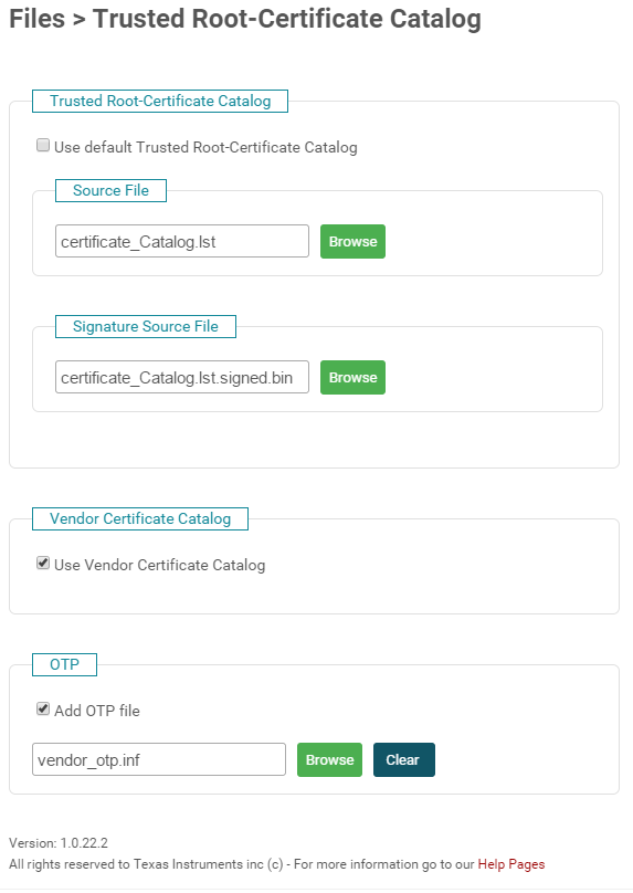

  • Hi Kobi,
    yeah that's right but i have changed it to 2048. See openssl genrsa -des3 -out ca.key 4096 to openssl genrsa -des3 -out ca.key 2048.
    And then i ran complete through the whole process again. But the failure with uniflash is left there. The source of the problem seems to be the file certificate_Catalog.lst.signed.bin which is in my case 512Bytes sized. Your Files provided from playground are 256Bytes sized.
    But i don't know what the problem is. I have no option to change what is coming out of SLImagecreator.exe.
    Here again my complete new chain based on 2048 Bytes keys:
