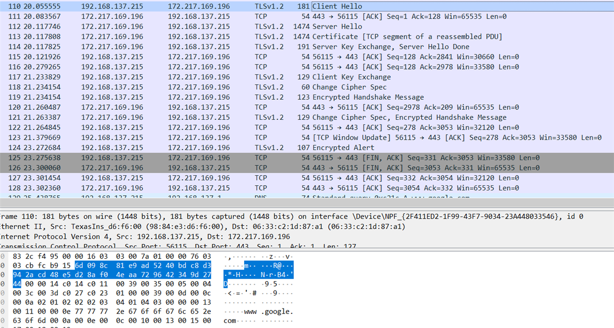

I am having CC3100 (SDK 1.3.0) connected over SPI to the host MCU (Arm M4). When I try to connect to any server over secure socket, it takes between 1 - 2 seconds. Release notes for the SDK 1.3.0 says that minimum tls/ssl connection time is 130 ms (for RSA) and 1.3s (for ECC). However, no matter what cipher is used, I am getting max 2 seconds for establishing tls connections (I have tested it on pure sockets and with httpcli library). Question: is this 1 - 2 seconds expected time for tls/ssl connection establishment or... can you point to some parameter, flag... that can be used for reducing this time?

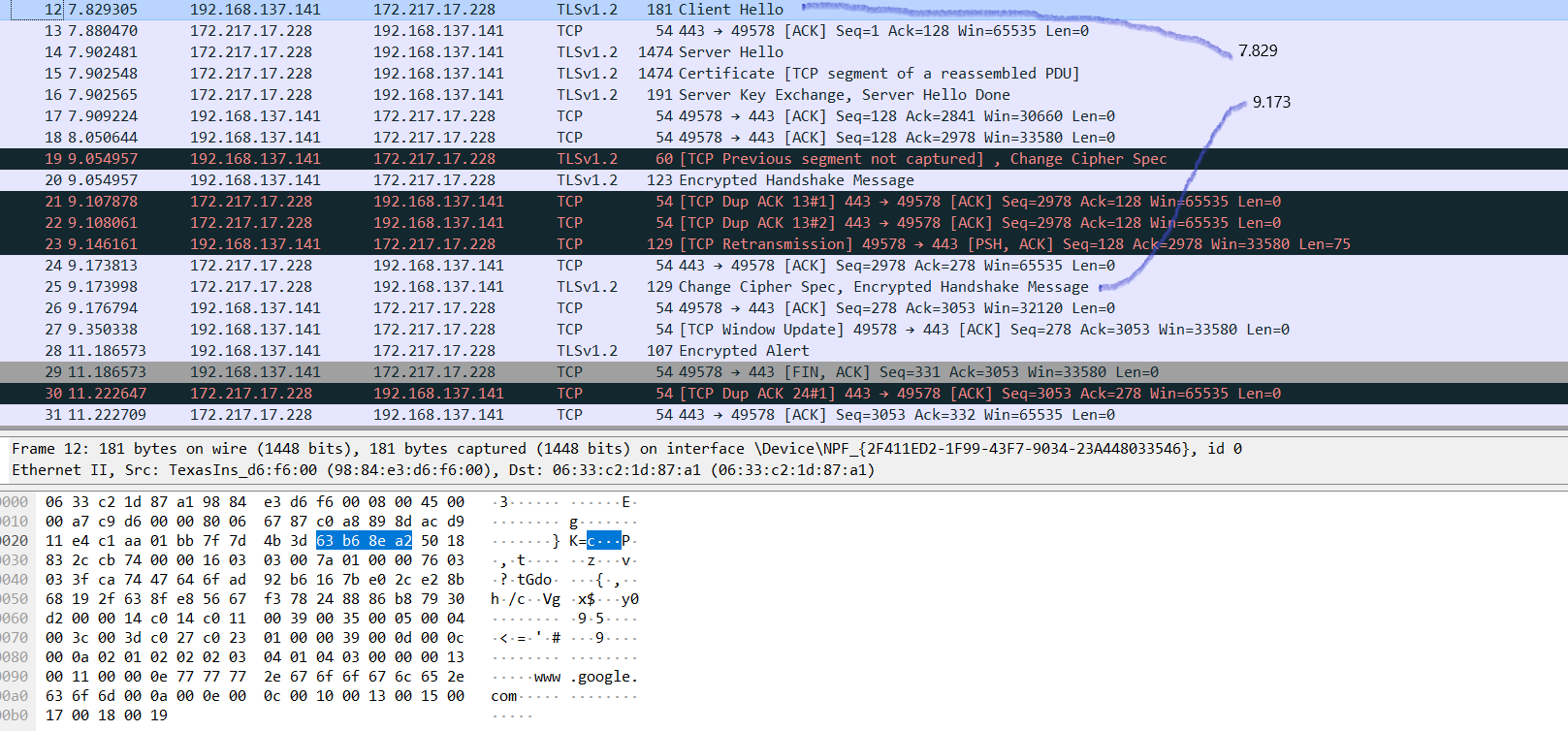

    I am attaching wireshark part for the https with google - appx 1.3 seconds taken for entire handshake. What is interesting is 1 sec taken for 18th packet. Do you see something from the wireshark that can be help me with connection time reduction?
    As for SP I am having the version 1.3.0.
    Aleks
  • Hi Aleks,
    You should check at server responses what cipher suite was was negotiated. Cumulative response time from sever side is around 180ms, from this reason  you cannot expect lower connection time. I think your issue is due to negotiated cipher suite or missing ServicePack inside device.
