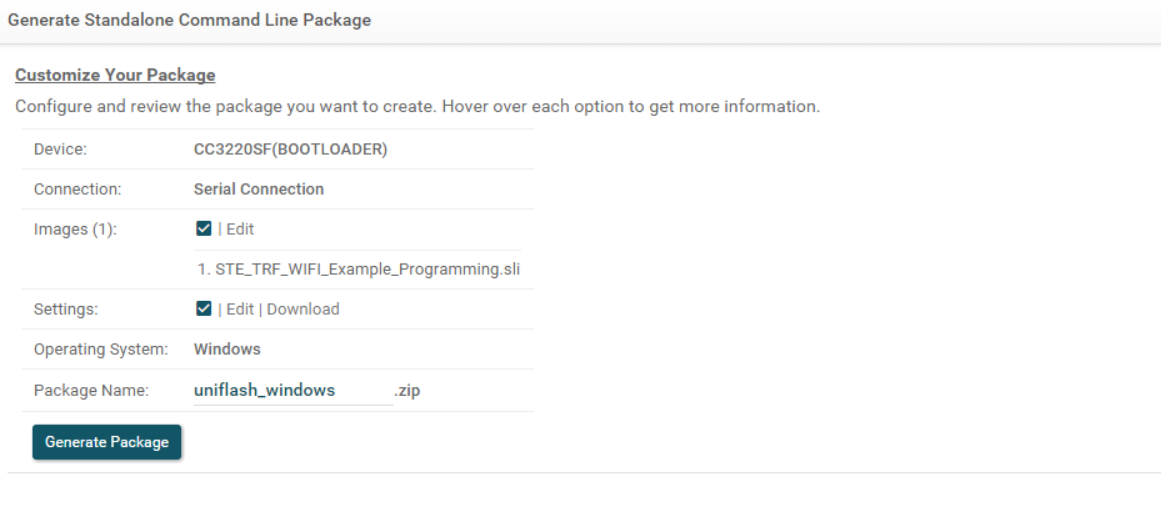

Hi there,
i have created uniflash Standalone Command Line through uniflash (Generate Standalone Command Line Package)
Running Programm through uniflash gui works. See

But if export Standalone Command Line and run dslite.bat it fails:
Below my settings:
Command line:
PS D:\ste_trf_wifi\uniflash_windows> .\one_time_setup.bat
PS D:\ste_trf_wifi\uniflash_windows> .\dslite.bat
Executing default command:
> dslite --mode serial -c user_files/configs/CC3220SF_BL.ccxml -l user_files/settings/generated.ufsettings -s VerifyAfterProgramLoad="No verification" -e -f "user_files/images/STE_TRF_WIFI_Example_Programming.sli,1"

Failed: Image loading failed: CreateProcess failed: Das System kann die angegebene Datei nicht finden.
Why does it fails ? If have checked sli file is present under:

  • Hi Arnaud,
    The standalone command line generation utility does not work with the CC3xxx devices, as the programming flow for those devices are more complex than simply flashing serial flash banks over JTAG. The CC3xxx programming process involves a separate tool, Imagecreator, which runs in a wrapper provided by Uniflash and uses UART functionality to communicate with the device bootloader to perform the flashing process.
    As a result, you will need to follow a different set of steps to flash your CC3220 through a command line. See the instructions at section 7 of the Imagecreator guide: https://www.ti.com/lit/swru469
    If you follow the steps in the guide, are you able to use the CLI to flash a project?
