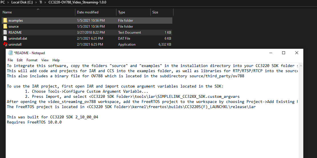

I have a LAUNCXL-CC3235SF development board and OV788 Adapter Booster Pack. The streaming demo was made with CC3220SDK and CC3220  LaunchPad. I'm selecting the servicepack from the servicepack-cc3235x folder then selecting MCU image as mentioned on the paper. Lastly, I already copied example & source files to according target folders.
But it doesn't work.
How can I run video streaming example with LAUNCHXL-CC3235SF. Thanks.

    One thing to note is that the SDK version that the demo was originally built with doesn't support the CC3235. So you will need to update the SDK to a version that does support the CC3235, or preferably the latest version of the SDK.
    Are you already building the OV788 demo code with the latest SDK, and if so what modifications did you make to the demo code to get it to build?

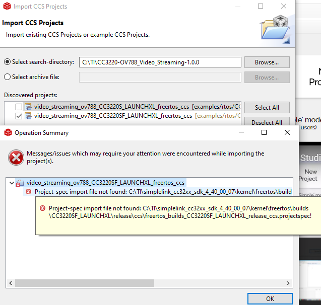

  • Hi Michael,
    The error is in below. I could not import yet.
    Jamper
  • Hi Jamper,
    The issue with the CCS import is that between the older SDK version and the latest SDK versions, the name of the FreeRTOS project has changed.
    If you open the .projectspec file at \examples\rtos\CC3220SF_LAUNCHXL\demos\video_streaming_ov788\freertos\ccs\video_streaming_ov788_CC3220SF_LAUNCHXL_freertos_ccs.projectspec in a text editor such as notepad, you can find and replace the following:
    Replace
    <import spec="${COM_TI_SIMPLELINK_CC32XX_SDK_INSTALL_DIR}/kernel/freertos/builds/CC3220S_LAUNCHXL/release/ccs/freertos_builds_CC3220S_LAUNCHXL_release_ccs.projectspec"/>
    With
    <import spec="${COM_TI_SIMPLELINK_CC32XX_SDK_INSTALL_DIR}/kernel/freertos/builds/cc32xx/release/ccs/freertos_builds_CC32xx_release_ccs.projectspec"/>
    Replace
    references="freertos_builds_CC3220S_LAUNCHXL_release_ccs"
    with
    references="freertos_builds_cc32xx_release_ccs"
    Replace
    -I${WORKSPACE_LOC}/freertos_builds_CC3220S_LAUNCHXL_release_ccs
    with
    -I${WORKSPACE_LOC}/freertos_builds_cc32xx_release_ccs
    Replace
    -l${WORKSPACE_LOC}/freertos_builds_CC3220S_LAUNCHXL_release_ccs/Debug/freertos_builds_CC3220S_LAUNCHXL_release_ccs.lib
    with
    -l${WORKSPACE_LOC}/freertos_builds_cc32xx_release_ccs/Debug/freertos_builds_cc32xx_release_ccs.lib
    That should get the project to at least import. From there, you will need to fix the various build errors that pop up, and adjust include paths/file locations as needed.
    Michael

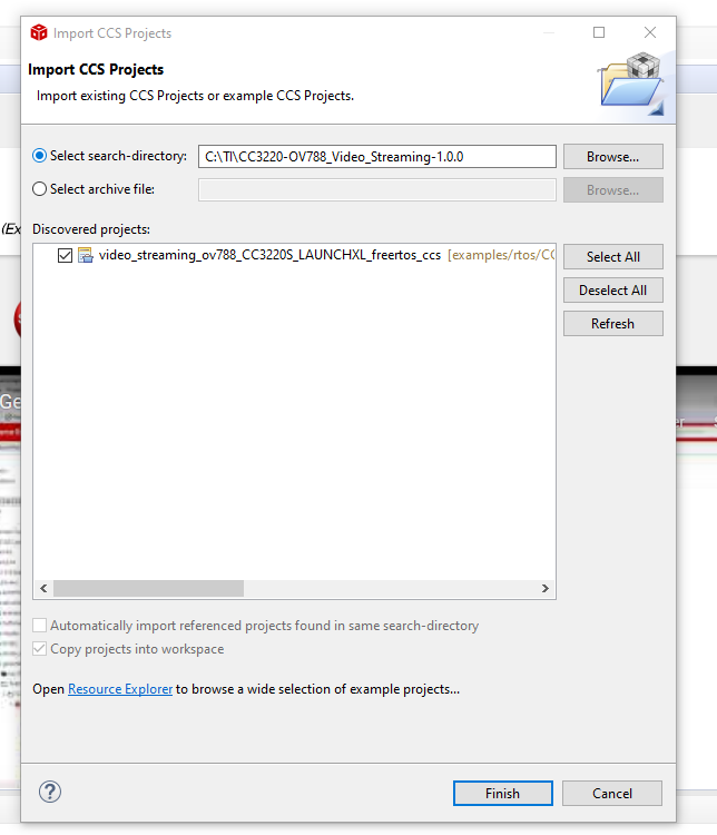

  • Hi Michael,
    When I've replaced old names with the new names, the current project file disappeared.
    Jamper
  • Hi Jamper,
    Not sure why those modifications caused the project to disappear from the import menu. You likely made a copy/paste error when performing the indicated modifications.
    Attached is my version of the video_streaming_ov788_CC3220SF_LAUNCHXL_freertos_ccs.projectspec file:
    /cfs-file/__key/communityserver-discussions-components-files/968/video_5F00_streaming_5F00_ov788_5F00_CC3220SF_5F00_LAUNCHXL_5F00_freertos_5F00_ccs.projectspec
    If you backup your current file, then replace it with my attached version, are you able to import it into your CCS workspace?
