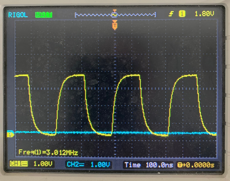

  • Hi Michael,
    This is a custom board, but very similar to the boosterpack.  SPI clock is 3 MHz.  MCLK is 40 MHz and ACLK is 32 KHz.  The waveform below is the SPI clock with a 1000 ohm series resistor.  Without the resistor there is a lot of overshoot which I assumed caused our early sync failures.   I started testing the SPI clock by constantly calling sl_DeviceGet(SL_DEVICE_GENERAL...) on 2 of our boards.  One with 1000 ohms and one with 100 ohms. The 100 ohm version still has about .7 volts of overshoot on the rising edge.  Any advice on this will be appreciated.
    Gary

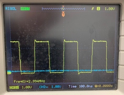

  • Hi Gary,
    For the SPI Clk, 1k seems to be a high value to help correct overshoot - Did you come to this value after doing some testing? My ask is to perform two tests and capture them on the Osciiloscope. One with a zero ohm so we can see the overshoot problem, and one with a 33 ohm resistor to see if that helps and also if it fixes your other issues.
    BR,
    VInce

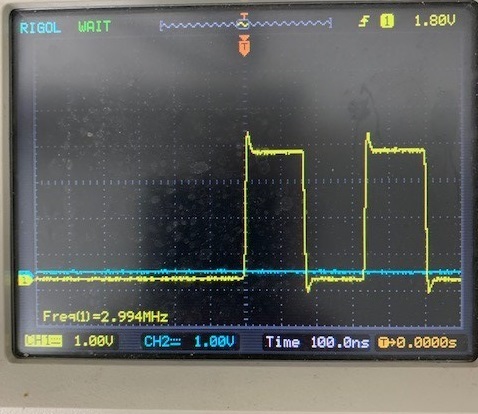

  • Here are two waveforms.  One with 100 ohms and one with 0 ohms.  At 330 ohms the overshoot is gone.  Yesterday, did some SPI stress testing at 100 ohms and 1000 ohms and nothing failed so this may not be an issue. Gary
  • Hi Gary,
    Looks like the issue is solved. Let us know if thats incorrect, or more issues come up!
