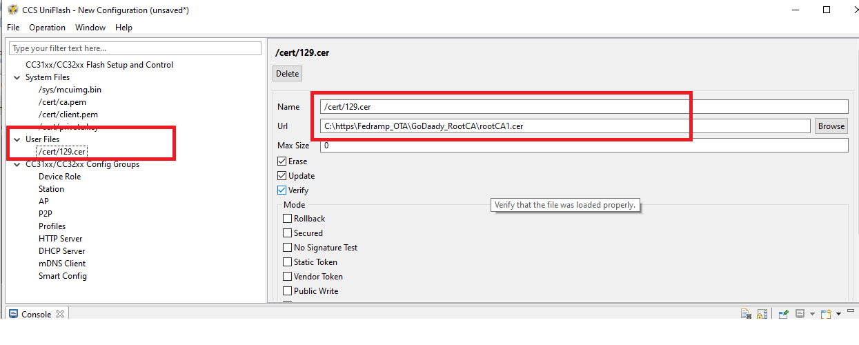

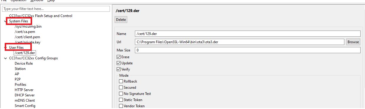

    Do I need to add the der file in the Users file or system file section in Uniflash? Please confirm
    Sundar
  • The certificate should be added as a user file.
    The code looks ok - i guess you are based on the "http client demo" which is a good reference.
