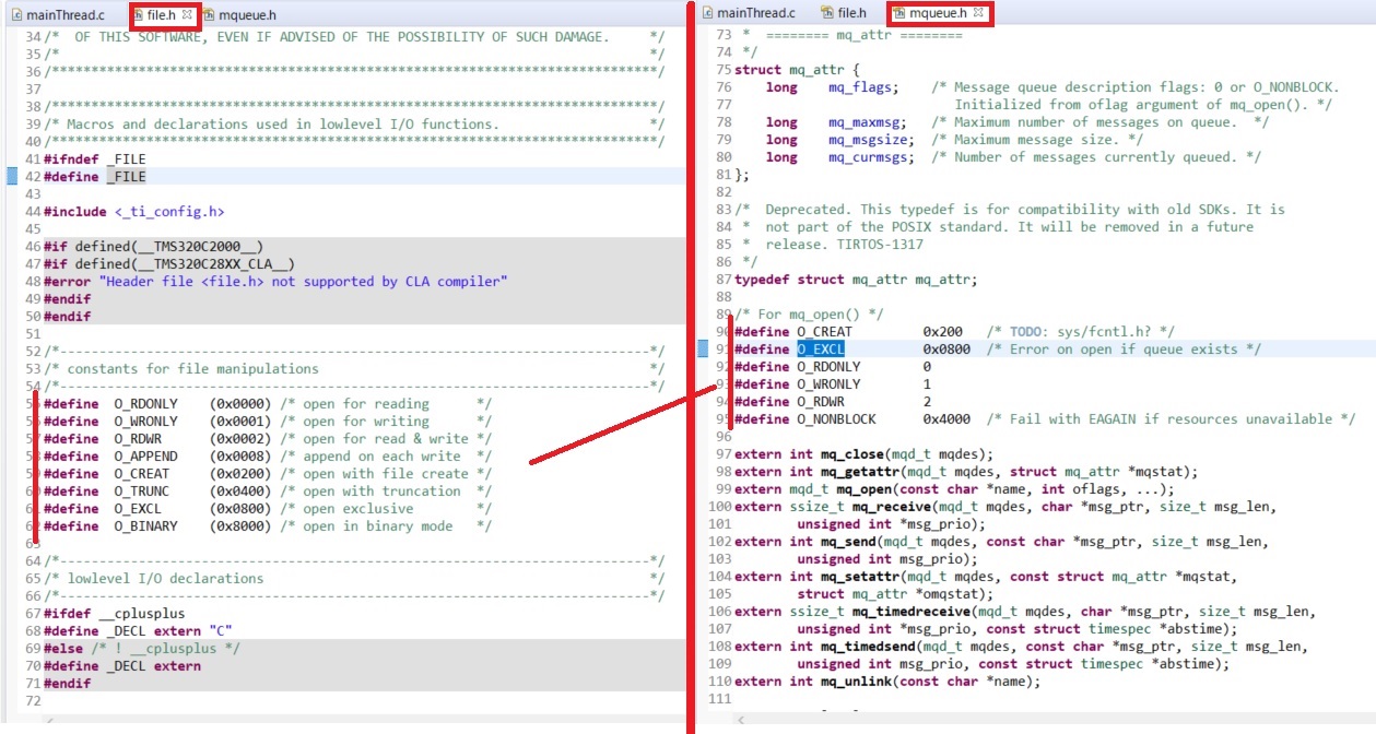

I wanted to report a problem with redefining macros in the "file.h" and "mqueue.h" headers.
The macros: O_RDONLY, O_WRONLY, O_RDWR, O_CREAT and O_EXCL are repeated.
I edited the mqueue.h file and added some protections to prevent redeclaration.
