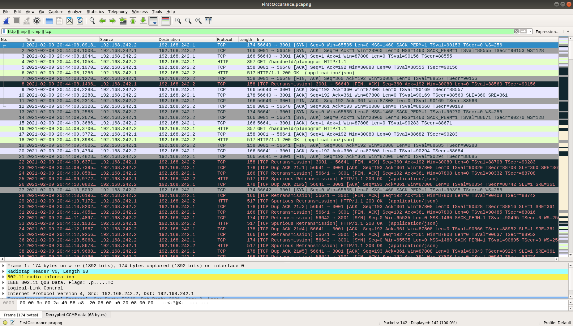

We have updated the AP firmware as suggested, but it didn't help.

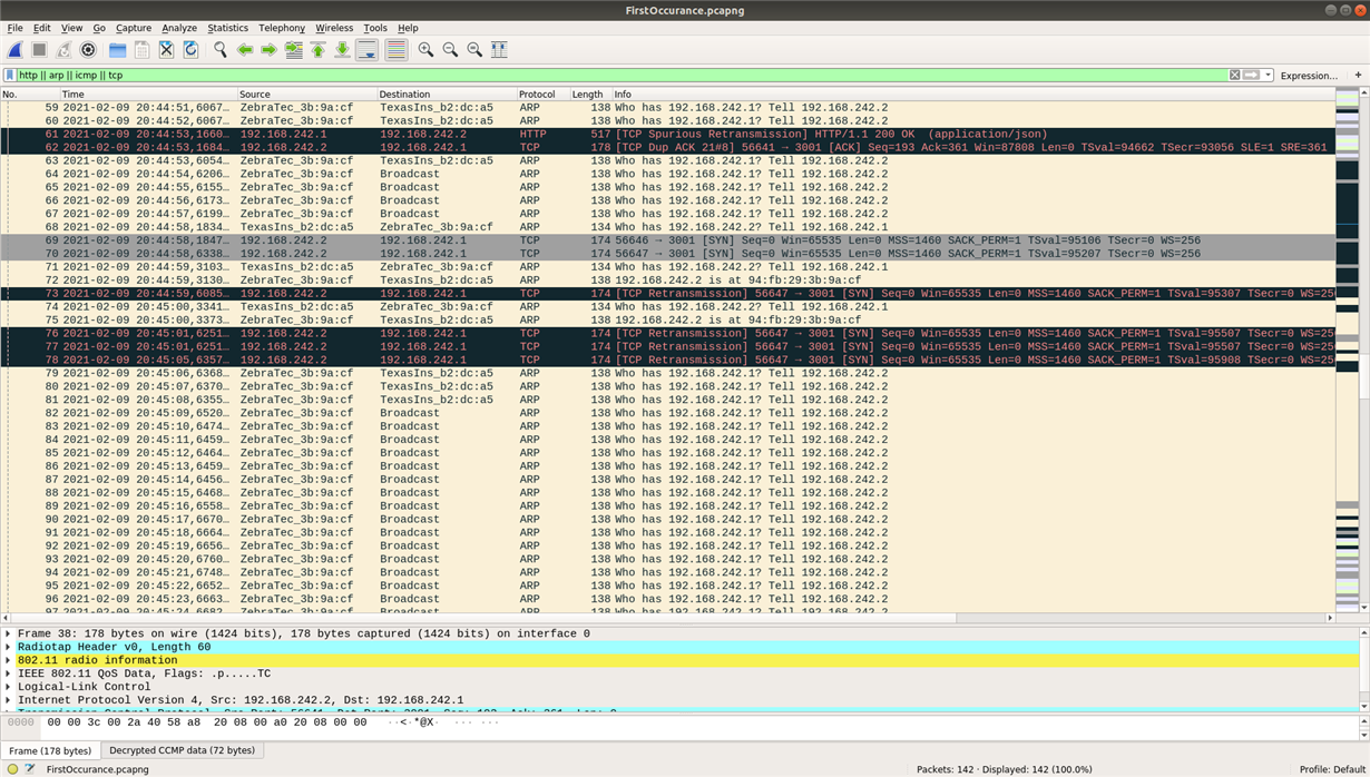

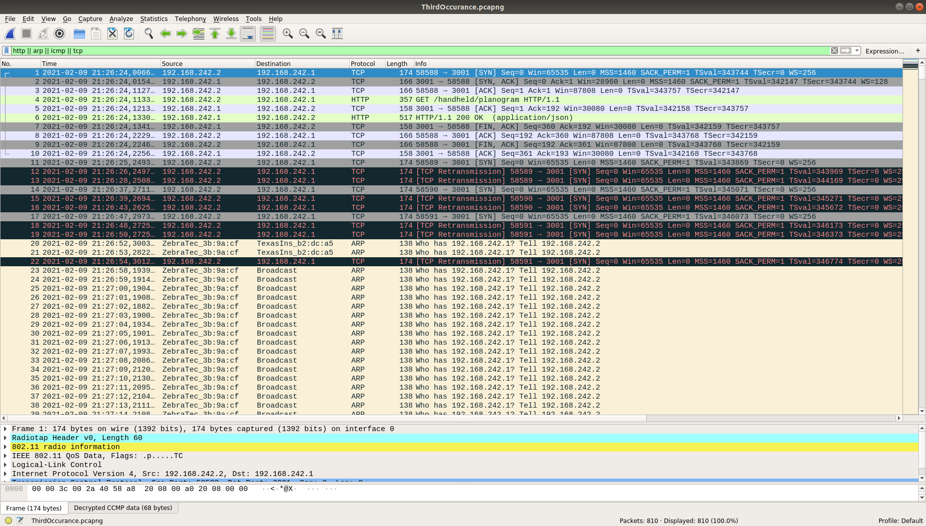

We see that the AP doesn't reply on ARP messages. Attach monitorMode logging files.
Here AP doesn't respond at all and it continues like this until restart of AP (With TI chip)
For FirstOccurance figures, it recovers....
Any suggestions?
  • And Error come back every 20 minutes....

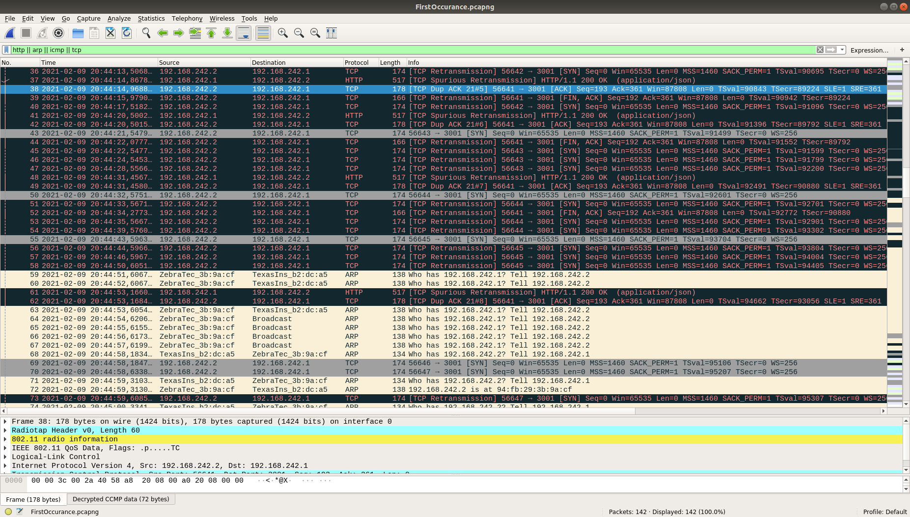

    With TC20 we always get stuck after a while, i.e. communication between TC20 and AU are not working. Re-transmissions are not handled => ARP messages send out from zebra, sometimes AU send out ARP request and communication starts again. Sometimes AU doesn't send out ARP request or doesn't respond on zebra ARP requests => not coming back.

    Ping also stop to work if it is running at the same time. Seems to work lite better if ping are run from AP -> Zebra (not included in attached pcapng file)
    AP works good if another Zebra with higher Android version (10) are used. The one that we see the problem in conjunction with the AP, does have android 8.1.0
    If both Zebra units TC20 - Android 8.1 and TC21 - Android 10 are run at the same time, against same AP, we get problem with ARP with zebra TC20 and TC21 are working fine. Only TC20 communication are attached in pcapng file.
    Attach link to monitor mode capture:
    files.elysics.se/.../z2ZWSSsriNsFdMk
    MonitorMode.pcapng - Logfile
    MonitorMode.txt - description of errors. Please look at error 3, here problem continue (ARP) until we reset AU/AP unit.

    Thanks for the logs!! Does the logs contain the traces from TC21 as well? Also i see the retransmissions initiated from higher layers. Need to check if there is something missing in TCP layer as well.
    The setup i have is doing pings in both directions from AP to STA and STA to AP. Both are running linux unlike the one in this case where STA is running Android. We will take a look into the logs again and see if there is anything abnormal. This may need a few days to complete.

    TC21 Android 10 are using something called Gratuious ARP, Android 8 didn't according to Zebra support. They think it's a problem with the AP because it isn't responding on ARP request from TC20.
